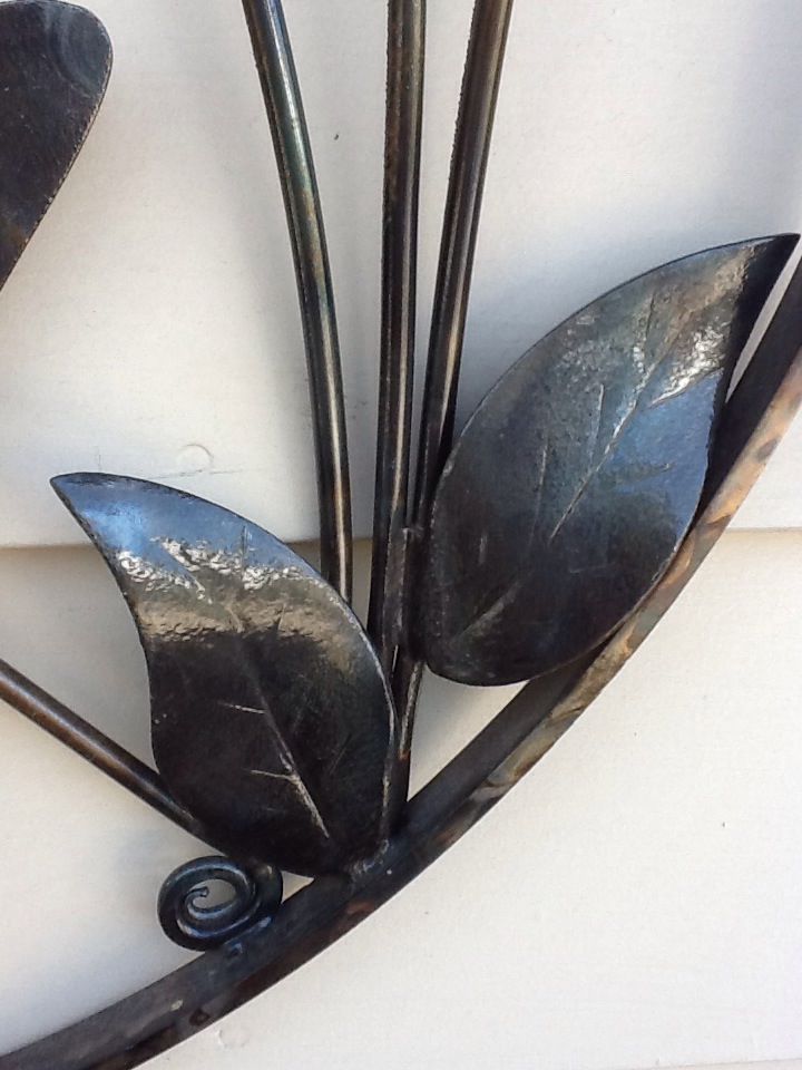

Heres a few things I've done, and am in the middle of. The mirror frame is mild steel forged sections welded together. It is not finished, kinda in a mock up stage at this point. Still need to add hangers to the back and color finish it.
A simple leaf also from mild steel. I've done several picture frames, I'll post some once I locate the pix.

Agree with everyone else.  Stunning work!  The texture you get in your finish is mesmerizing to me for some reason.  I just caught myself staring at the leaf for 5 minutes. LOL
Thanks. I use a needle scaler to create the texturing. I have several different ones, but the cheapie Harbor Freight air hammer slip on gives the best overall texture without being too harsh IMHO.  I do the distressing at about a cherry red heat. The needles also create a domed effect on the steel after a few heats. I have three trailer ball strikers I made that fit in the square holes in my table or in the hardie of my anvil. I use those to create larger relief areas, then use various scalers to draw the metal  and get the shape I want. I'll post up some pix of the stuff I use. If you got a scaler and a decent compressor, give it a shot. You can really do a lot of shaping and different textures with one after you get a little time with it.

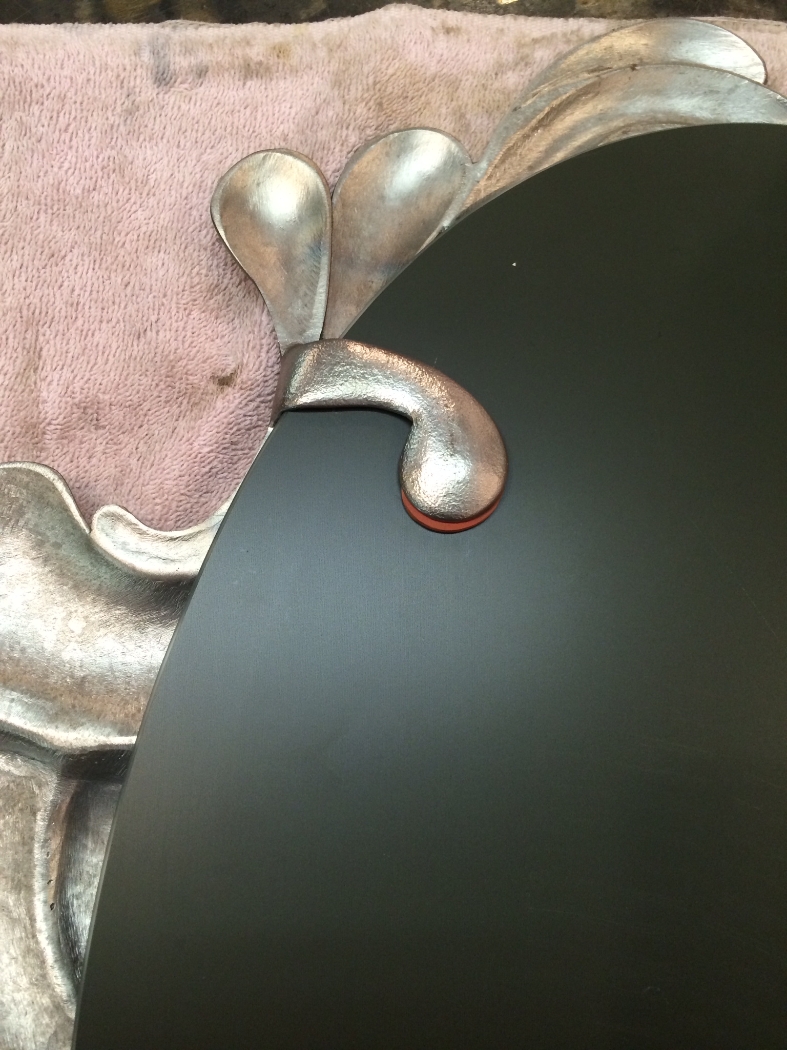

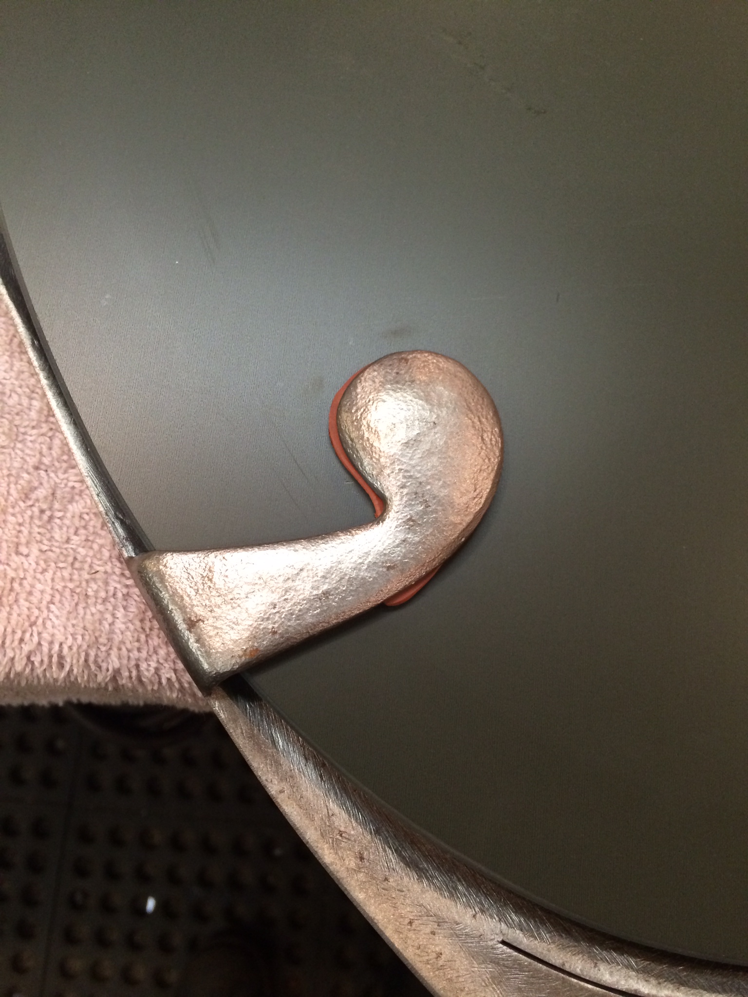

How are you going to fasten the mirror to the metal so they're joined firmly?  I still haven't come up with a way that I like.

Hey thanks. I'll take a pic of the back. Right now, I'm using two small pieces of rubber that fit into L shaped brackets I forged and welded to the back of the frame. They sandwich between the brackets and the back of the mirror. The brackets have a sort of musical note shape to them for lack of a better term. It's held in entirely by friction. It's quite sturdy, but I'm open to suggestions on a better way. The pix will explain better than I can right now. I'm on the road until tomorrow.

For those who asked, here's how I fit the mirror into the frame. These pieces of rubber firmly hold it into the brackets I attached to the back. So far, this is the best solution I've come up with. I can hold the mirror upside down by the frame and shake it and it doesn't move or fall out. Of course, I did this over a padded surface.... ^_^
But anyways, I have to add the hanger for it, then I'll finish up the coloring on it before clear coat. That's the plan anyways.

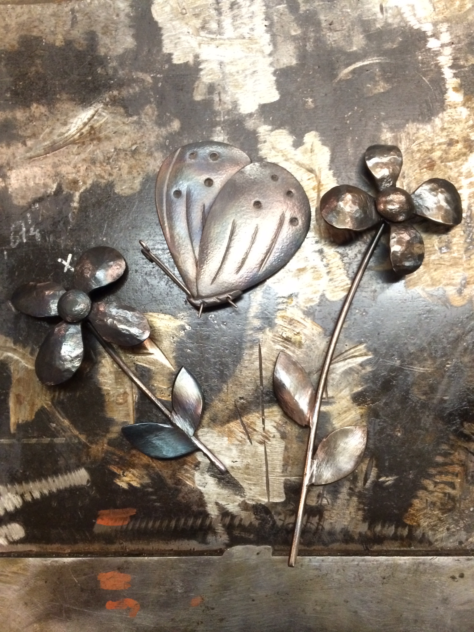

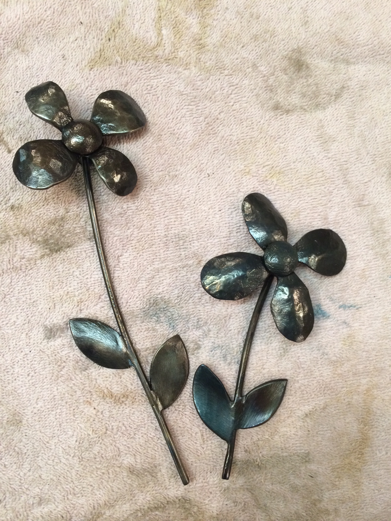

Here's a couple flowers I made several years ago. I hammered the detail on the petals, obviously not shooting for realisim here. They were actually going to be part of a montage for my now ex wife. I did weld two of the original four flowers I had to a stand and gave them to a former boss I had who I thought a lot of. She was a neat lady.
The butterfly was a reproduction of a drawing my ex wife gave to me when we were dating. I tore the drawing up, but couldn't bring myself to toss the metal piece lol. They are all heat colored and oil finished.

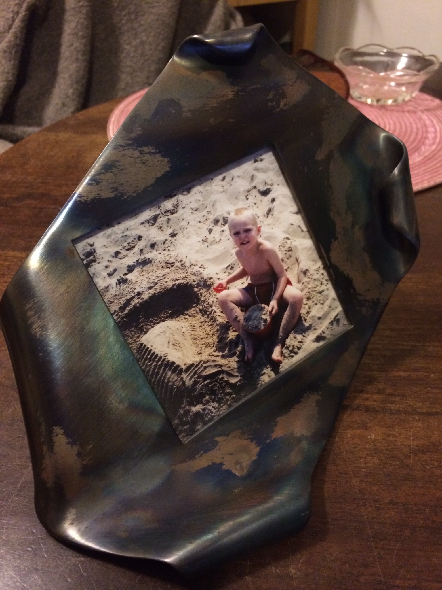

Thought I would add a couple picture frames I made. The pics aren't the best, I had more of them and I made a mistake last year and wiped out over 10K posts and all my pics off WW while using decimator to ban a spammer.
Oh well.
Anyways, Heres a couple frames I made.
The first one I made for some friends of my moms. Their only son was heavily involved in coaching girls softball, hence the home plate shape and hanging whistle. Unfortunately, he took his own life after a bitter divorce. He had two teenage daughters he left behind. I did it for $100 and wouldn't take a penny more. His mom and dad cried when I gave it to them. I did too.
The second one I did originally for my now ex wife, but I took it back shortly after our separation. It was an anniversary gift with a pic of her and I when we were first dating.
Put a pic of my son in it. He was like four at the time. Both are mild steel and made from scrap. I heat colored both of them, but never applied a protective coating to the second one and it tarnished. The effect ended up looking kind of cool, dunno if I'll refinish it or not. I used an automotive grade clear coat on the home plate frame.
The base the home plate frame is attached to is the same style construction as the "scroll edged" frame. I used a pair of vise grip needle nose pliers to twist the scrolls while hot. After I finished the general shape, I metal finished it with an angle grinder and non woven abrasive wheels on my buffer. The home plate frame is welded together from several pieces, then attached to the base by TIG welding.
Both of the Windows for the pictures were cut by hand with a cutoff wheel, and hand finished with a file. Nothing was cut with any CNC equipment.
