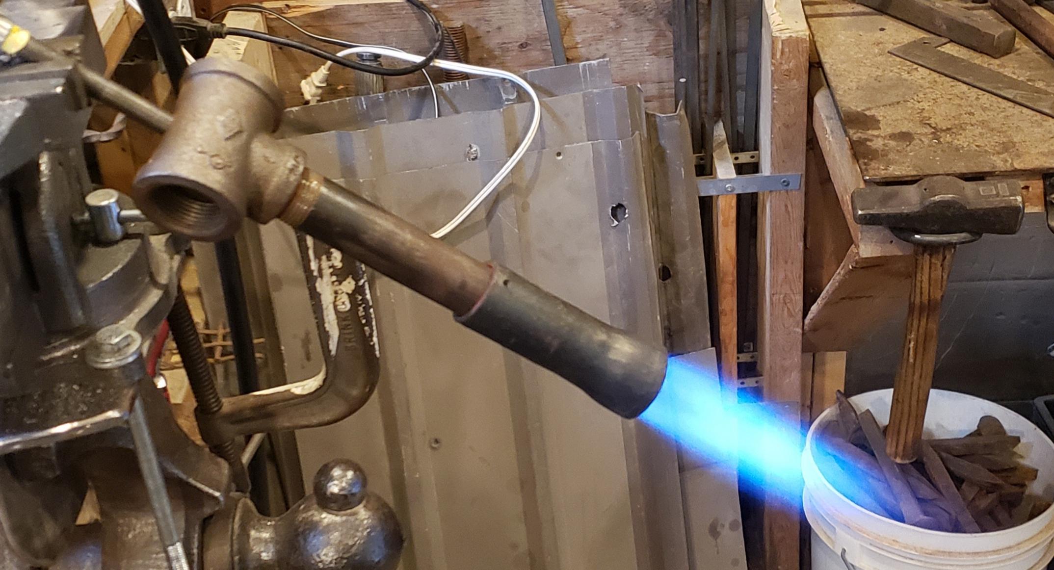

Trevor84 Posted May 16, 2020 Share Posted May 16, 2020 I had a little breakthrough yesterday when I was tinkering. Now this may be documented already but I found that you can cut threads on the outside of the 1/8" sch 80 nipple using a 7/16" 20nf I think it was. Also you can drill and tap the 1/8" fittings with the 7/16 20nf this way you don't need set screws you can screw in and out to tune as long as you got everything straight. And in some designs like a Mikey, Oliver, straight straight tube burner you may be able to stream line a bit with let's say the 3/4" steel, straight sided coupler/thread protector then a 3/4"-1/8" bushing tapped for 7/16" nf..... May be a scooch more streamlined without having to turn/grind anything down....... In this case I tapped the T and I was able to clamp the 1/8" nipple in the vise and just screw the burner up and down. However there's not much meat in the wall of the T so I may tap the T for a bushing then tap it then and also use a jam nut to lock in the orifice depth once I find the sweet spot. This is temporary flare for now, it's a bit larger than the 1:12 so it holds the flame a bit too deep. This burner as is currently: 1/8" nipple 0.030 contact tip 1",3/4",1" T 3/4"x7" mixing tube Flared out to 1 1/2" with a 1 3/4" over hang. This is still in the testing phase, I already know that some of my ratios are random in this build but I was just tinkering and had limited fittings (need to hit up the plumbing store) I'll update in a few days when I get a chance to get back in the shop and take a few progress pics. Thanks for copying the vorticle flow write up forward Mike it makes it nice and easy to find...... You have it explained in a way that's fairly easy to visualize. Quote Link to comment Share on other sites More sharing options...
Frosty Posted May 16, 2020 Share Posted May 16, 2020 If you use a lock nut the jet won't wiggle in the T. Just snug it when the jets where you want it if you put too much torque on the wrench you'll strip the threads in the T. Flame looks pretty good but that'll change when you put it in the forge. Frosty The Lucky. Quote Link to comment Share on other sites More sharing options...
Trevor84 Posted May 16, 2020 Share Posted May 16, 2020 Thanks, in the forge tests will be coming in a couple days This is hard to describe but I'm wondering if there is a type of adjustable nut thingy that could be fixed to the T but have a nut that turns freely so that the burner and the jet can stay stationary but turning the nut would just adjust the jet in and out. I think I've seen something like that before but can't think of where or what it would be called......? Any ideas, does that make sense? I guess kinda like the screw in a crescent wrench but a female version... Quote Link to comment Share on other sites More sharing options...
