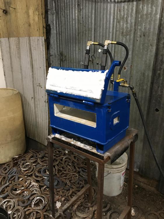

  1. Hi there folks, is there a product that acts both as a rigidizer and adds some small amount of protection to ceramic blanket? I am just finishing up a prototype forge for the Farrier industry. As these forges are portable, the ceramic board insulation takes a beating as we drive down the roads, especially if the forge is in a trailer. Some have found their forge liners breaking down in less than 6 months. There is a need for another solution. I have designed a forge that will use only blanket insulation for the walls and roof (sort of a mailbox design). We will see if they can take the banging down the road any better. I have read until my head is swimming about the different ways to coat this stuff. Most of these forges will be run at relatively low temperatures most of the time. But I am making these commercially available, so want to seal the fibers for safety, and if I can get a bit more life out of the blanket that is a bonus.

  13. Question: What are some of the basic factors that affect how quickly a forge comes up to temperature? Background: I’ve been running two prototype forges for about 6 months now. I found that high temperature firebrick takes FOREVER to get up to temp, even though it’s only 1.25” that I had lining the floor over refractory. I replaced with high alumina kiln shelf, and that has been much better. I have two Mikey burners powering these forges. The heat is concentrated, and does eventually spread out, and get very hot, but it does take longer than a traditional Venturi burner to come up to temp.

  18. Frosty: maybe I had some bad info. I thought I read somewhere that your mixing tubes were like 1.5 times a mikey or something like that. I'll rethink my options That's a good thought. I had hoped I would get some of that effect at the front end of the forge with the door closed, but you are correct, the exhaust draft does seem to pull everything out the side before that happens. I may have to go out tonight and flip the lid tonight, mount it backwards, and see what happens! If I do that, do you think there will be any problems with a high pressure area in the back of the forge creating back pressure? What I mean is, will it be hard to vent the exhaust because new incoming gas is going the opposite direction? (New gas is travelling towards the back of the forge, while exhaust gas needs to travel towards the front of the forge to go out the exhaust vents).

  20. Hey guys, thanks for the help. 671jungle, these are farrier forges, and a rectangle makes a lot of sense because for the most part we are putting flat shoes in. On top of that, it allows the use of board instead of soft fiber insulation, which for a production run is far less labor involved in setting up, applying, and slow curing coatings for said fiber blanket insulation. This forge design will actually allow for 2.5"-4.0" of vertical space inside, depending what combination of insulation/hard facing is used. I thought i'd start with less vertical height to see what I could do in terms of maximizing efficiency. Obviously all the parts need to fit together, so I will have to sacrifice a small amount of efficiency to gain some by having burners that actually function. Having the full height get's over 350 cubic inches, hence the need for two 3/4" burners. The turndown range is great, so they can just tick over while on the road doing farrier work, but in a competition setting where every second counts, I would like to be at the absolute maximum I can be in terms of burner capacity. This may still be too much burner, but we'll see, I'll enlarge the inside and then we'll see what's what! The burners are set towards the back of the forge, and aimed at a 15 degree angle to just behind the center of the floor in the middle of the chamber. And I know you guys LOVE pictures, so here are a few for you
