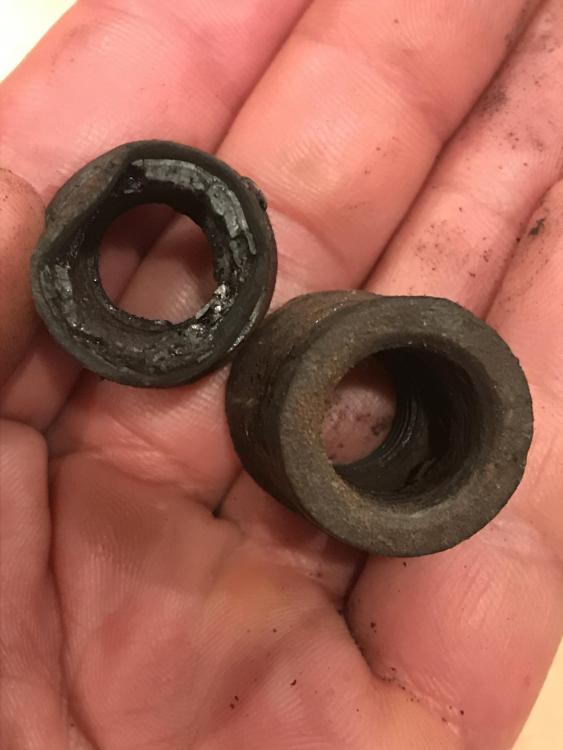

671jungle Posted September 3, 2020 Share Posted September 3, 2020 As I suspected the scale on the nozzle expanded the I.D. Causing the flame to lift. I tried to drill it out to a operatable (<is that even a word) size for a small improvement but not enough. One seriously needed changing anyway so I sprayed the nozzles with some rust loose stuff and twisted’em off but I also warped one of the little 1/4” mix tubes. So I went to the local plumbing supply and got a couple 1/4” couplings that I have been using as nozzles and pipe to replace the one I warped. Got home and realized I had bought the wrong length of pipe. Tomorrow I will trade them in for the proper length. But I am pretty sure the problem is the nozzle was all scaled up, almost to the same I.D. as the mix tube. I will take the time to make a more detailed build plan for anyone interested in smaller burners when constructing tomorrow. you can tell which burner was running lean. One of the nozzles is just pinched from the vice trying to get it off the mix tube. Oh and I meant contracted the I.D. causing the flame to lift, not expanded. Quote Link to comment Share on other sites More sharing options...

671jungle Posted September 4, 2020 Share Posted September 4, 2020 Thanks for the input everyone! I did not get any pics, but I changed out the nozzles on the existing tubes and it ran much better than in the previous video. The warp in the tube is still effecting performance to a very noticeable degree compared to when they were first built. Also the angle the burners come in still need adjusting. Today I will try to make the time and put another one together from scratch and document. I believe I made a mistake several months ago stating I used 6" long mix tubes when it should have been 5" lengths. My apologies to anyone who followed those instructions. One could have made the jet longer to meet the intakes but I think the extra drag in such small EDM tubes would result in malfunction. Quote Link to comment Share on other sites More sharing options...
