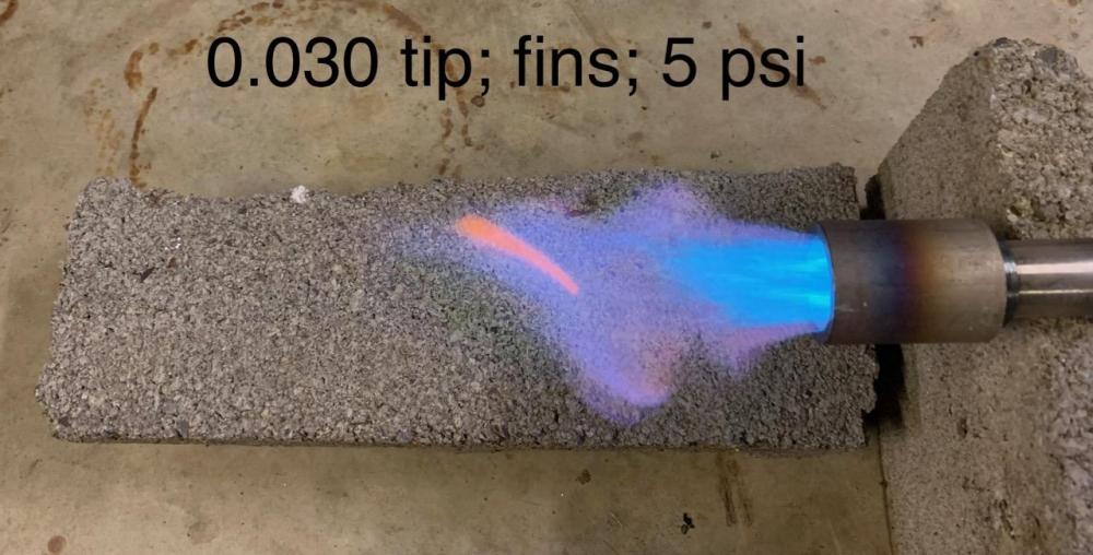

jwmelvin Posted April 13, 2019 Share Posted April 13, 2019 22 hours ago, Another FrankenBurner said: No problem jwmelvin. Report back whatever you are building over there. I enjoy seeing everyone's burners. I made the first flame today. I have been thinking a bit on the 3d-printed bellmouth and came up with something I wanted to try, so I have that on the end of the thin 316 tube (12" long, 0.93" ID). I have a 0.030" MIG tip in a brass tube (threaded the end) that I'm just holding in the mouth of the possibly-vortex-generating inlet. And for a nozzle I grabbed a piece of pipe that is 1.375" ID and extends past the end of the mixing tube about 1.75". It was hastily assembled just to see if it would sustain a flame. I'll be building a frame to hold the propane nozzle centered in the right place, and I will make a flame nozzle. Here are some pictures at about 7psi (I believe the flame was about the same but the lighting changed between the two flame pics): Quote Link to comment Share on other sites More sharing options...

jwmelvin Posted April 13, 2019 Share Posted April 13, 2019 6 hours ago, Another FrankenBurner said: I expect your blades are acting as paddles which hinder vortical flow more then help it. Every time I have tried to force anything to happen, it reduced induction volume and usually reduced vortex strength. You would have to print a model without them and test them both with smoke to see for sure. Hopefully I am wrong. That’s a good point, thanks. I do need a control. Especially since this is my first burner. Quote Link to comment Share on other sites More sharing options...
Mikey98118 Posted April 13, 2019 Author Share Posted April 13, 2019 Let's not throw out the baby with the bath water. That is a pretty nice flame coming out of a burner running sans flame retention nozzle out in the open air; obviously, something important is going on here! Quote Link to comment Share on other sites More sharing options...
jwmelvin Posted April 13, 2019 Share Posted April 13, 2019 1 hour ago, Mikey98118 said: Let's not throw out the baby with the bath water. That is a pretty nice flame coming out of a burner running sans flame retention nozzle out in the open air; obviously, something important is going on here! That’s encouraging, thanks. It does have a nozzle (blew itself out without one) it’s just that the pipe I used for a nozzle is so long it swallowed the whole mixing tube. I’ll try to fashion a proper, adjustable flame nozzle and fixture the accelerator. I do have another inducer styled more like AFB’s to try too. Also: what is the downside to a mixing tube that is too long ? Quote Link to comment Share on other sites More sharing options...
Another FrankenBurner Posted April 13, 2019 Share Posted April 13, 2019 I look forward to seeing more. Extra mix tube length adds drag which could result in less air induction. It may mix better if that is needed. It can also result in a more laminar flow for a longer more pencil like flame which can be good for certain uses. Longer in a forge is not generally desired. I tried an 18 inch mix tube just to see an extreme. It produced a rich flame which was longer then a foot. Too short and you deal with poor mixing and a bushy turbulent loud flame. Quote Link to comment Share on other sites More sharing options...

jwmelvin Posted April 14, 2019 Share Posted April 14, 2019 I made a real nozzle for my burner; it is stainless with the following dimensions: 1.224" ID; 1.375" length; step transition from 0.930" ID mixing tube that is 12" long. (That's a ~32% diameter expansion, or 73% area expansion; a half angle of 6.1 deg from the step to end of the nozzle ID.) I tested three configurations for the inducer: vanes, no vanes (plain bellmouth matching the shape of the vanes bellmouth), and fins (circumferential fins on the perimeter of the bellmouth, with a rear cone holding the accelerator): I tested each, starting with a 0.030 MIG tip (not the tapered kind). The vanes made the flame more stable but I think that's because the plain (no vanes) inducer was flowing faster. I did not experiment with the nozzle extension at all, but that also could help stabilize the plain inducer. I tried a 0.035 MIG tip on the accelerator as all of the flames seemed to be pretty lean (I could make them change by choking the inducer with my hand), but I'm pretty sure that the 0.035 tip was too big. The finned inducer ran a lot richer than the other two so I didn't spend much time with it. One thing I did notice was that the bellmouth inducers were not very sensitive to axial position of the accelerator nozzle. I do plan to taper the accelerator nozzle just for any bit of efficiency it can give. And i will make a frame that holds the accelerator in position. I'll put the pictures below and a video at the end; I appreciate any thoughts you may have on what aspects to try next. 5 psi 10 psi Thanks, -jason Quote Link to comment Share on other sites More sharing options...
