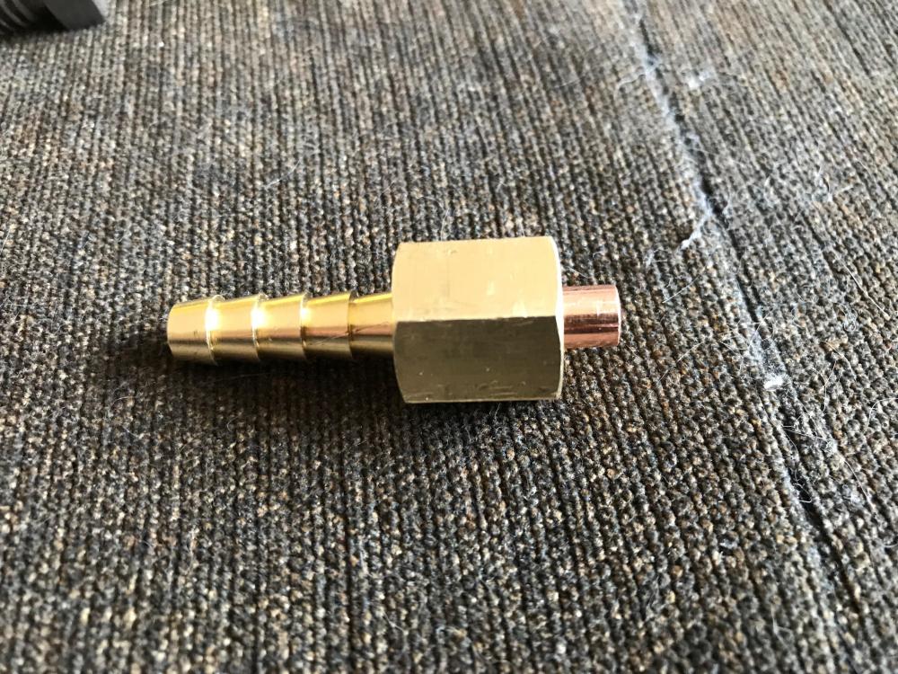

What did you use for a forge shell? Do you want to describe how you choose to construct your burners? All your would-be imitators will want too know how to get such good results :D
im back, life got heavy for a bit.
The shell: 1 gallon mini keg with a half circle cut out of one side, the other end had a 1 1/2" hole where the tap was. I placed the burner ports towards the back (for max swirl) and lined up with the corner of the half circle. Instead of drilling the ports, I cut flaps that I can anchor the small 1/4" burners to. I then lined this small sun with 2 inches of wool on the roof and filled the bottom with wool scraps and topped with a blanky. Made a fumed silica+water bath and soaked/drained everything. used one 1/4" burner to rigidize. Then coated inside with kasto 30.
The burner jet: .025 mig tip with thread turned down enough to be pressed into a 1/4" female hose barb. the mig can then be fitted with an EDM tube. I used .015 orifice for my 1/4" burner.
The mix tube: 6" x 1/4" pipe with 3 holes measured 4" from one end. (when drilling, try to angle holes toward the flame end.) start with  smaller holes than you would think and enlargen from there, always clean burrs and check flame after every adjustment.
The nozzle: 1/4" coupling with threads cleaned out of one side. this too must be tuned by checking on the flame after every scoring.
NOTES: I tuned the system rich by ENLARGING INTAKE SIZE FIRST with raw coupling attached. Once i got the flame to stay on the end, I cleaned out the threads in the coupling causing the flame to lean out and allowing the psi to be turned up.
Also the hoses have been changed to proper propane hoses.
the stand is just a base of some sort with square tubing for the neck. the tube is split at the top and splayed out to accommodate the forge shell. It is just wired together.
Thanks for taking time to clue in your imitators, 671 jungle :)
I especially like your use of the brass barbed hose fitting to simplify small burner construction.
