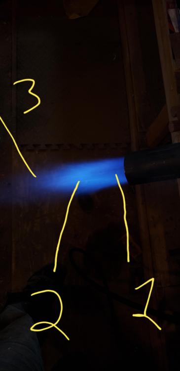

I want to thank all who have contributed to this thread. I haven't read in full past 2016 yet but I have used that info to come up with this and think I've got it diald in pretty good and I'm kinda hoping for confirmation/advice.(Hopefully it may kinda count as contribution too)
2"-3/4" bell, 3/4"/8" mixing tube, 1"spacer, 1 1/4" nozzle (apx 1 3/8" I'd at opening) 1 1/2" overhang, 1/8"brass T, 0.035 tweeco apx3/8" above throat.
First pic is around 12psi the next 3 are 1, 15, 30psi it holds steady the whole way through. I think this is a neutral flame 20190627_164841.thumb.jpg.dd40ff1762b32c246ab95dd2c0dc6e21.jpg, it has a faint hint of propane coming off the flame itself though but I think Mikey mentioned somewhere that's a good burn...? The flame doesn't get much longer through out the range but does get louder and alot hotter.

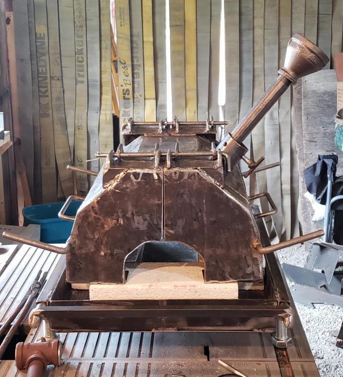

It'll be going in this forge once my insulation arrives. (I'll try and make a thread for the whole build once I'm done.)

Seriously, that's not a bad looking burner flame the mixing tube is too long though. The rule of thumb regarding the better mixing tube length is. L= 8 x tube Inside Diameter, ID. right? So, what does 8 x 3/4" equal? If you didn't learn to multiply by fractions like I had to, try: 8" x .75" =
That'll give you the better mixing tube length. Put the calipers away it doesn't need to be exact.
How many cubic inches will it be heating? You'll want to lose the fire brick unless it's "Morgan Thermal Ceramics K-26 insulating fire brick. Hard fire brick is a large heat sink and does't insulate much better than an equal thickness of limestone. It'll take your forge longer to heat up and take more fuel to keep hot.

They're Ifb 2600f for the floor the body will be 2" wool with kastolite. I'm planning on gaining the bricks a coat of kastolite. 330ish ci interior on the rare occasion I'll be able to set the top on a wall of bricks. (will loose welding heat) I may add a jack/crane kinda like your shop forge just cuz.

Don't be too worried about it.  Your flame looks good.  If you see any green in the flame, play with nozzle overhang.  I like the overhang to be just enough to hold the flame at the maximum pressure I will use.  If you still have green in your flame after tinkering with the nozzle, start to cut small lengths off the mix tube.  Pay attention to the color of the flame and pay attention to the secondary flame.  If the color goes greener or the secondary flame looks to be increasing in size with the cuts, stop cutting.
Or do none of this and be happy with the flame you have.  It is a nice flame.  Nice job.
Thank you. No hint of green flame with this set up. I know it's not in the forge but the 1.5 over hang with the nozzle seems to be the sweet spot it is the only position that I found held stable. It literally goes from 1-30psi and stays that clear blue. When I tried a flared 1" alone I got the greeny soft blue colour. I'm going to grab another 3/4" nipple and try a shorter mixing tube.

I get lost on the first second and third flame. Is this the different flames? Or do I have just one and two in this pic?
Shorter is less restriction for air induction but also less length for mixing.  At the extremes shorter produces a bushier more squat flame, longer produces a lengthier sharper pencil like flame.
For the forge, usually shorter is better as the flame is shorter.  The forge also adds some back pressure which can decrease air induction.  Too short and you don't get adequate mixing of the fuel and air.  It's a balance.

As to your flame, it looks good.  The nomenclature for different flame envelopes depends on who you talk to.  Number 2 in your picture is your primary flame.  Number 3 is sometimes called secondary or tertiary.  Number 1 is the void, it is fuel/air mix(FAM) which is not burning yet.
I was referring to number 3 when I said secondary.  As you see in your flame, the secondary is ghostly.  This is good.
Here is a labeled example of a rich flame to see the difference:
Rather than add something more to what they stated, I will just say congratulations; That is an excellent burner. Nice forge too :)
That explanation makes a lot of sense and clears things up Franken. I've struggled to find pics including a description like that. Flames can look so much different in pictures, to get these I had to turn the brightness down on my phone to kinda match what my eye sees.
