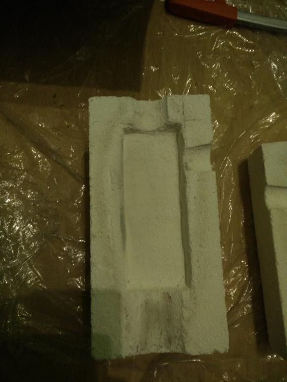

I spent some time browsing this forum while I was already building my 2 brick forge and I'm really happy with how much information I could scrounge. I am not new to hot metal but I am new to the forging and hammering part. I'll include some pictures of my project below.
I am planning to use the the forge for small knifes/chisels or to make small part for small scissors/shears. Anything small and metal that needs heating :)

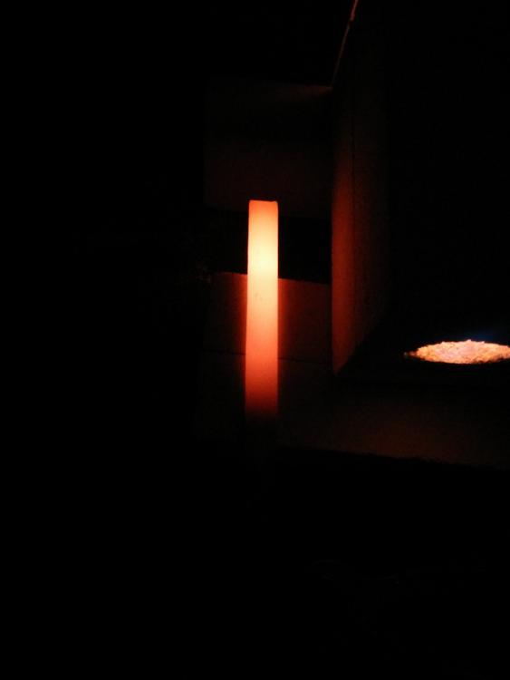

Now for my question: I do get a nice even heat on whatever I put in but it will not go any hotter than the picture below (as long as I ran it during my 2 test burns, say 15 minutes. see pictures) After pounding the stock with a hammer and researching the steel colours, I think I need to get my stock hotter. Could this be the torch I am using or the gas? I do get the same glow all over the chamber, also a nice hot spot. I know the 1300 degrees rating on the torch is for the flame itself and I am doubting on how much heat I need to get the entire chamber to warm up. Any help would be appreciated :)
Some info:
  • Top halve is a half cylinder
  • Bottom half is rectangular, flat bottom
  • Back port is smaller than front
  • Burner is a soldering torch rated to 1300 degrees C (2372 Fahrenheit,  butane propane mixture though I think mostly butane)
  • Burner is angled to the front (larger) opening and into the arch of the ceiling
  • Glowing part of the stock in image is the entire length of what was in the chamber
  • Size of the brick is 23 x 11.4 x 6 x64 Cm ( 9.1 x 4.5 x 2.6")

your problem is not the quality of the heat but the quantity.   In short you are not burning enough gas fast enough to do what you want to do.
I figured something like that. Thank you. I guess for now I could try enlarging the orifice on the torch burner. Not something I have ever done before, but, I got some drills. Maybe even better get another burner head for this torch or a tank/hose burner. I was trying to make due with what I had at hand and what I could find. Does anyone have tips on what kind of burner would work well for this small forge?
Drilling your current orifice out is a bad idea..  There are a number of alternatives but propane torches generally have larger heat output.    If Propane is not readily available to you check with your local people that do plumbing and see what they have available to for their pipe work.   The set ups for gas/ air burners can be rather critical in the smaller sizes.
It's a while since I played with a 2BF. On mine, I used a similar torch to yours, but made the hole where it feeds into the forge tapered: bigger on the outside, smaller on the inside.
This allowed me to move the torch in and out, varying the amount of air drawn in along with the main flame.
The flame from the mouth of the forge suggests that you are not getting enough air in to completely burn the gas, so there is probably something to be gained by increasing the airflow.
I agree with Charlotte that you'd be better off with a higher-output torch though.
No, drilling out the orifice in the jet will result in too rich a flame and less heat with more Co. Those burners are already tuned for a proper burn if turning up the gas pressure isn't enough you might look at a higher output torch or maybe building a forge burner.

HI, a small update The torch in the picture is indeed butane (mixed with propane, but in a negligible ratio) I have since acquired a small propane burner, which I still need to test. The winds have died down So I should be able to burn it soon. @timgunn1962 I have modified the burner opening slightly, I'll let you know how it works out.
Europe, has been moving away from straight butane torches, to butane/propane mixtures, for quite a few years now; it solves the low pressure problem...mostly. The only value straight butane torches have is their ability to form needle flames for silver brazing jewelry.

Mikey and Timgunn; most roofing and welding set ups will be propane, the torch I had was readily available and, to be honest, I did not research enough when I got it. By the time I fired it into the bricks for the first time I already knew it was likely not to be enough. I followed recommendations in this thread and left the orifice on both burners alone. What I did modify is this:
IMG_20160210_204344.thumb.jpg.49aadb0b0c
It was a bit tricky because I have the opening angled up toward the ceiling of the forge but the circumference of the inside opening is still about the size of the torch end.
How it looks in the dark:
IMG_20160210_212906.thumb.jpg.a4a477f3ca
With flash:
IMG-20160210-WA0008.thumb.jpg.7fb40c0f4b
And with some blue flame at the front that cleared after moving the brick blocking the back to create some draft:
IMG_20160210_213823.thumb.jpg.432a84c0d8
And after 10 minutes:
IMG_20160210_214208.thumb.jpg.0f34e0da39
So with the propane it gets hotter and it gets hot faster. I also got my mig contact tips today so I can start shopping for plumbing.
