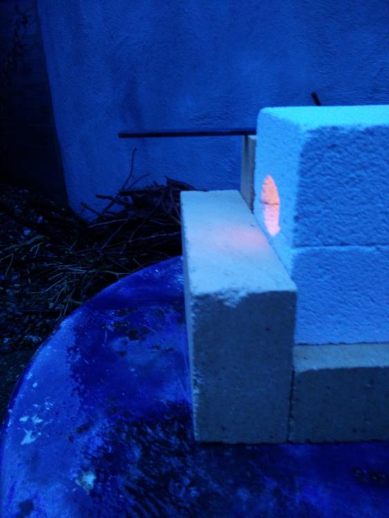

I wanted to share a picture of the burner flame so I stacked some of the hard bricks I have. As you can see it is still in a small chamber and aimed directly at the wall. Again, the set up is just for the picture and  the burner has been running for a minute. I would like to know what you think. (And I ran out of gas)

One test burn for tuning (I still need to figure out the ideal pressure):
IMG_20160227_200519.thumb.jpg.b9cf1f6188
When I run the burner in the 2 brick forge I get a lot of blue/orange flame from the front/back. Turning down the pressure eleviates this somewhat but at some point I start getting less heat. To be continued. Tips welcome, as always :)
