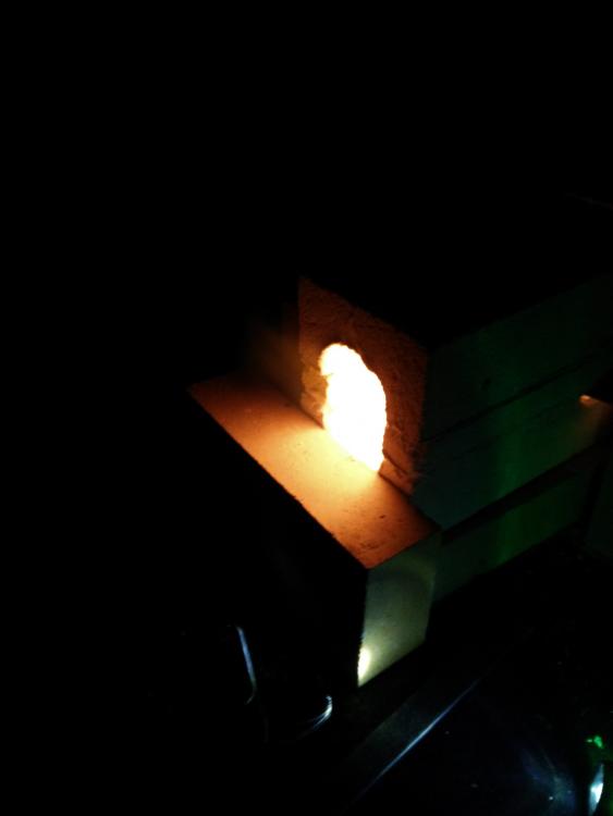

To illustrate the problem I made some pictures to the best of my ability :). This is after enlarging the chamber. The front opening is also larger now. I am not sure how to fix this. (I like pictures of flame though) I still have some brick left, Might be worth checking if making the chamber a bit longer will work. (I do not want to dig any deeper into the 2 bricks)

It could be a little bigger, maybe 25% but it looks pretty good as it is. It's running slightly rich which I like. Do you have more bricks? you could cut some thin slices from one say 1/2" and use it to space your current bricks and increase the volume without cutting more out of the ones you have now.

So....... Enlarging the chamber works :) The dragons breath is a little less rich, chamber heats evenly so that is ok. I managed to make something square into a point. The kiln wash has prevented these bricks from cracking. ( I am sure they will eventually) And makes it heat up a bit faster. I'm sure this forge is going to disintegrate soon, now the question is; should I get more fire bricks or build something else. (next month's question, I think in a different thread). Pretty happy to be hammering hot metal for now, Pictures:
