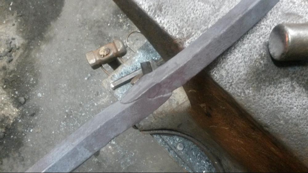

I recently killed two birds with one stone when I wanted to test the strength of my forge welds and also needed a handled to pull my workshop door closed. I found to pieces of scrap 20mm solid square bar, scarfed them and welded them together. I then twisted the weld loads and bent it a fair bit - didn't break and the scarves didn't peel up. FYI I don't like the aesthetics of this handle, it just served a quick purpose. Will upload pics separately as they are on my phone.
Pic 1 - half way through welding, pic 2 - completed weld, pic 3 - handle.
