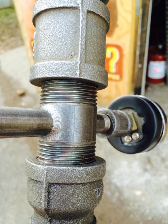

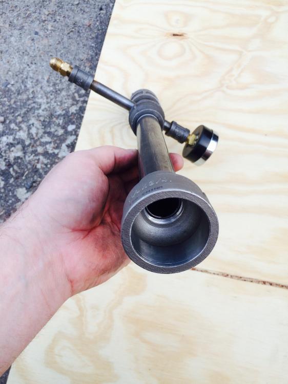

Here are some pictures of the Bruner and the potential donor tank. Also, pictures of the front door opening and work rest I will be applying to whatever vessel I decide on.

I also didn't know what to do with the burner cone. I didn't feel like flaring my own custom cone so I turned the threads out of the ID of a concentric reducer made from stainless. Is this going to work or is it too much of a transition from tube to flare for the flame? I am also currently looking for a gas regulator and hose set up is there anything particular that I should be looking for?

I wouldn't be surprised to see that flare work out pretty well; if not, it will be simple for you to try different sidameters of tube in it to find the ideal size; then you could just cut two or three of these "inserts" since the flame wear is all internal; this would allow you to stay with tha very nice screw on flare.
Not bad at all. You can't mount the burner that deep in the forge it'll just burn up. Pull it back till just the tip of the flare (whatever you end up with) is just poking into the liner. That burner should handle that volume just fine. Remember the number that counts is the inside volume and shape. Those tanks have been making fine forges with that size burner for a hundred years.

You did a lovely job welding things together, look forward to seeing the finished forge.  If the burner doesn't work well, no biggey, just build a new one.  Your fab skills are first rate, lets get you some experience. Welcome aboard.

Esone, I've seen few folks who can weld that pretty.  Nice job.
