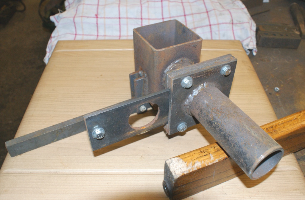

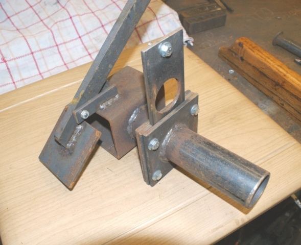

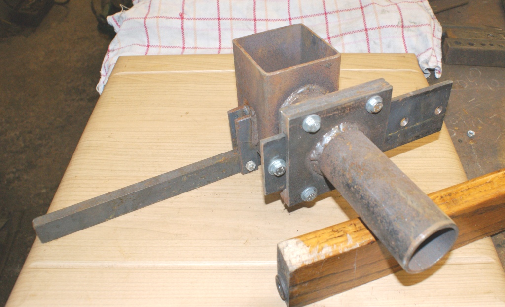

Here is a picture of a simple slide valve and ash dump ready to be mounted for a bottom blast hearth.
56635a3858d57_AshDumpopen.JPG.e6b0ae2a65
56635aa38c4ec_SlideValveOpen.thumb.JPG.f
The far hole at the extreme right on this picture I use as a stop by inserting a nut and bolt through (not necessary if size worked out correctly.
The inner of the hole on the right is to allow a small amount of air to pass as when we are using coke, if all air is shut off, then fire will go out, nott needed if using coal or charcoal.
SLIDE VALVE ASSEMBLY
comprising
Front/Back plate
100mm
6mm
100mm
2 off
Spacers
20mm
6mm
100mm
2 off
Slide
80mm
6mm
200mm
1 off
Shims to allow slide to operate freely
20mm
To suit
Drinks can flattened and cut, or card
100mm
2 off

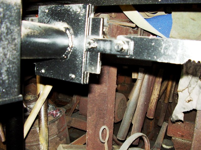

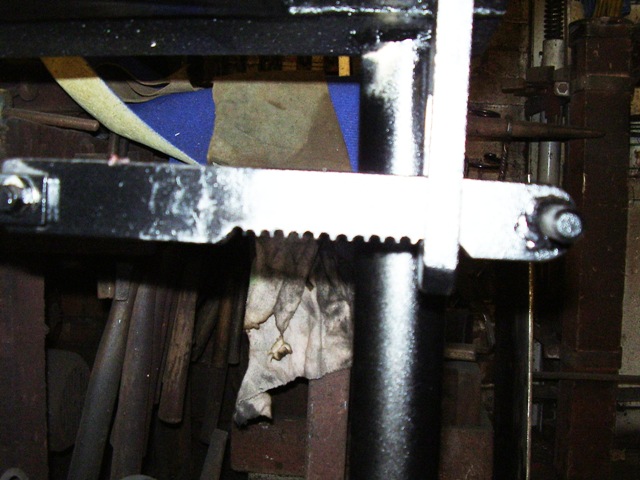

Also pictured here is a simple ratchet type handle, easy to work, adjust and repeatable.
56635a734b9f3_SlideValveLinkagetoratchet
56635ab986a9d_RatchetDetail.JPG.56c899f556635ab986a9d_RatchetDetail.JPG.56c899f5
Hope this is of some use to someone, any further information needed, please ask.
