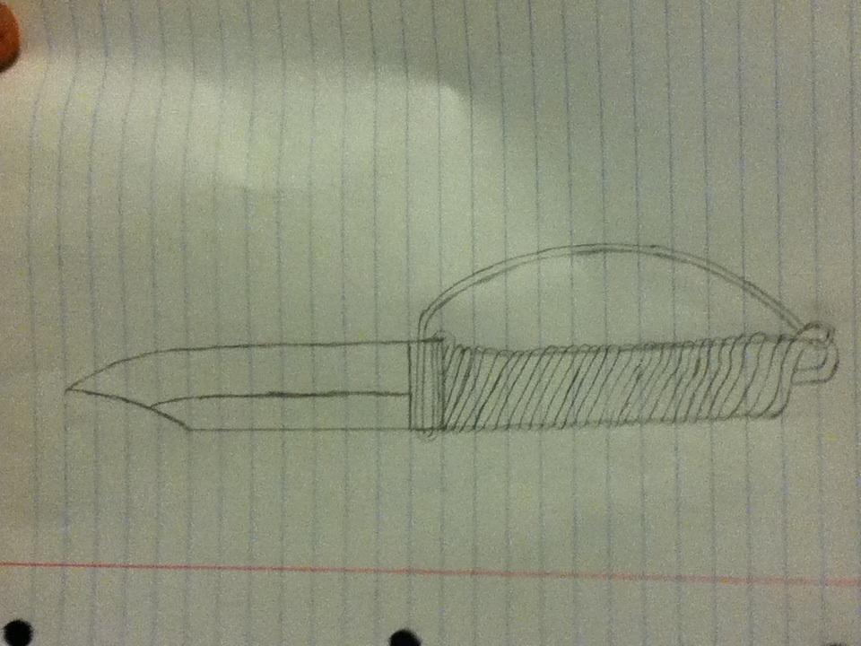

I knew from an early age that I wanted to go into a designing field, I have also really always wanted to try blacksmithing, well this is how I connected them. I set out to think of a knife design nobody has ever done before, obviously I can't patent this design and don't really want to. I want people to be able to do this! Although I do want people to see what I came up with. I don't want to "forbid them" from making a knife like this. I do not have a YouTube channel so I can't make and post a video. Mainly I just Don't want someone else getting a patent to keep people from doing this. So this is what I came up with: start with a railroad spike, first I will draw out the blade, it will probably be pretty average looking. Flatten out the head of the spike. Then I will start evenly drawing out the handle until it gets to be about a 1/4" in diameter (At this point it should be pretty long). From there I'll bend it at 5" - 5 1/2" up the handle and curl it back towards it's self and start wrapping the handle about 3/4" - 1" in diameter all the way to the blade. That should form a nice grippy handle. Then if there's metal left I will wrap a gaurs around the start of the blade (to protect the hand from slipping). If there is still metal left I will bend it around over top of the Knuckles. How much metal is left will entirely depend on how well I can it out. I am posting this for three reasons. One, as an instructional article for something I think is really great. Two, so I can get the credit for what I deserve as (as far as I know) I'm The First person to come up with this. Lastly, I want your opinions on this extremely exotic handle. Thank you, Brian.
Ps. I am not an artist but that's what I'm going for.

so first you made a mistake to assume a nail will make a good knife,  Second your claims its a one of a kind design is also wrong. and there is nothing exotic about  a wire wrapped grip.
Welcome to the forum, If you had read a bit and you would have seen that you have put the cart before the horse. Nothing wrong with getting excited,  just slow down and back up a ways.
First, there's nothing wrong with railroad spike knives, the ones I use are high carbon. Second, please show me a design where the handle is wrapped the same way. Third I say it's exotic because I plan to make it my own twist on a  hilt commonly seen on a rapier (an exotic sword). Lastly I don't at all claim to own rights, be the first to ever think of this I've just never seen any videos or articles on this wrap. I just want to post an instructional article on something I've never seen before.

No use folks..he already knows all there is..RR spikes are not *high carbon*..they are medium carbon at best...and not all of them are..Do they make a usable knife? All depends upon the material and the thermal treatment. I can get them hard enough to take and hold a using edge..but I know a few tricks in doing that. others do as well..it's all in the material and knowing how to use it to its best advantage.
Wire wrapped grips? NOT new..in any sense of the word...not "exotic" either.. Since when are rapier's "exotic"?? I make about 2 dozen of them a year...  Man this guy is way over the top...

Why are you getting so worked up? People are just commenting just as you wanted. Is it because our experts aren't smart enough? If it's because of the comments about spikes not being high carbon, just do a quick search for carbon content and then do a search for carbon content for blade steels and you'll see the difference.

Know that the OP is now offline and will not benefit.  Also am aware how ingenious and full of himself he came off in his first post.  Is description of his "exotic" handle was poor, but it did have an aspect that I think has been missed that made it fairly unique (mostly because it is a design that I think was pretty awful).  The wound handle is wrapped around a hollow core, like a spring.  Not sure if he understood that a 1/4" diameter wire spring would flex, which certainly wouldn't be good for a knife handle.
