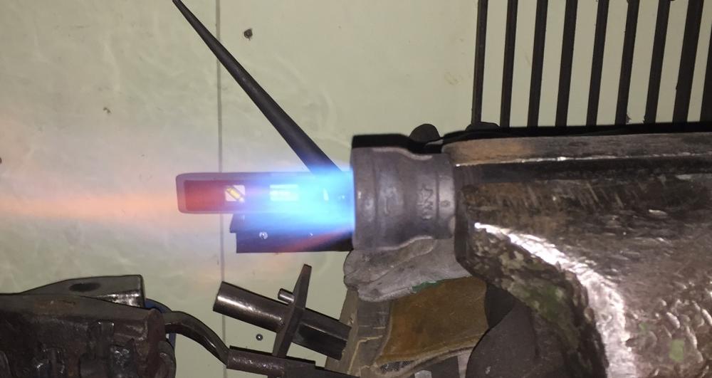

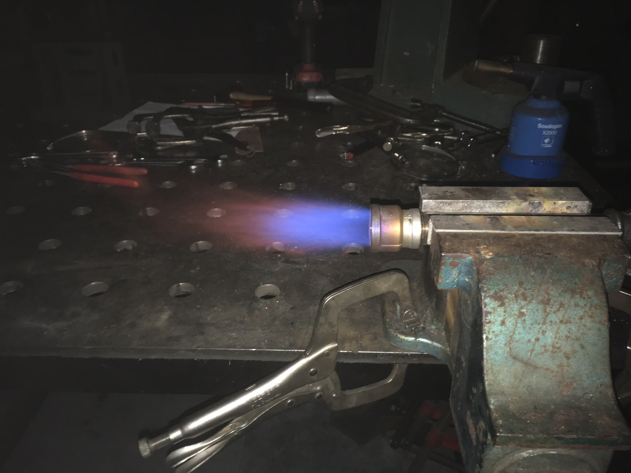

blacksmith-450 Posted June 6, 2017 Share Posted June 6, 2017 Frosty. My 2 T still running on the rich side. May I put washer(s) under the fitting to pull the whole thing back instead of cutting the mig tip? Quote Link to comment Share on other sites More sharing options...
blacksmith-450 Posted June 7, 2017 Share Posted June 7, 2017 When I asked my question this morning I was in the bus... Now I'm home and I have try by myself. First picture, it's «before» running at 5-6 psi. The second picture is with two tiny washers. I think that I came in the very fine-tuning zone. Comments ? Quote Link to comment Share on other sites More sharing options...
CDFingers Posted July 3, 2017 Share Posted July 3, 2017 I have lincoln mig welder tips with a 0.9mm thread. The threads fit loosely into the flare fitting, but the shaft of the mig tip fits snugly into the flare fitting. Question: Would using a bit of JB weld or other means like brazing to secure the mig tip to the flare fitting, be an acceptable design variant? If not I will order order the Twecos such that I can cut threads into the flare fitting. Quote Link to comment Share on other sites More sharing options...
Frosty Posted July 3, 2017 Author Share Posted July 3, 2017 On 6/6/2017 at 8:12 PM, blacksmith-450 said: First picture, it's «before» running at 5-6 psi. The second picture is with two tiny washers. I think that I came in the very fine-tuning zone. It looks pretty good with a white wall for a background to the picture. How's it work in the forge? On 7/3/2017 at 11:58 AM, CDFingers said: Would using a bit of JB weld or other means like brazing to secure the mig tip to the flare fitting, be an acceptable design variant? If not I will order order the Twecos such that I can cut threads into the flare fitting. Welcome aboard CD, glad to have you. If you'll put your general location in the header you might be surprised how many of the Iforge gang live within visiting distance. There is a lot of variation in the through hole diameter in brass fittings, that's why I tell folk to take the right diameter drill bit to pilot for tapping the hole to screw the mig tips into with you when you buy the fittings. You use the drill bit as a go / nogo gauge. You want the drill bit to fit the hole snugly or not fit at all, if it is a loose fit it won't work. JB weld will fail if it gets very warm let alone how hot a forge burner gets when you shut it off. I have heard of guys threading the outside of the mig contact tip itself but I've never tried it so that's hearsay. Frosty The Lucky. Quote Link to comment Share on other sites More sharing options...

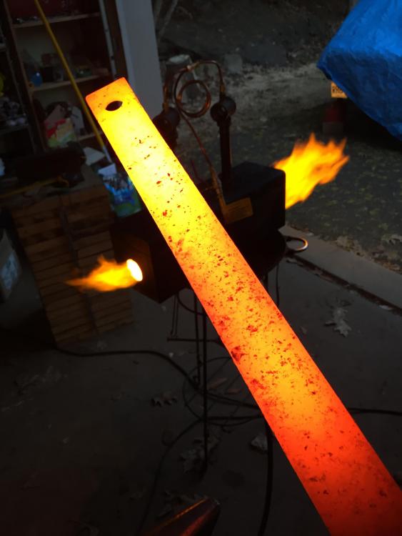

blacksmith-450 Posted July 4, 2017 Share Posted July 4, 2017 On 7/3/2017 at 12:27 PM, Frosty said: How's it work in the forge? Like this ! I'm pretty satisfied. Thanks again Frosty. The flat bar is 1-1/2 X 1/4, the dark points are rust, not scale. Quote Link to comment Share on other sites More sharing options...
ThomasPowers Posted July 4, 2017 Share Posted July 4, 2017 Well as the fellow who first taught me forge welding used to say---"Don't look at it---*HIT* *IT*!" Quote Link to comment Share on other sites More sharing options...
Frosty Posted July 5, 2017 Author Share Posted July 5, 2017 Looks good enough to HIT IT! Frosty The Lucky. Quote Link to comment Share on other sites More sharing options...
