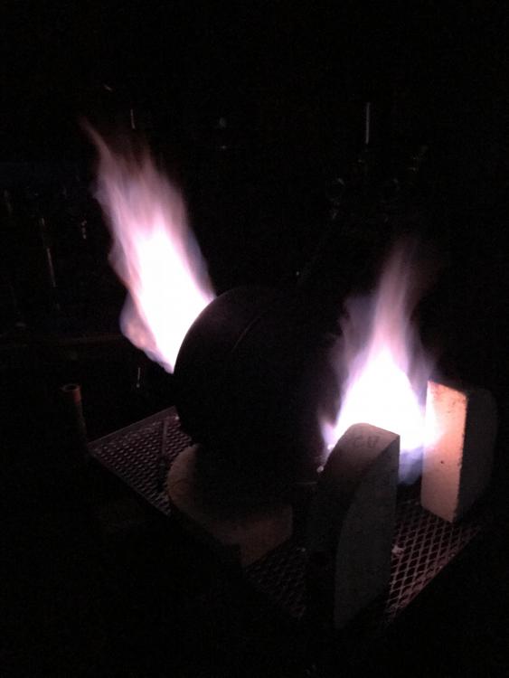

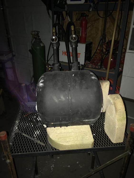

  18. Well I got the sputtering problem licked - turns out one of my jets was not quite lined up as well as it could have been. Drilled and tapped a new T and all seems well now. It doesn't seem to be getting as hot as I think t should be - I can forge with it, but it doesn't seem to be getting welding hot, and there is a lot of dragon breath. Can I close off the back a bit with some brick, would that help?
