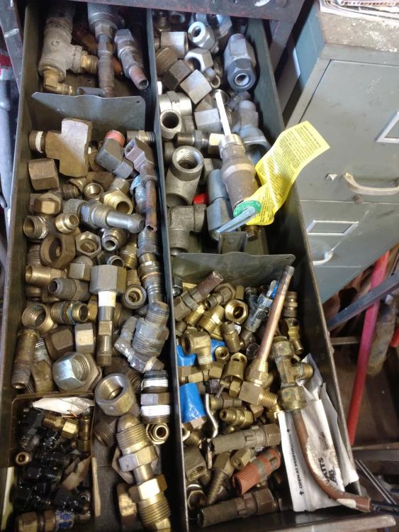

Reeltree Posted March 23, 2018 Share Posted March 23, 2018 Never ever fails,,you can bend down pick up every little nut bolt washer , save every usable screw for untold years and when you need that specific one Out of Luck. Same applies to The burner parts, decided to slap a couple together knowing full well I must have the fittings,Pffft everything but, have every tweco tip except .35, even have a big spool of .35 wire go figure. Somehow I managed to have a 1/4 x 28 tap.Anyhooo I will get one done sometime or another. Quote Link to comment Share on other sites More sharing options...
ThomasPowers Posted March 23, 2018 Share Posted March 23, 2018 Seems like the ones most commonly used get used---why I like to buy an extra when I have to go buy a part for something I use a lot... Quote Link to comment Share on other sites More sharing options...
Reeltree Posted March 23, 2018 Share Posted March 23, 2018 Was able to find some stuff,,just need to get a regulator and some .35 tips. Lincoln magnum tips will work with the 1/4 x 28 tap Quote Link to comment Share on other sites More sharing options...

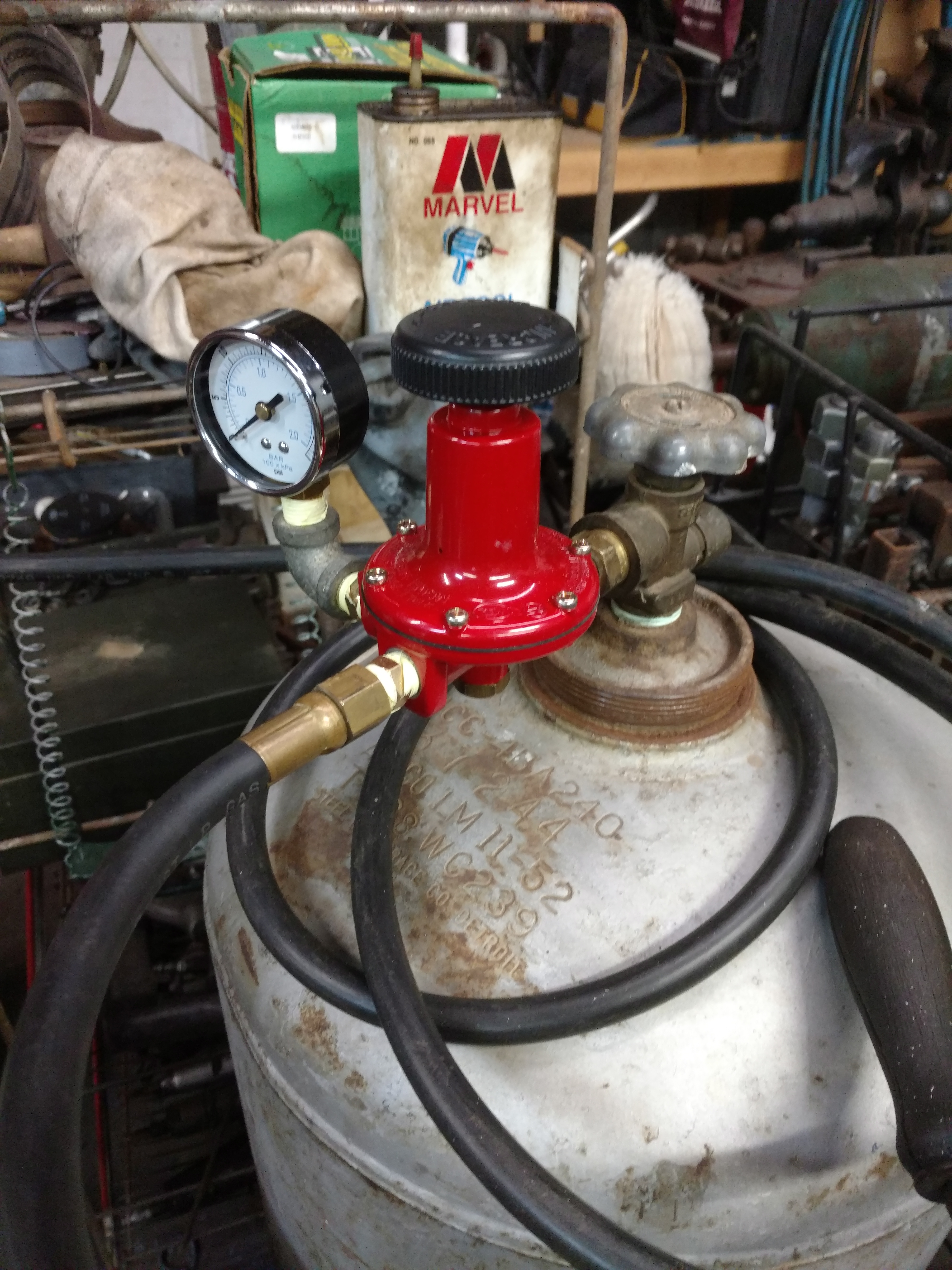

Reeltree Posted April 1, 2018 Share Posted April 1, 2018 0-30 psi adjustable high pressure regulator showed up today,,a snaping/ popping sound as the gas valve is slowly turned on and off . Sounds like the diaphram inside the regulator. Does not return to set pressure, most times only barely allows flow until repeatedly close/ open gas valve. $45 HOJ. Will call the supplier Monday. Did get it working for a few times and tested the two burners. Will fine tune those after forge is built, thinking of a old portable air tank as the sacrificial lamb Quote Link to comment Share on other sites More sharing options...
Frosty Posted April 1, 2018 Author Share Posted April 1, 2018 Is it the regulator or the safety valve in the propane tank? The newer tanks have a valve that restricts how fast it will release a large volume of gas, it you open the valve too quickly it trips the internal safety valve. Try opening the tank valve slowly and see. Frosty The Lucky. Quote Link to comment Share on other sites More sharing options...
Reeltree Posted April 1, 2018 Share Posted April 1, 2018 Thx for the reply,,the tank is old as Methuselah, I have been opening the gas valve sloooowly, I usually do the same on the torch tanks , I will try the reg. on a newer 20 # tank tomorrow , I took the hose off the out port and tried free flow incase was any trash, no ,luck,Ialways crack bottle valve before attaching any thing , Quote Link to comment Share on other sites More sharing options...

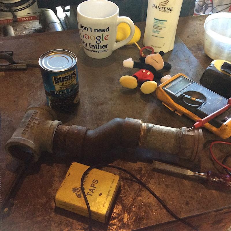

Lou L Posted July 19, 2018 Share Posted July 19, 2018 Okay, I tried following the directions to the letter but I didn’t have exactly the right materials. I feel like the slight differences in materials shouldn’t make a difference but when I try to fire up the burner it just burps out a lazy flame like a lighter would. Suggestions would be welcome. Oh, I placed a can of beans next to the burner for size comparison. Curmudgeon bait! Quote Link to comment Share on other sites More sharing options...
JHCC Posted July 19, 2018 Share Posted July 19, 2018 That's the most Mickey Mouse version of the T-burner I’ve ever seen! Quote Link to comment Share on other sites More sharing options...
Buzzkill Posted July 19, 2018 Share Posted July 19, 2018 Now you need to see if you can introduce the fuel at the end of the pipe and get two perfect flames out of the T. Quote Link to comment Share on other sites More sharing options...
Lou L Posted July 19, 2018 Share Posted July 19, 2018 I’m sorry, I guess my picture was at a bad angle and you couldn’t see the gas fixture. I took another for clarity. Now it should be obvious that the flames shouldn’t be coming out of the “T” but they still are. Quote Link to comment Share on other sites More sharing options...
