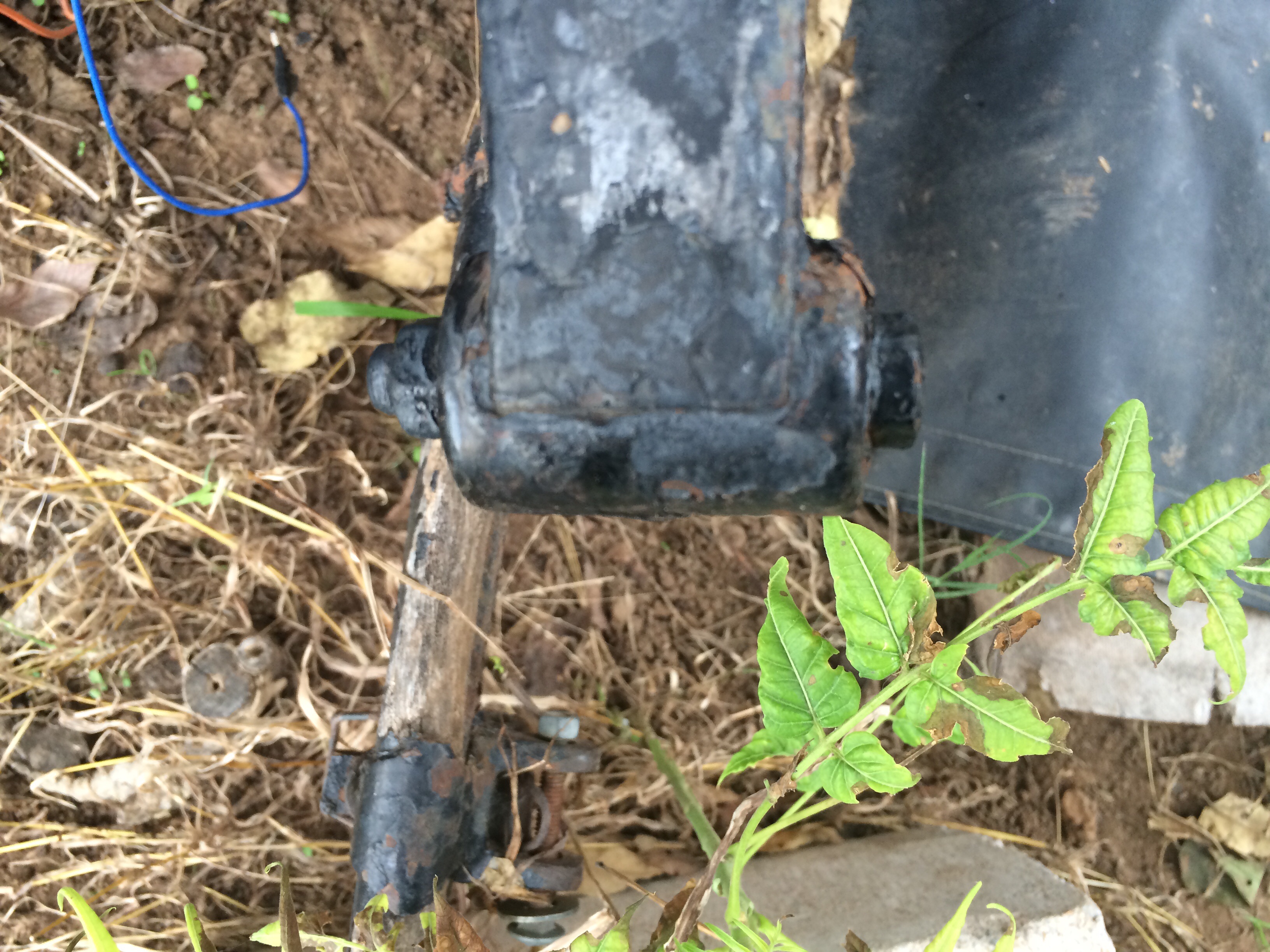

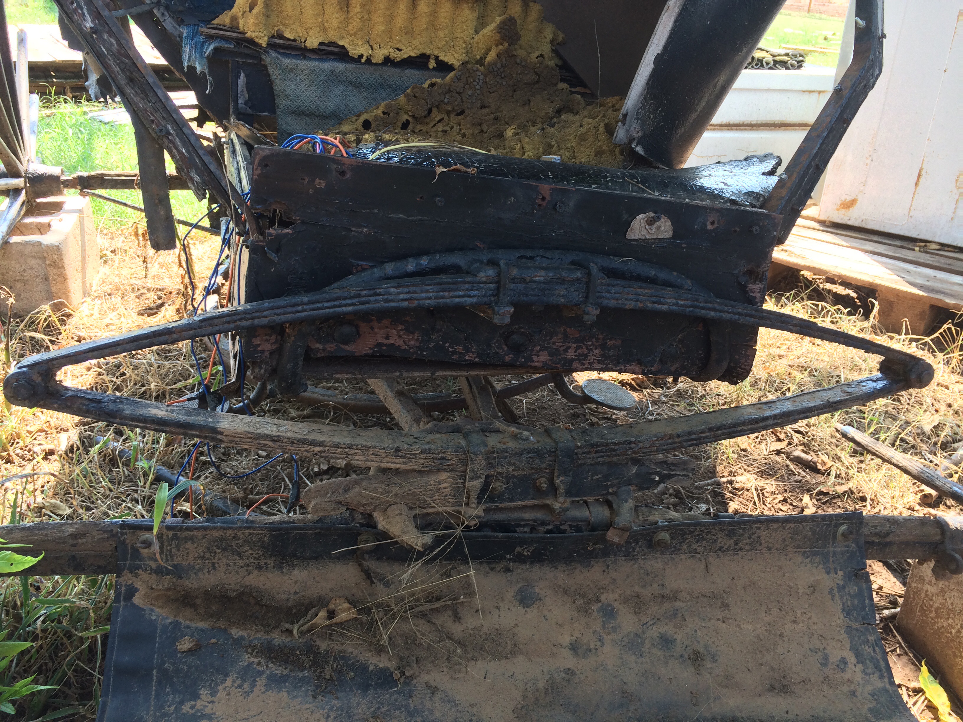

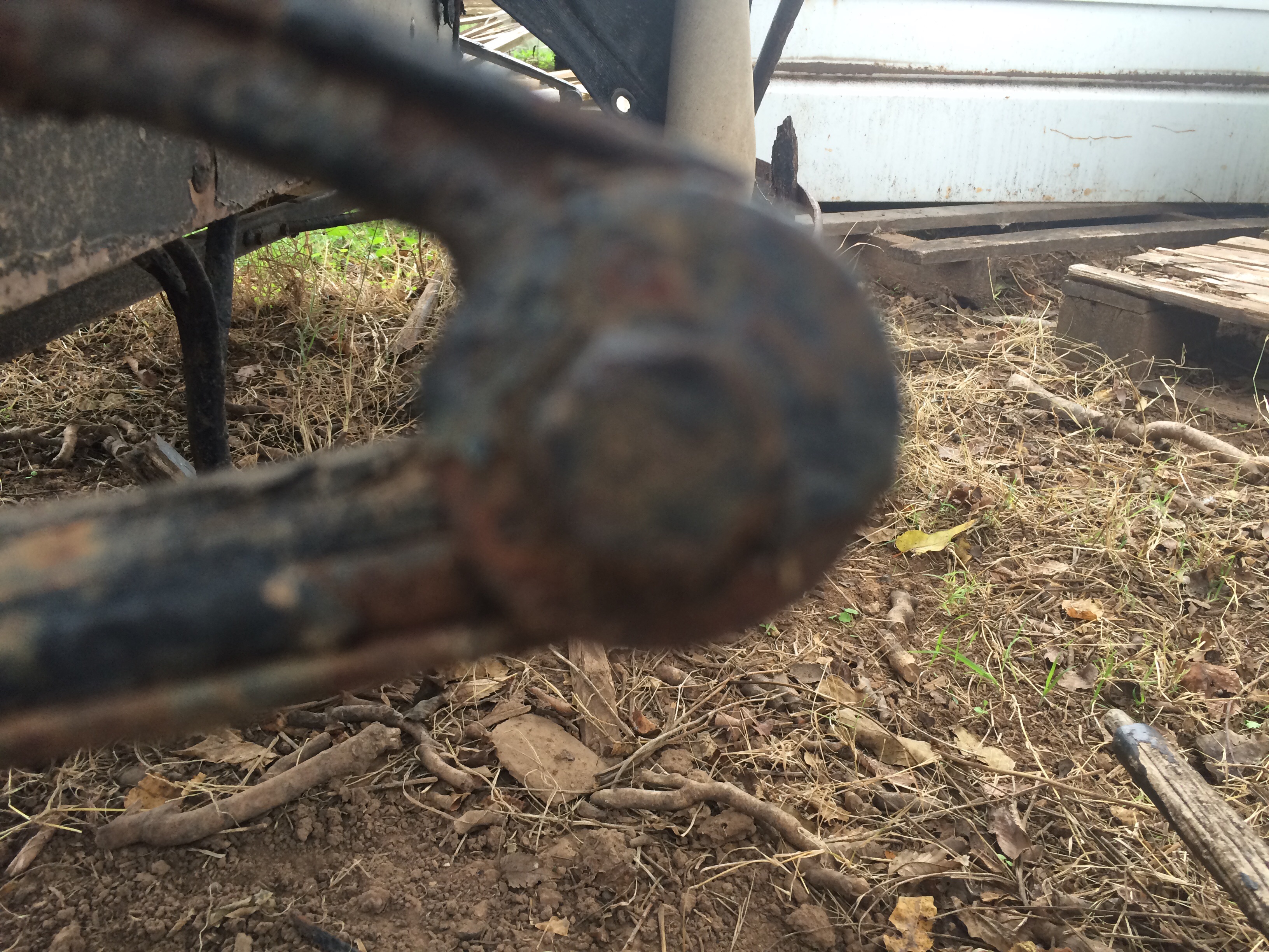

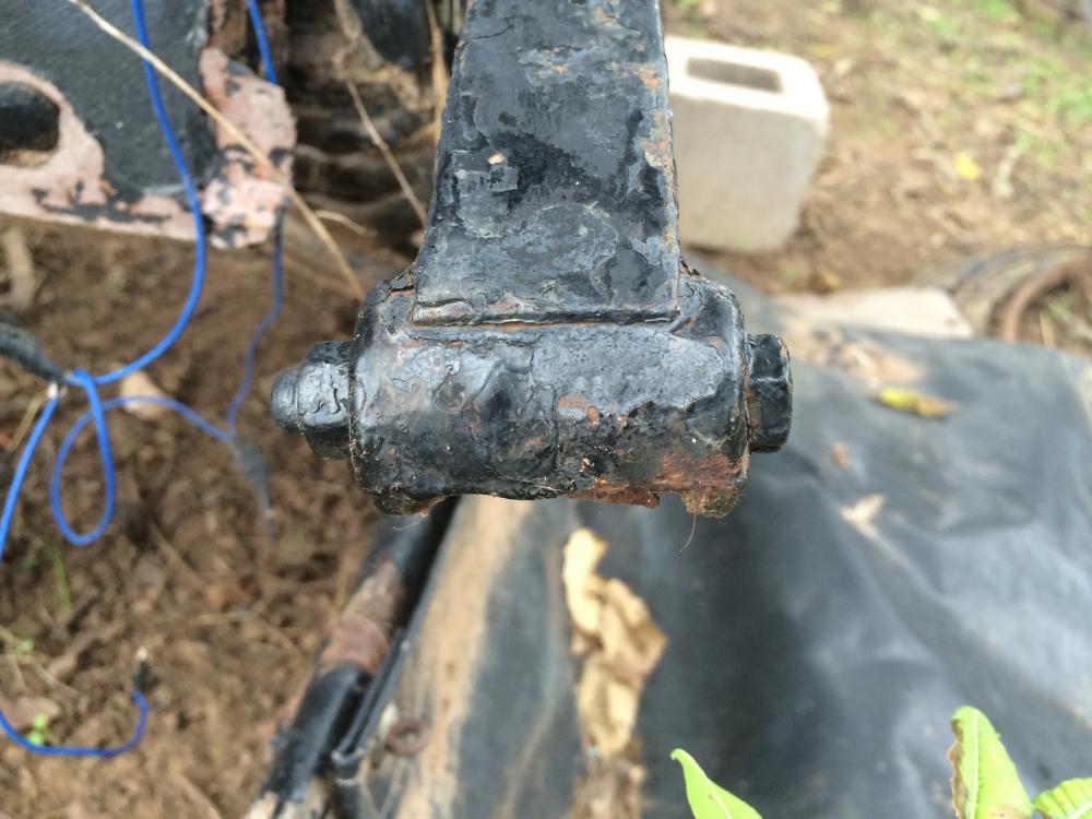

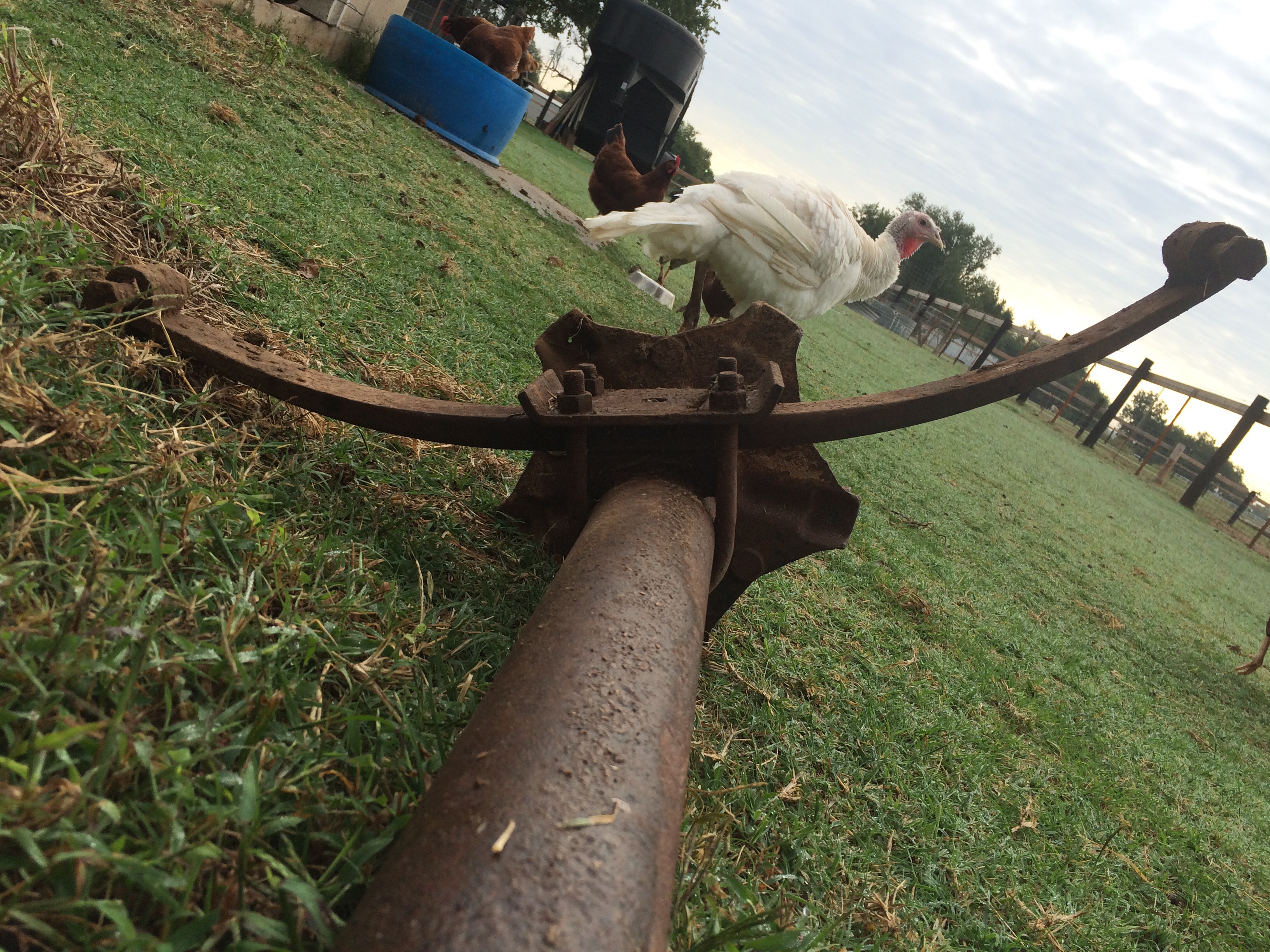

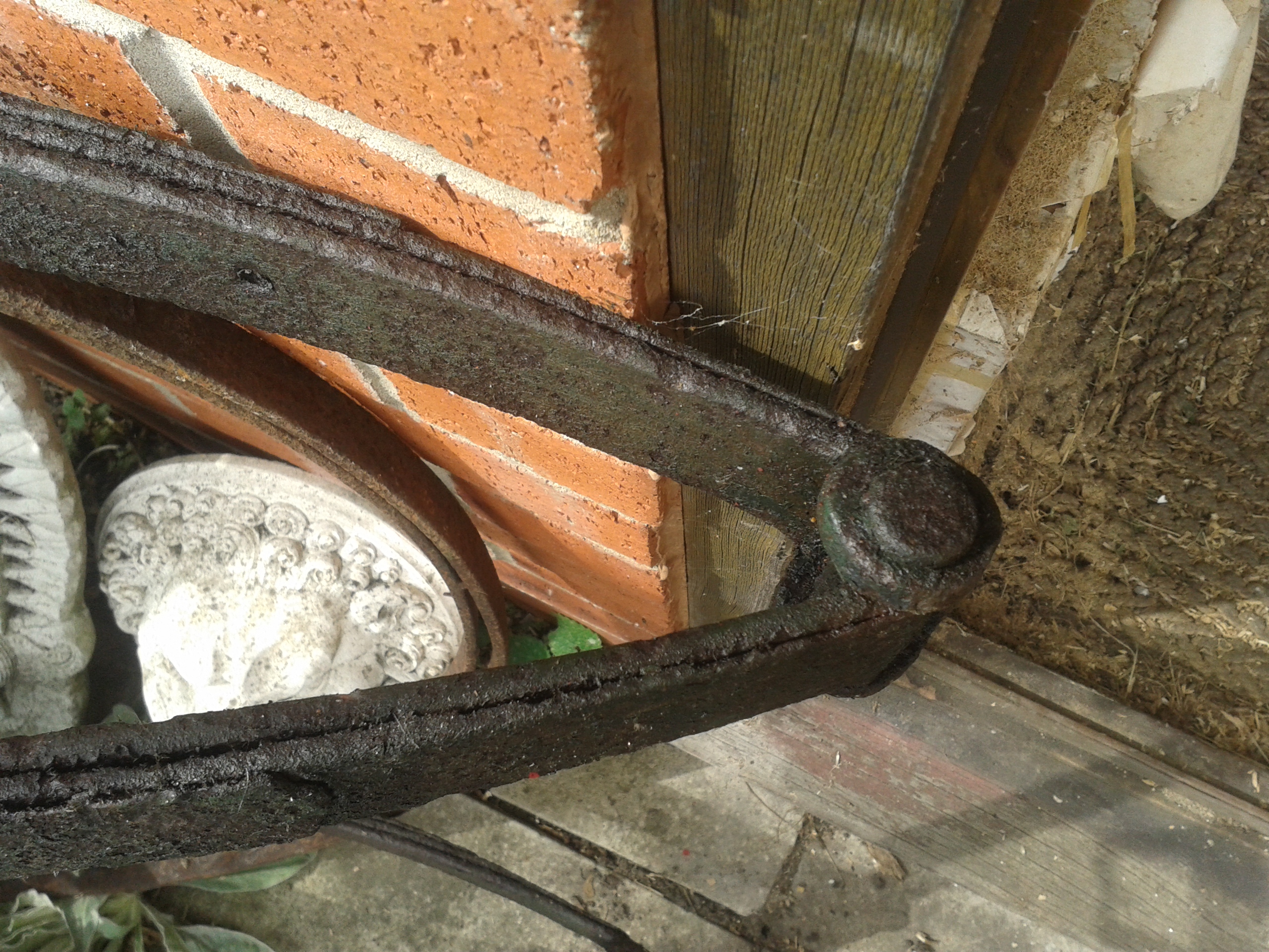

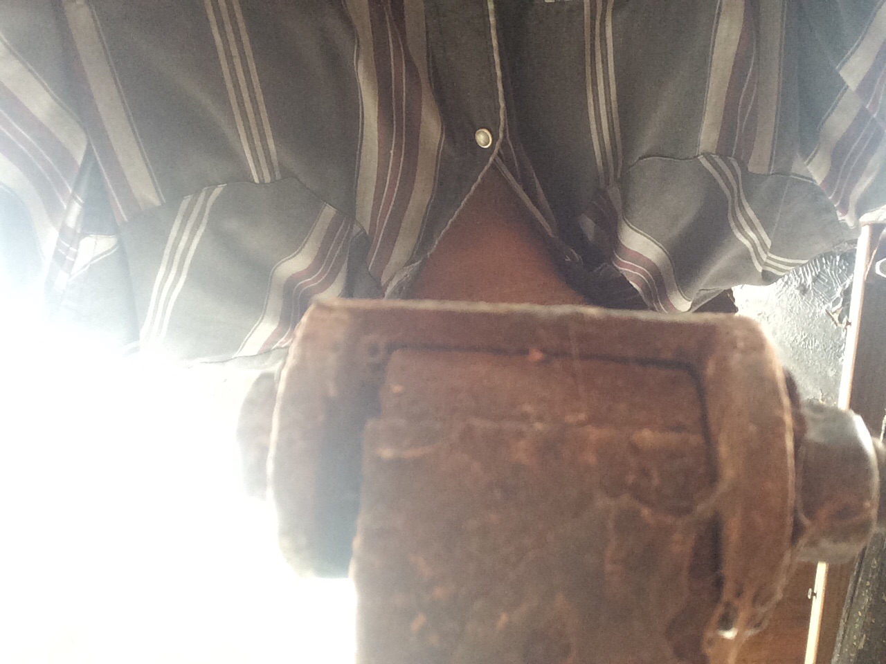

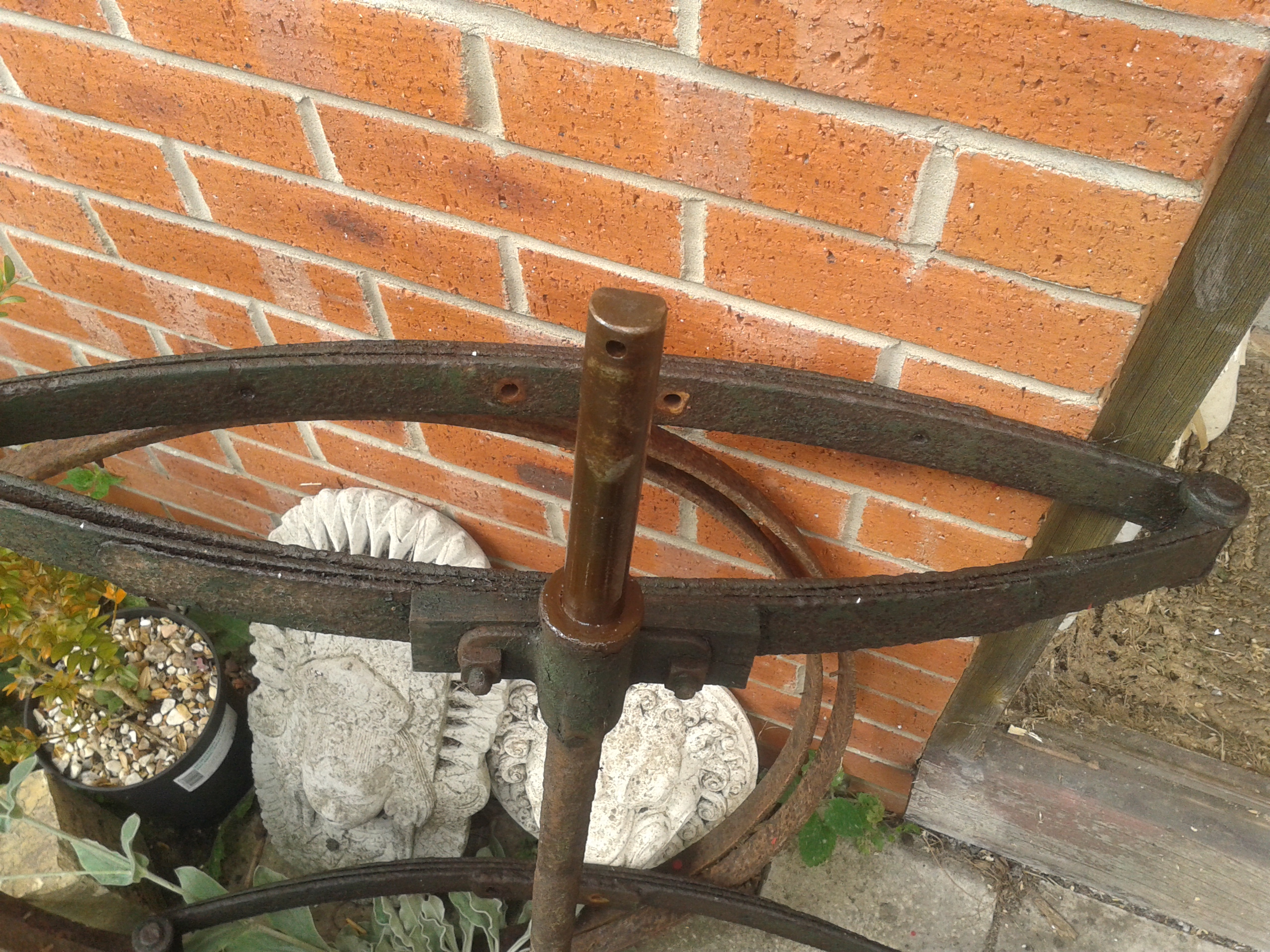

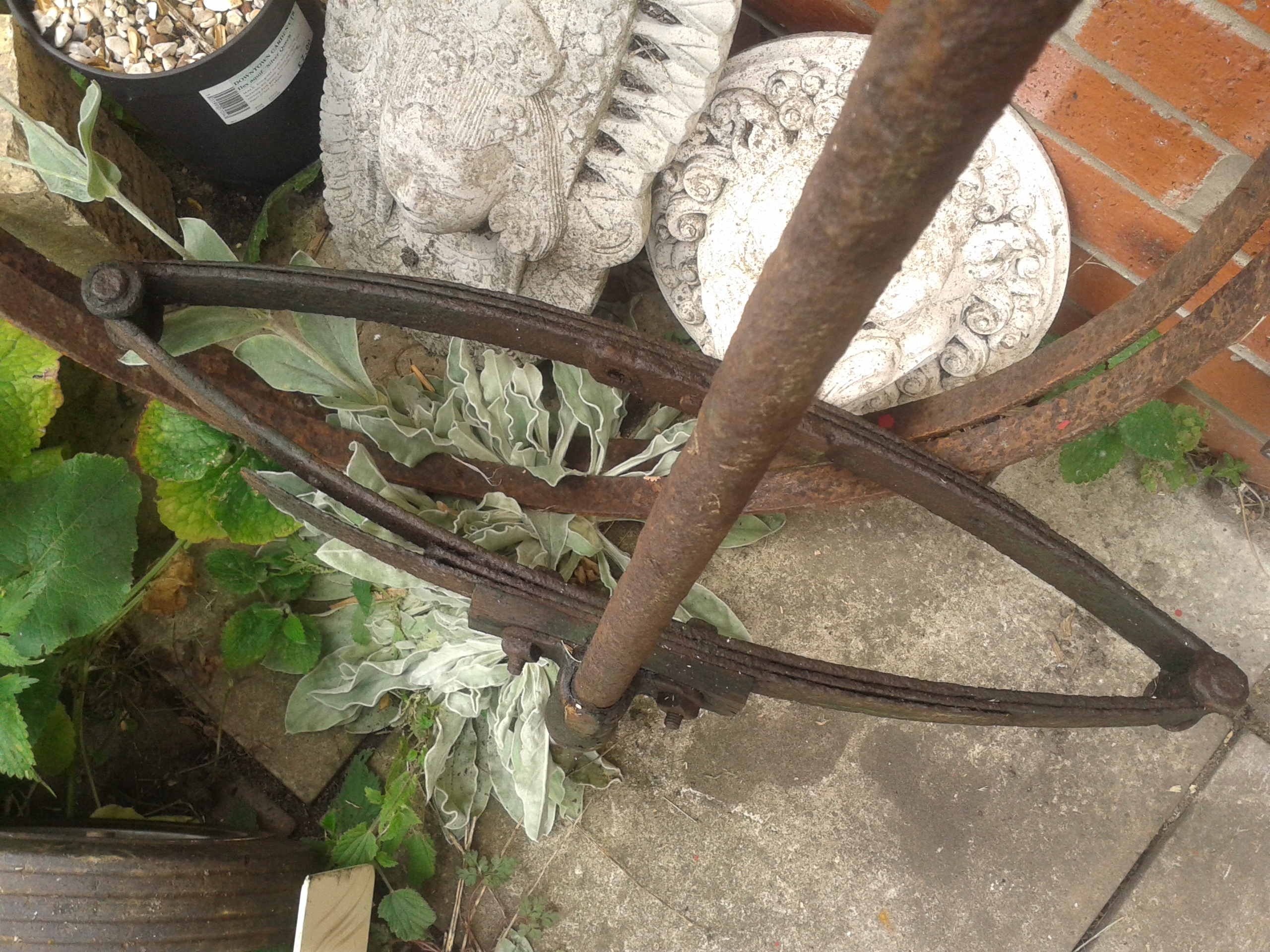

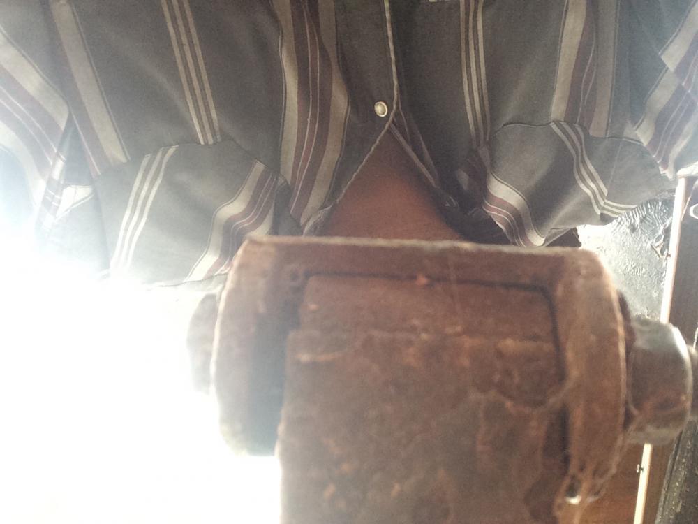

Wayne Posted October 5, 2015 Author Share Posted October 5, 2015 Finally got the pictures sorted for the cart springs I aquired Quote Link to comment Share on other sites More sharing options...
Charles R. Stevens Posted October 5, 2015 Share Posted October 5, 2015 (edited) Nicely fited. You can see wher the washers where jumpwelded on, but with modern spring steels, pre heat and weld with your faverite 7xx rod should be just fine. You can see that this set uses tubes with washers welded on the end, then welded to the springs. Edited October 5, 2015 by Charles R. Stevens Quote Link to comment Share on other sites More sharing options...
gote Posted October 6, 2015 Share Posted October 6, 2015 You did not ask about it but I cannot help myself. I must show off what i have learnt.There is a good reason why the spring is made up from blades each one shorter than the previous. In this case a main blade with two more.The spring is subjected to a bending moment and a shear force. The moment is zero at the far end and maximum at the fixed end – in this case the middle. If you want to keep the resulting stress in the blade constant you need to make the spring triangular; wide at the fixed end and tapering towards the other. This is impracical so the theoretical triangle is cut into strips and these put on top of each others. The result is the spring you have. The three blades would make up the triangle if laid side by side. The result of this design is that the stress, caused by the bending moment, is nearly constant in all three blades over the whole length.If it were only the bending moment, the spring could be very thin at the end. However, there is also the shear force to take up. Unlike the bending moment, the shear force is constant over the length of the spring and material able to take this force must be added. For that reason the main blade usually is sturdier than the triangle would call for. At the same time this gives material enough to shape the ”hinge” at the end.I hope this was not too boring and bemuddledCheersGöte Quote Link to comment Share on other sites More sharing options...

gote Posted October 7, 2015 Share Posted October 7, 2015 I did not even get a forbidden this timeThe cart springs Wayne have acquired are fully elliptic springs. The spring you find on an old car or truck are half elliptic. Old Bugattis had quarter elliptic on the rear axle. In all cases, the leaves are bolted together in the thickest point which in the case of semi-elliptic or elliptic spring is where the axle is fixed. Everywhere, except there, the leaves rub against each others when the spring flexes. Since there is some kind of plate holding the spring at the middle the spring cannot flex where the plate is but the flexing starts just outside the plate.You all know that if you hold a flexible bar in the vise and bends it, it will bend most at the vise and not at all at the end. The end moves but does not bend. When you deform the bar it will bend permanently at the vise because the bending moment is highest there. The whole idea in leaf spring design is to distribute the material in such a way that the stress is uniformly distributed so no part is subject to more stress than another. The result is that the spring always follows a circle. When it flexes, it flexes uniformly so the bending radius is everywhere the same. This is flexing due to bending. We cannot follow this principle exactly because we have a uniformly distributed shear force on top of the moment and the main leaf is made thicker in order to take up the resulting stress. (or there is a second leaf of the full length). This way there is also material available to make up the eye.For this reason the spring actually bends less at the ends.Yes a spring that is designed well bends most in the middle and less at the ends but the difference in radius is not great.I hope this is clear. English is not my native language you knowGöte Quote Link to comment Share on other sites More sharing options...
