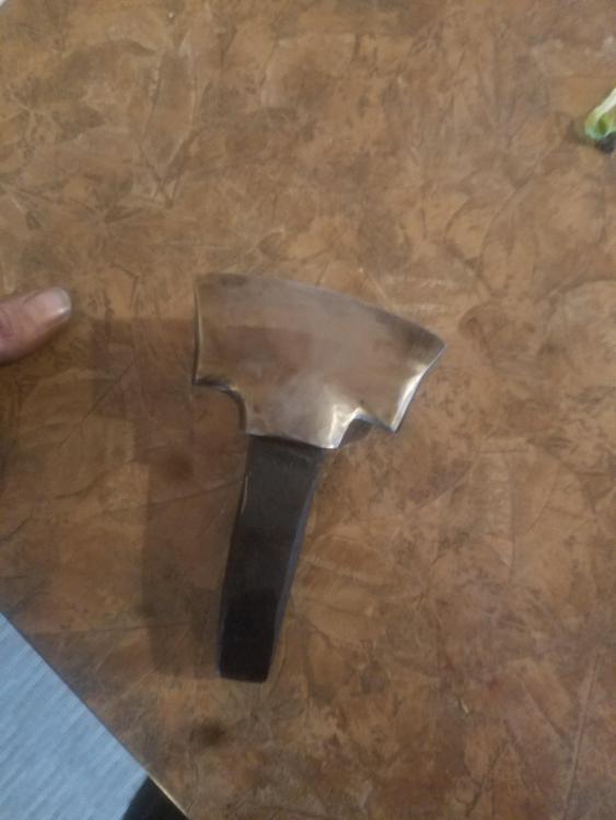

Hot cut I made today.  First one i quench in 10 deg F. oil without warming it.  Opps don't do that!! I'm a noob so dont think it's what a hot cut is supposed to look like.  I've just started.
    Over tempered one corner in the forge.  But all in all it turned out ok imo.
Second set of pictures are the first one i made.  I almost Cried when I heard it pop.....
My Queens Dudly has a wandering long tapper in the hardy.  It's a real pain to make a hardy turn two ways. Material was a very large spring off a semi Trailer.
Mistakenly posted in the wrong thread. Not trying to hijack.  Sorry
Naw, not a hijack it's just another hardy to be discusses. Nice learning experience, you usually don't see so many mistakes in one post.
Next time before you forge the cutting profile forge the shank and drive it HOT into the hardy hole in your anvil. Let it air cool and double check for a close but free fit.
I assume it's a hot hardy and doesn't need to be hardened, normalize when you're finished forging and it'll work fine. Honest it will. B)
Haha I know I know.  Mistake should have been my middle name lol
I did forge the shank first on both of them by forming them hot into the hole but the hardy hole slants off into the anvil and I wanted it to fit tight at least 2 ways. First one did not, second one does and is much better all around.
 I just reread my post and it's hard to follow.   The one I cracked, in heat treat last night was just the first of 3 failed projects.  Ever have one of those days where you should probably just have stayed in bed? Lol.  I was however stoked when I was able to pull the second one off.  It's really the best thing I've forged so far.
 As far as heat treating the hot cut, I knew I didn't need to, and it is dangerous to hammers to have it hard. Hmm,.. Guess I just had to do it. Just Like I Had To go though my chisels and punches at work. Reworking, heat treating and tempering them all. Maybe I'll anneal it just for practice now.
I've only about 30 hours total on the anvil. Prolly many more mistakes in my posts to come.
I'm much happier with the one I made today. Can turn two ways and it's in one piece hahaaa :)

That's very true. I was making a hot-cut top tool a while back, and from pushing myself to complete it quickly, I got into a place where I wasn't thinking clearly and used the wrong quenchant. Result: big ol' crack right down the middle.
 Lessons learned:
1: Don't quench heavy pieces of torsion bar in cold water.
2 (and more important):  if you're starting to get tired, lose focus, or rush things, SLOW THE (language inappropriate for a family-friendly forum) DOWN!!! Better to lose a little time than to lose all the time, materials, and effort you've invested so far.

One thing I teach new students is that you stop *BEFORE* you make the unrecoverable mistake due to tiredness, loss of focus, hunger, etc. Learning to do this is as important as learning not to hammer on cold high carbon steel or quench high alloy steels in cold water...
Now for my question:  Have you cleaned up the hardy hole in your anvil any?  Especially with modern tooling (old time smiths would have killed for a working die grinder!) you can dress your tools to work better---and an anvil is a tool not an altar!
