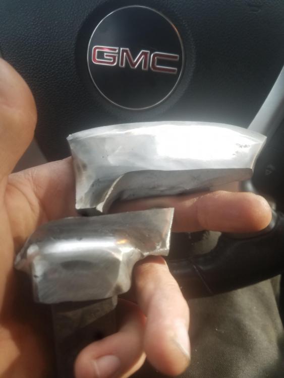

Agreed on all points Mr. Stevens after catching the local blacksmith in town , and we talked found the problems besides the steal . Was that needed to upset it more for more  to fit on the anvil it self not just the hardy , the first go at it now to get some good steal and make another one .

I'm with Charles, the bevel is more cold cut obtuse, a hot cut needs to be more acute, axe vs. maul is a good comparison.
I'd clean up the corners on the shank too the less texture on the shank the less likely it'll jam in the hardy hole. Also the less likely it'll make cuts which can turn into cold shuts weakening the anvil through the hardy hole. A smooth clean shank is IMHO important on bottom tools.
It's a good first attempt. Next time try drawing the blade down over the horn. It'll forge faster and give you the slightly concave bevel that's a signature of good hot hardies. Just remember the actual final or cutting bevel needs to be slightly convex. The physics of why convex is superior for heavy cutting than straight or concave is involved but once you see the pics it's pretty obvious.
Again, good start on tool making. move up to spring, torsion bar or such and you're off and runnng.
Thanks for the input and advice Mr. Stevens and Frosty , a little worried about driving it into the hardy hole . This anvil is a 55 pounder from harbor freight , bought it because of the wider face and hardy hole . Trying my best to find a good one here in Texas that doesn't cost as much as I can buy a new one for from Centrum forge . Might go back to my railroad track after I find a piece of good one inch plate to weld on top and garden with hardy and prickle hole . But time to try again thanks again for your advice and patients .
