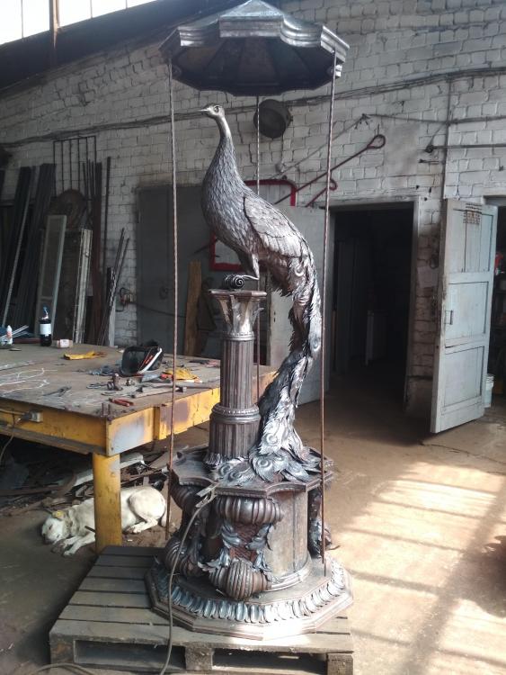

Great video of the bird's head. I think I caught a glimpse of the rest of the bird in the background there. Would like to see the finished piece. Classy work.
I was wondering how he gets on arc welding with no gloves or sleeves. I would be suffering 'sunburn'.
