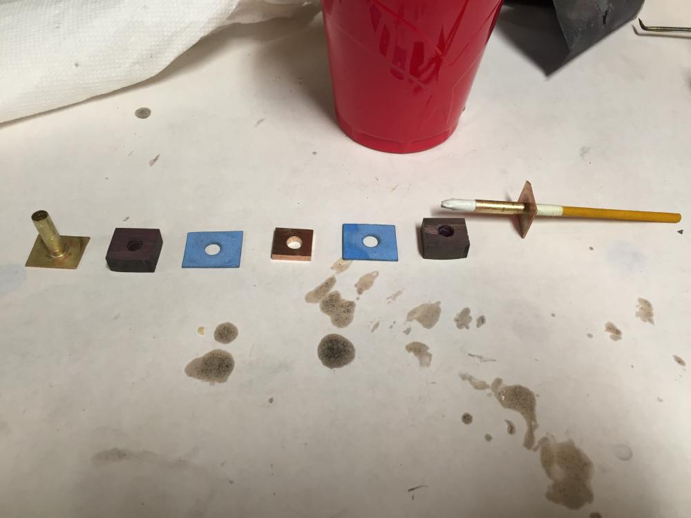

  3. I'm reasonably certain that member projects is more applicable than the Mokume forum, if not, I'm sure you know where the move button is. I have admired the excellent lock work shared by Nick and others here and elsewhere so I jumped at the opportunity to get a copy of instructions and materials to make a Viking era padlock myself. I decided to up the ante a little and make the materials a little more interesting though. The top and bottom plates are spare quarters mokume and the body is a sheet of copper with a design chased into it, subsequently filled with melted brass wire and melted silver solder in different places then ground smooth to give it a kind of faux-kume look because I didn't have the time to make a fresh billet that could be forged into sheet metal big enough to make the body. The rods are 4 wires (2 copper and 2 brass) twisted together tightly, soldered solid into one bar, then forged cold to knock off the ridges and make it more of an actual circular cross section, the tops are 4mm sterling bezel cups set with lavender opals. The ward plate on the shackle is another chunk of spare mokume and the spring is nickel silver sheet metal flush riveted on with copper pins. Both the shackle and key are forged silicon bronze. The lock is operated by inserting the key into the rectangular slot on the bottom, rotating it into position and sliding it up to compress the springs, which will allow the shackle to pop through the hole in the top plate. Thanks for looking!

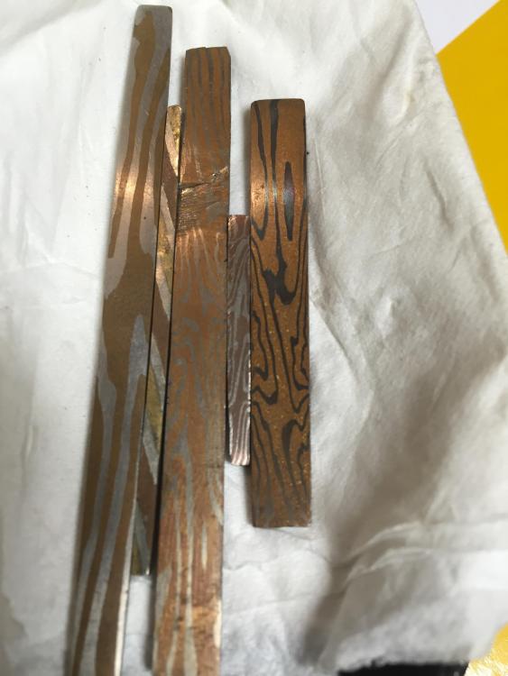

  14. I have had some difficulty reproducing this effect I got early on in my fiddling a with Mokume, but the sticks of twisted billet are all from copper and nickel coins. The knife clip on the left and the bar on the right are from the same billet of UK copper pence and 5(or 10 or 20, I forget) pence coins (not the more modern steel core ones) and the two in the center are straight up U.S. quarters. The blackest one is from the quarters, and I'm pretty sure it was just from overheating the life out of it and really severely fire staining the nickel (which is like trying to excise the devil), then it got a soak in the pickle pot to clean up the copper a bit. That particular bar is so overcooked you can see individual grains in the copper, giving it a really neat granulated appearance actually the picture makes it looks a bit more black than it is in person, more of a dark blue/grey really. I'll try to remember to go fish it out and shoot a more representative picture later. Edited to add: you won't be able to just throw some titanium into a regular billet and cook as you normally would, the reactive metals need to be done in a controlled atmosphere because they (as the name suggests) start reacting with oxygen when they get hot and will not bond =\ Edited again with new pic: The three bars on the right are all from the same parent billet, with the blackened nickel one on the far right and you can kinda see the flecked texture in the copper even though the surface is quasi polished but totally flat.

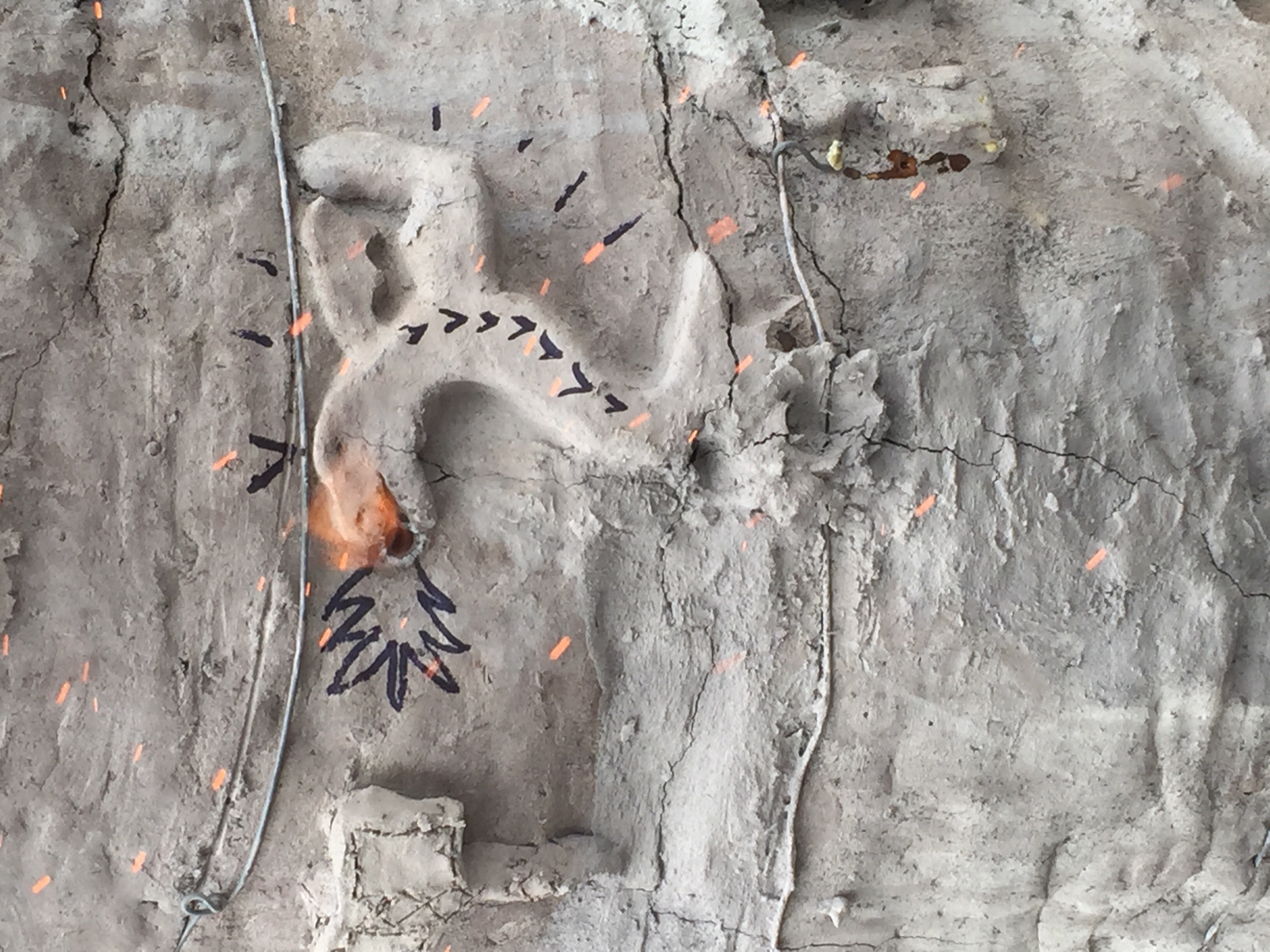

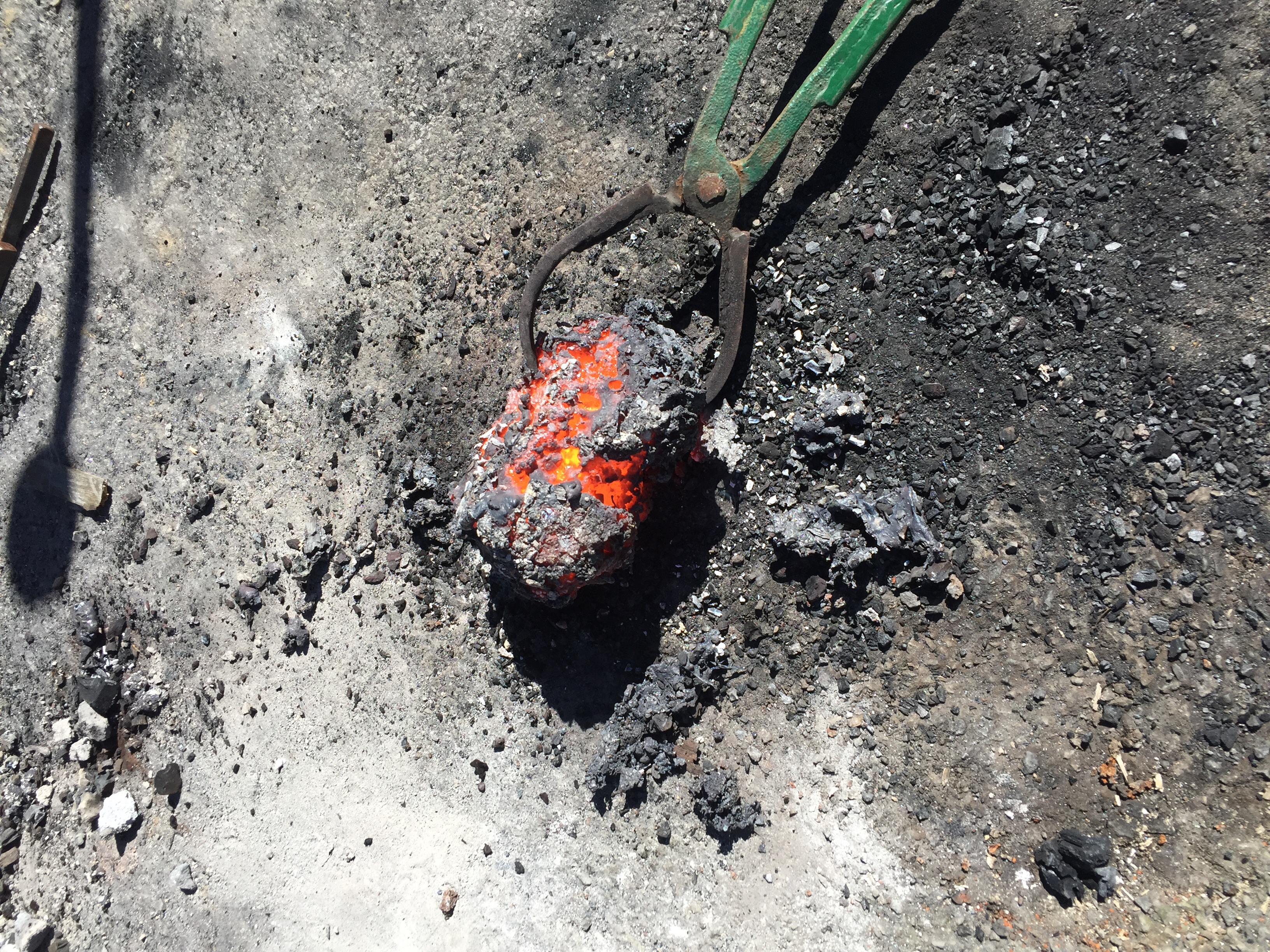

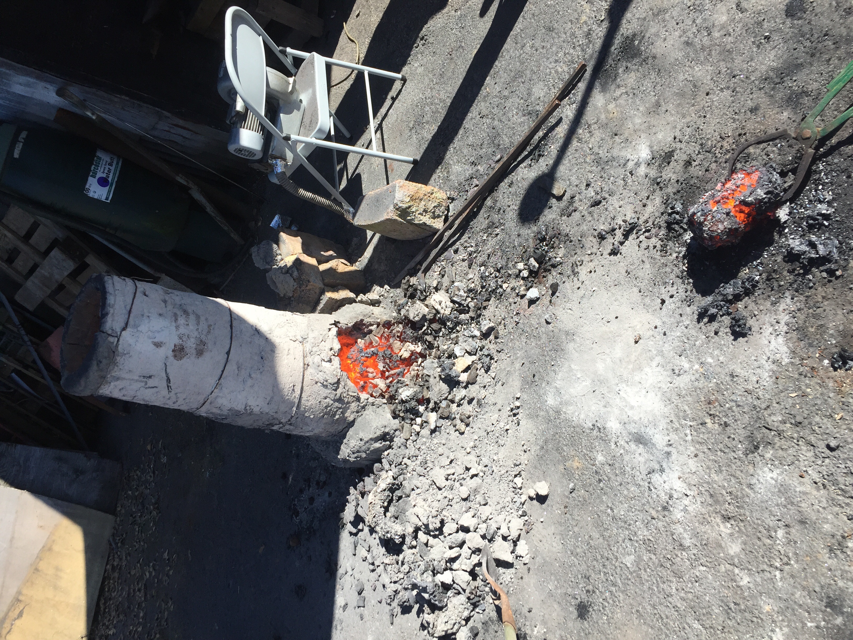

  18. Spark testing was about as sophisticated as we got. The core was the 'student' bloom, which was primarily specular hematite. The skin layers were multiple folds of the bloom we ran under Owens guidance, which was a mix of the hematite and sidarite recovered from a nearby streambed, and the remains of a bloom that Owen had from a different smelt he attended in the states, which all I recall was being higher in phosphorus, so it reads as a lighter grey. The edge metal is estimated to be 'medium carbon'
  19. Thank you, yes I had some difficulty figuring out the grind on that. Very little practice hollow grinding, and that's the first recurve I've attempted. I had access to a 10" contact wheel on a burr king in the class, at home I just have a partially exposed 2" wheel on the top of my grinder, so I couldn't continue to fiddle with it after the fact. Which is probably for the better, as I would have chased that to destruction I'm sure!

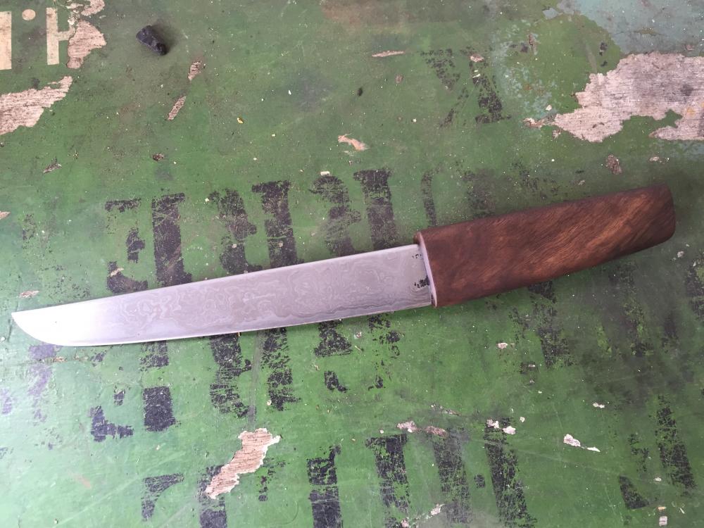

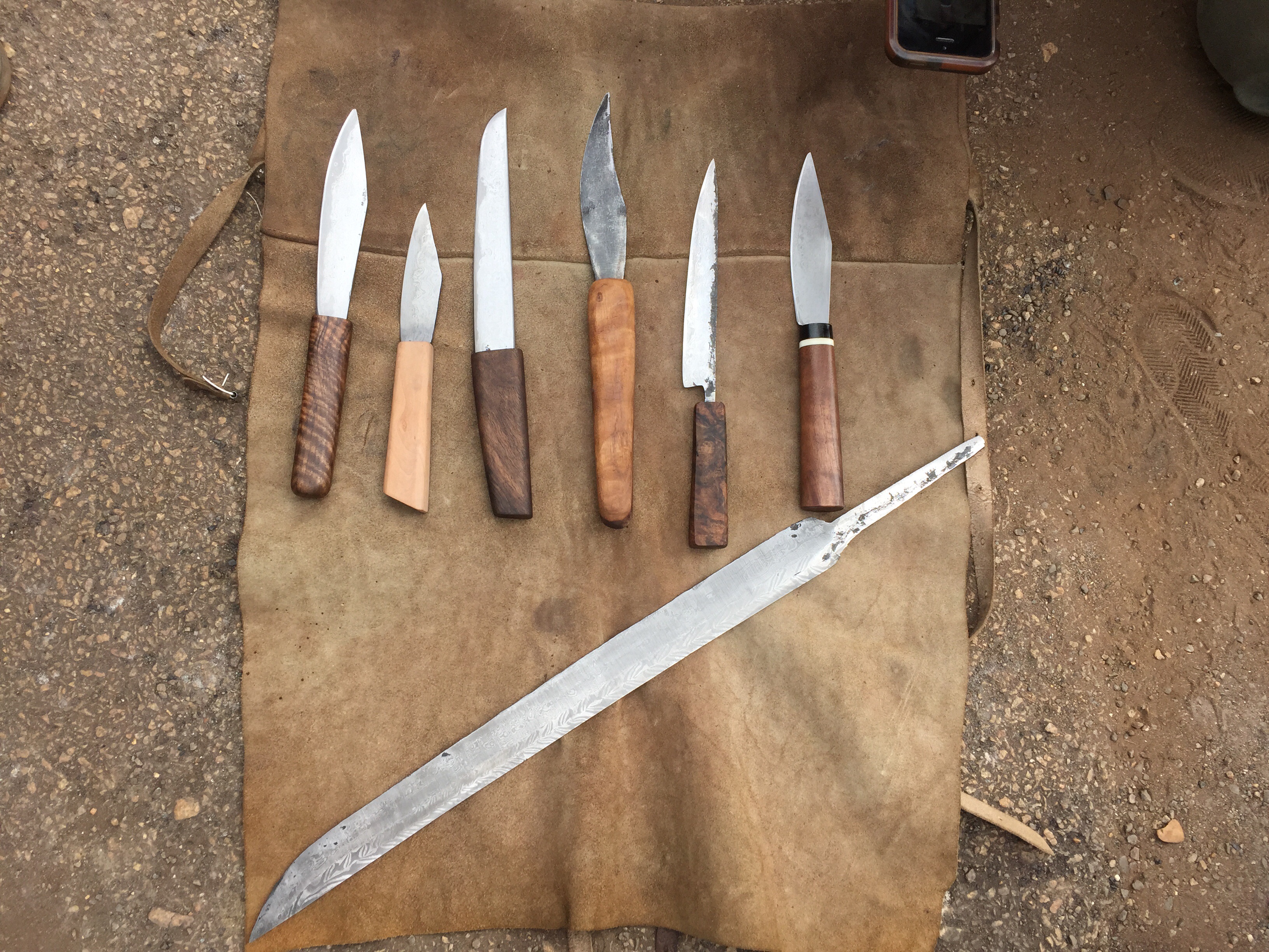

  20. Update! Managed to attend the ore to knife class this past July and it was AWESOME! Ran two smelts, forged two practice blades and a tanto from the bloomery material, gave it a walnut handle. Check it out! huge thank you to Owen for providing such an incredible opportunity! non-smithing related photos removed due to amount of bandwidth to show others your lunch

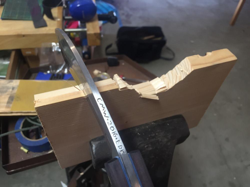

  22. Been dark for a while and I missed the forum have been busy in the meantime though! So this is the second full blade i have completed, figured id share it and see if i can get some constructive criticism. I will suspend 'if you dont have anything nice, dont say anything at all' for this purpose, im already pretty keenly aware of most of the flaws. I was more concerned with actually completing the project and the larger skill concepts, less so with spending hours and hours sanding. The blade was forged during a California Blacksmith Association anual class/event/sub-conference called Waynes World, which is a weekend bender of a class hosted by Wayne (surprise!) at his home shop near Riverside, this year the venerable Tony Swatton was our instructor, teaching us how to forge a wrap around tang handled knife and showed us some pretty neat techniques for wood handles. I have already made some in this pattern from mild steel, and half completed one in W1, so I as usual I wanted to do something over and above the minimum, hence the kukri. I also dont like to have a bunch of the same pattern or role of knives, so the kukri pattern was a first for me, and quite a challenge to forge! The starting stock was 6 inches of 1/4" by 2" new stock 5160 spring steel forged by hand to yeild a 6" blade and 10.5" overall length knife. Big shoutout to my friend Steevens for the Every Day Kukri (EDK) moniker, its big enough to handle most chopping tasks, but small enough to pack along easily. After I make a sheath for it, that is. Took me an hour to drill the holes in the tang, which I stupidly hardened as much as the blade. Heated the blade for HT in an electric kiln so the whole thing was up to temp and I didnt want to leave the tang out of the oil and have it smoking like the devil or possibly flare up on me so I just dunked the whole thing. Ended up submerging the blade in a bucket of water at home and torched the life out of the tang with my plumbers torch to draw the temper back as much as possible or kinda faux anneal it. Managed to punch the holes through after that with a regular bit, but my 1/4" will never be the same again, its *seen* things man! XD The handle scales are purple heart and the liners are a ruberized gasket material, the mosaic pins I bought from Tru-Grit at a knife show, lanyard tube is a simple brass tube. The bead is mostly the same construction, the endcaps are brass sheet metal with two sizes of brass tube that nest within each other with one soldered on to each plate. The center layer is brass and copper mokume, from a billet edge trimming I saved from a billet I forged in a class taught by Jay Burnham Kidwell a few years ago, had to forge it carefully on edge to spread the material wider to match the dimensions of the bead design and the wood. Went with blue paracord to tie the liners together between the handle and the bead. The mokume doesnt read well in the bead right now, its too freshly finished. I can't heat patina it without killing the epoxy or burning the liners or wood, and I don't have much for chemical patina except liver of sulphur, but I dont think I can safely apply that without fouling the rest up next to it. So I'm just going to let it ride naturally, which should show up fairly well by the end of the week. Sharpened freehand on a 220 belt on my 1x42 and stropped on my paddle, it slices magazine paper readily and chops efficiently. Any thoughts or suggestions would be appreciated, thank you and thanks for looking!
