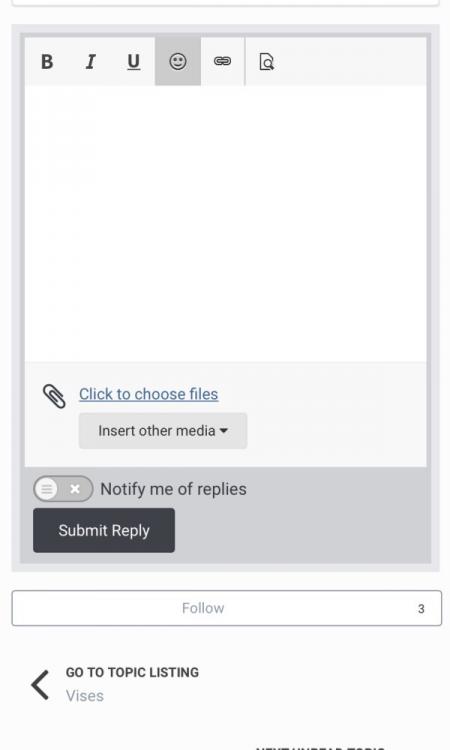

beaudry, do you have (or can you take) pictures?
 I've been searching all over the forum on how to post photos , but haven't had any luck on how to do it.
Can I just click and drag a photo from my Mac desktop and added it to a post ?
Can someone help me out here ?
Not sure if it's the same for you but when you open the reply box there is a paper clip with "click to choose files" beside it. You click that and can add files from your computer.
