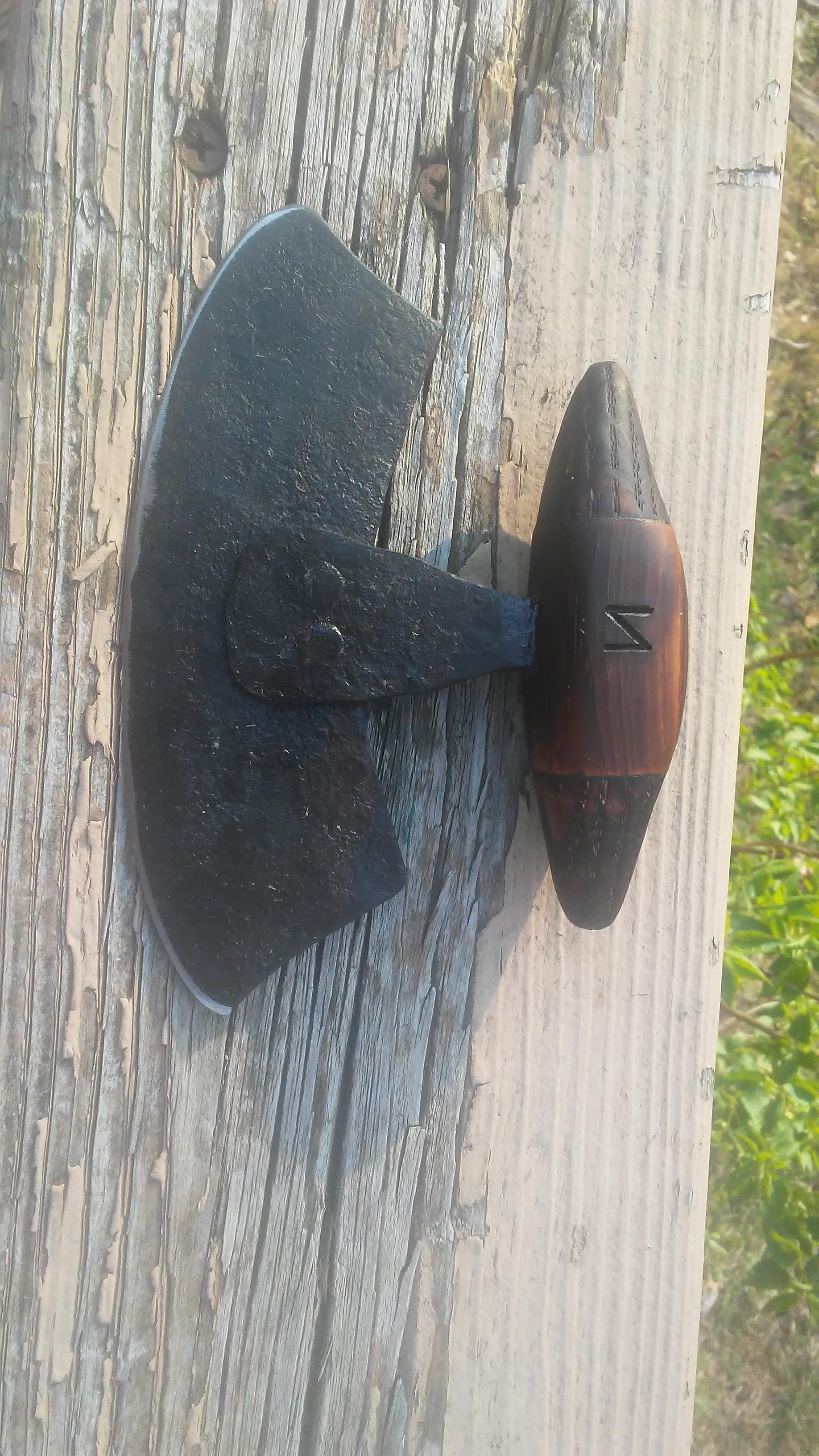

  2. Well I finished the herb chopper for my grandfather. The handle is pine with oak on the sides, I also added additional pitch prior to final burning on and wiped the excess. Feels sturdy enough for the kitchen to me. Usually when i hear someone talking about pitch as an adhesive its in a dismissive tone or "you could do that but i'll stick with 5 min epoxy", anyway thanks for the learning experience!
  3. Many thanks, Thomas, I didn't realize resin was such a pivotal part of a burned in tang, makes sense why traditional Japanese sword handles had a hardwood laminated softwood core.
