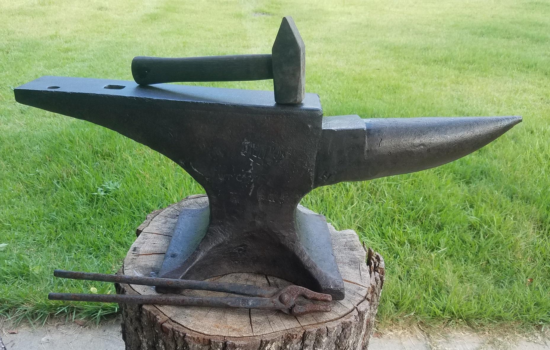

Picked up this 125# Trenton from a guy who bought it to put on his shelf, and discovered the shelf wouldn’t hold it. Paid $3.25 a pound.
She looks barely used, has 85% rebound, and will blow out your eardrums without a chain around it.
Serial is 125 (weight)     218793
any clue as to year? it also has the TREXION typo
