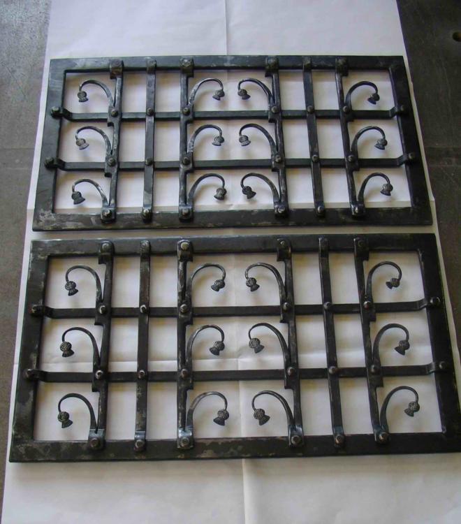

I made a pair of grilles to go over an ugly old radiator. The customer had a Scottish heritage and wanted something with a thistle in it. I came up with a design where I had a riveted grill out of flat bar with bits chiseled off the side similar to one in one of the Cosira books. But rather than just scrolling the bit out I tapered the chiseled off bit leaving a lump on the end , and then mashed that bit into a little thistle die I forged. Drawing out the stock between the thistle and the bar was a pain as it all had to be done by hand over a bridge tool which had to be pretty thin which mean all my hammer blows were very inefficient because of the flexing on the bridge tool. All the flash had to be filed off around each thistle. I was busy with other work at the time and I kept putting off working on this job to do work on jobs i was making money on rather than this one I was losing my shirt on. I finally go it done the customer loved it and brought a plate of cookies as well as the cheque when she picked it up. The picture is terrible it does not show the details of the thistles which I was quite pleased with, they had a raised diagonal checkerboard in the body and fluting on the tassels, and the finish looks blotchy. I lost my curved chisel for trimming the ends of the bars on this job. Spent about 2 hours looking for it and finally made another. That evening I dropped my shirt on the bathroom floor and heard a thump. The chisel had been in my shirt pocket all along.
