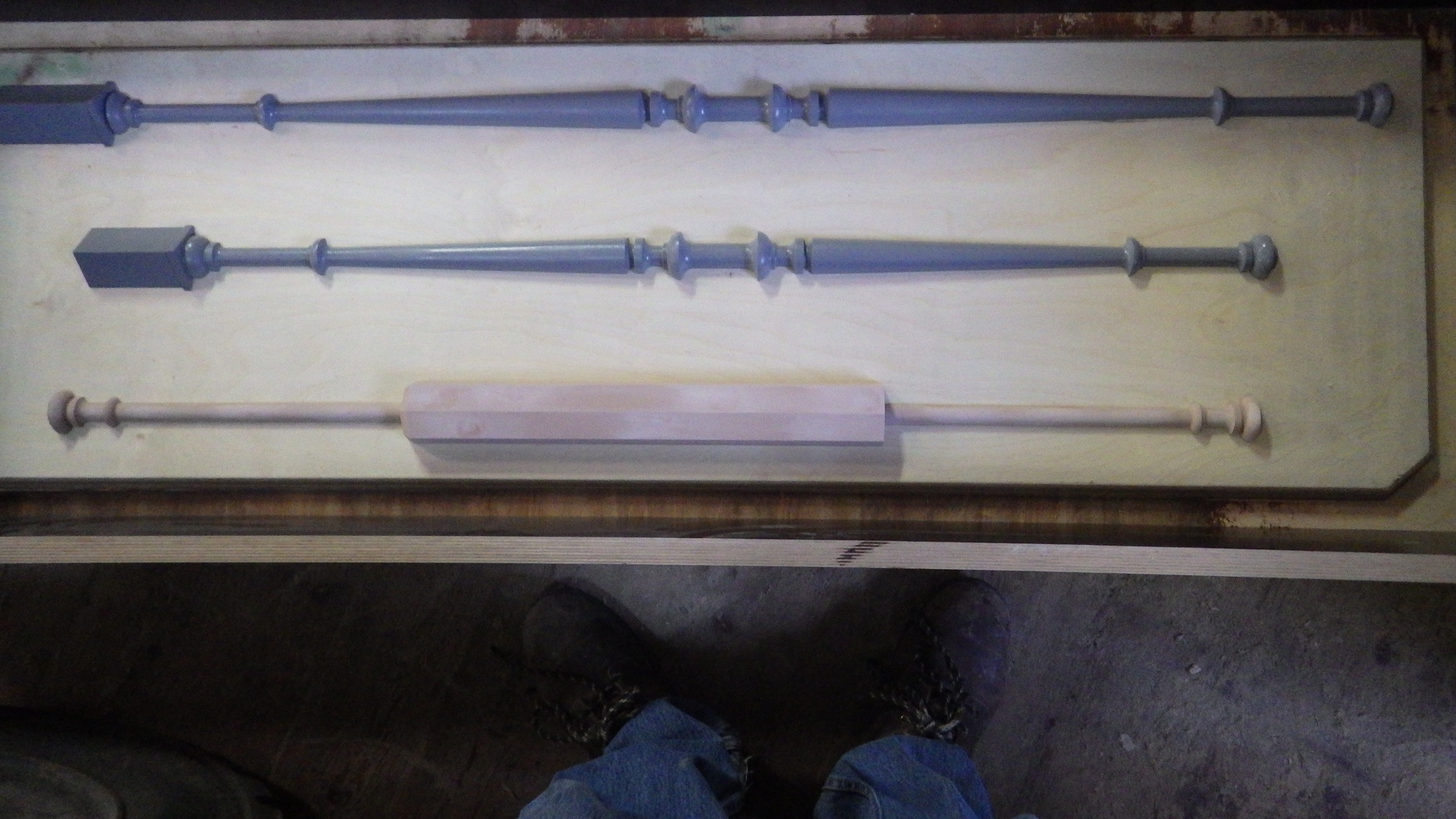

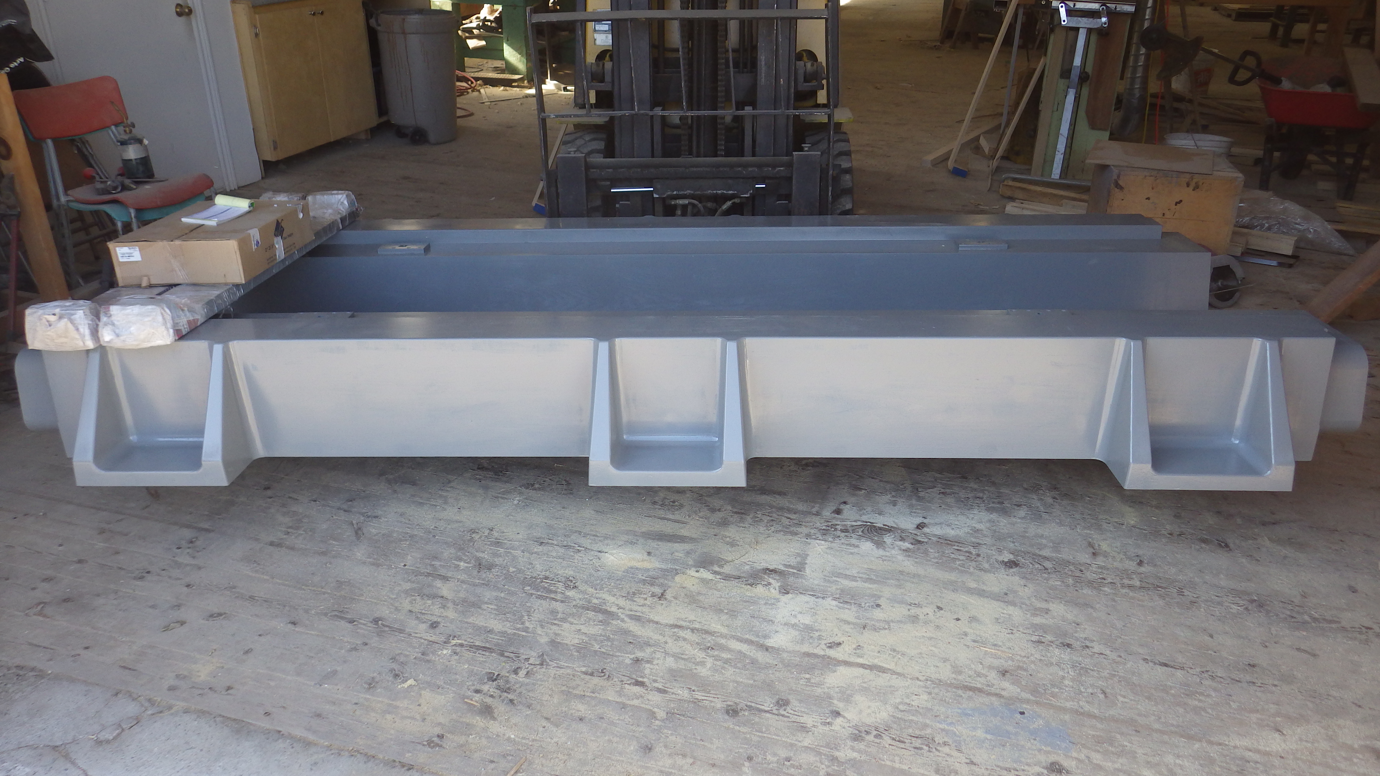

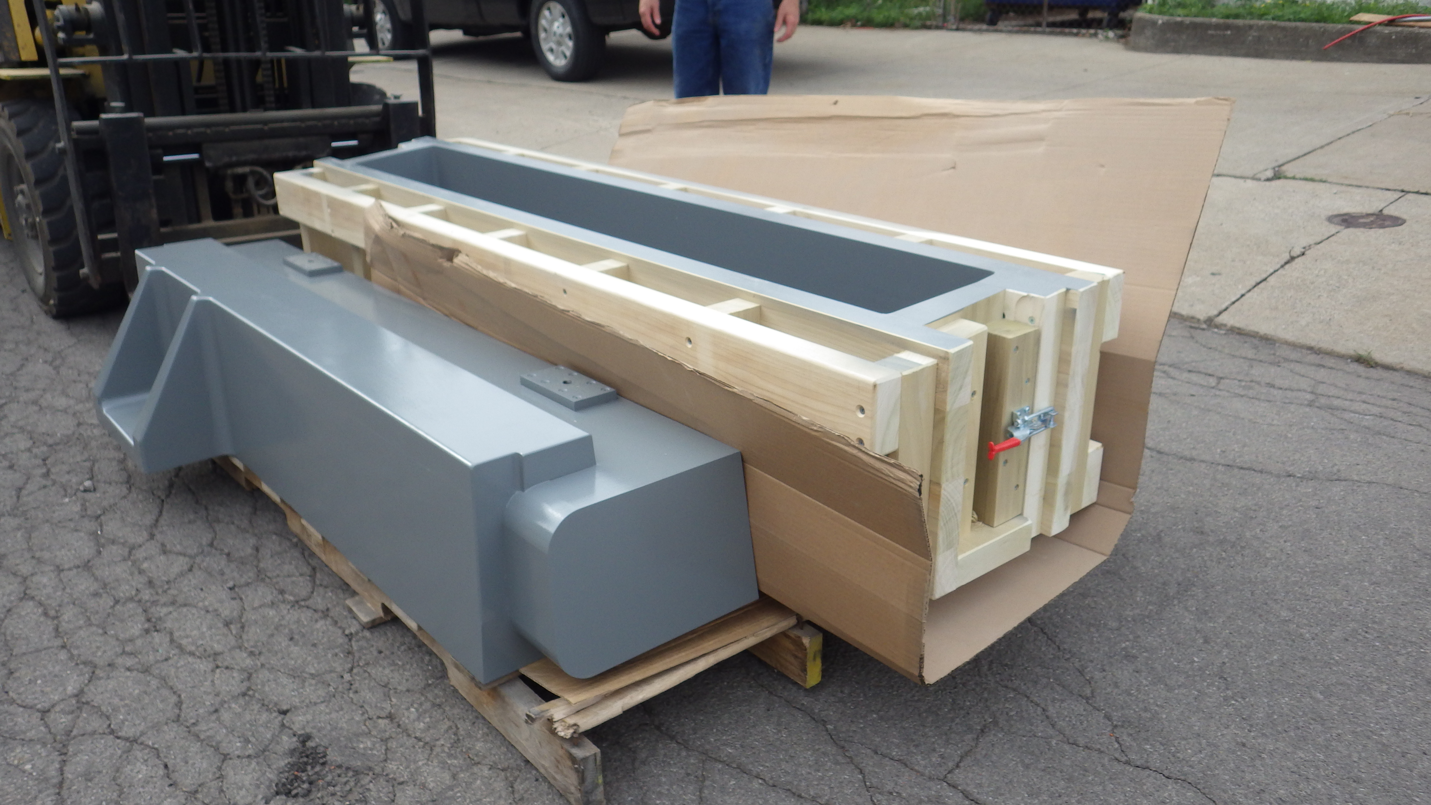

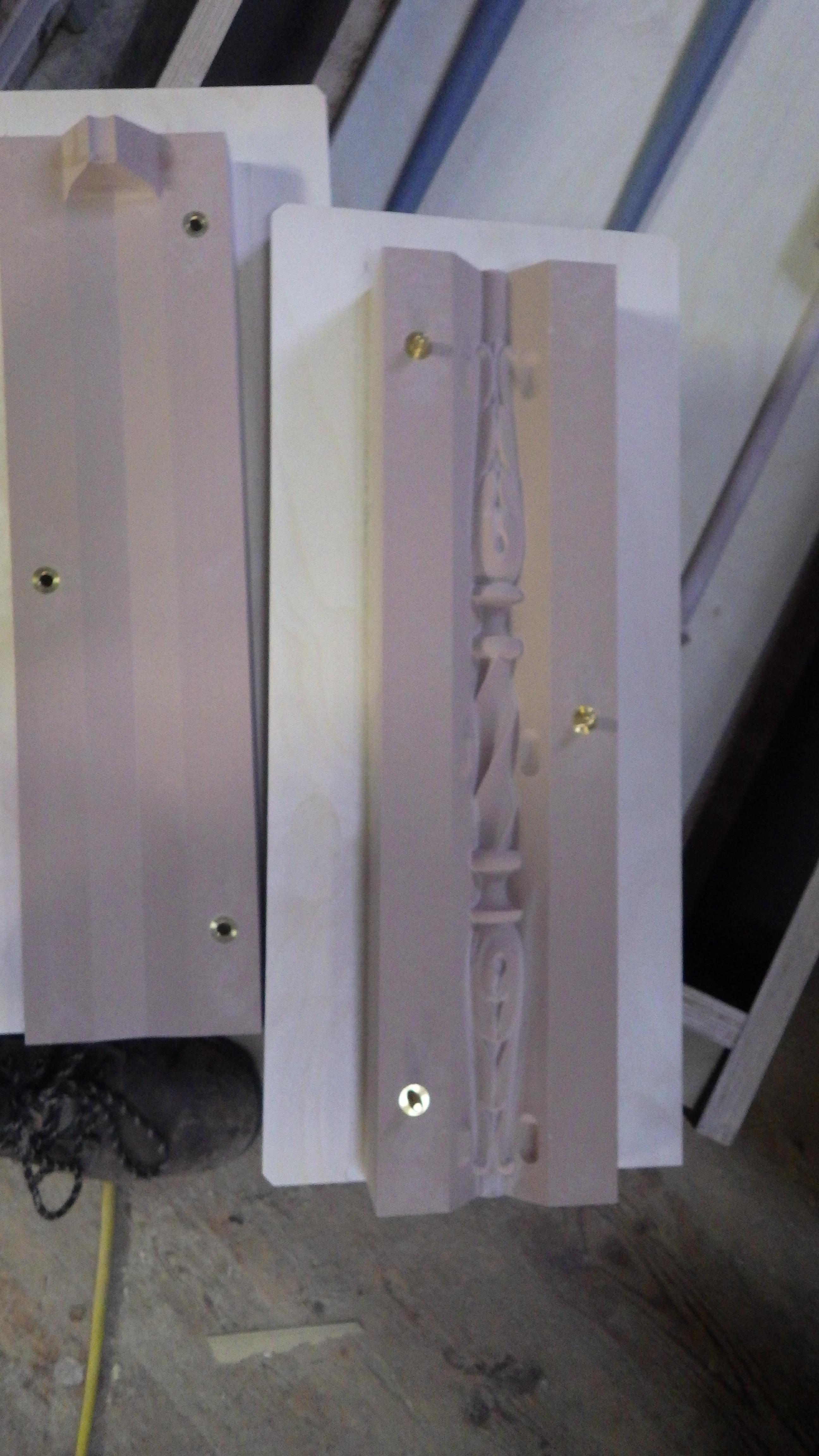

  14. I thought I would post pictures of a few patterns we have built in the last few months. The first one is a loose pattern base for a piece of machinery with the corebox for it sitting inside between the 2 coreprints. The second is a larger version of the first with the 2 follow blocks to go under the coreprints laying on top wrapped up for shipping. The third is a few spindle patterns for a heritage restoration project. The center of the pink pattern is all coreprint. The final picture is the corebox to create the center detail in the center of that spindle.
