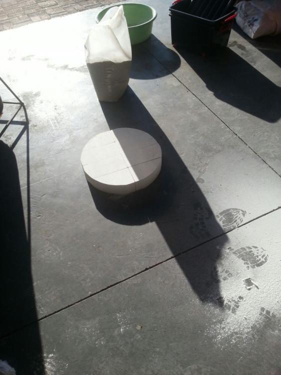

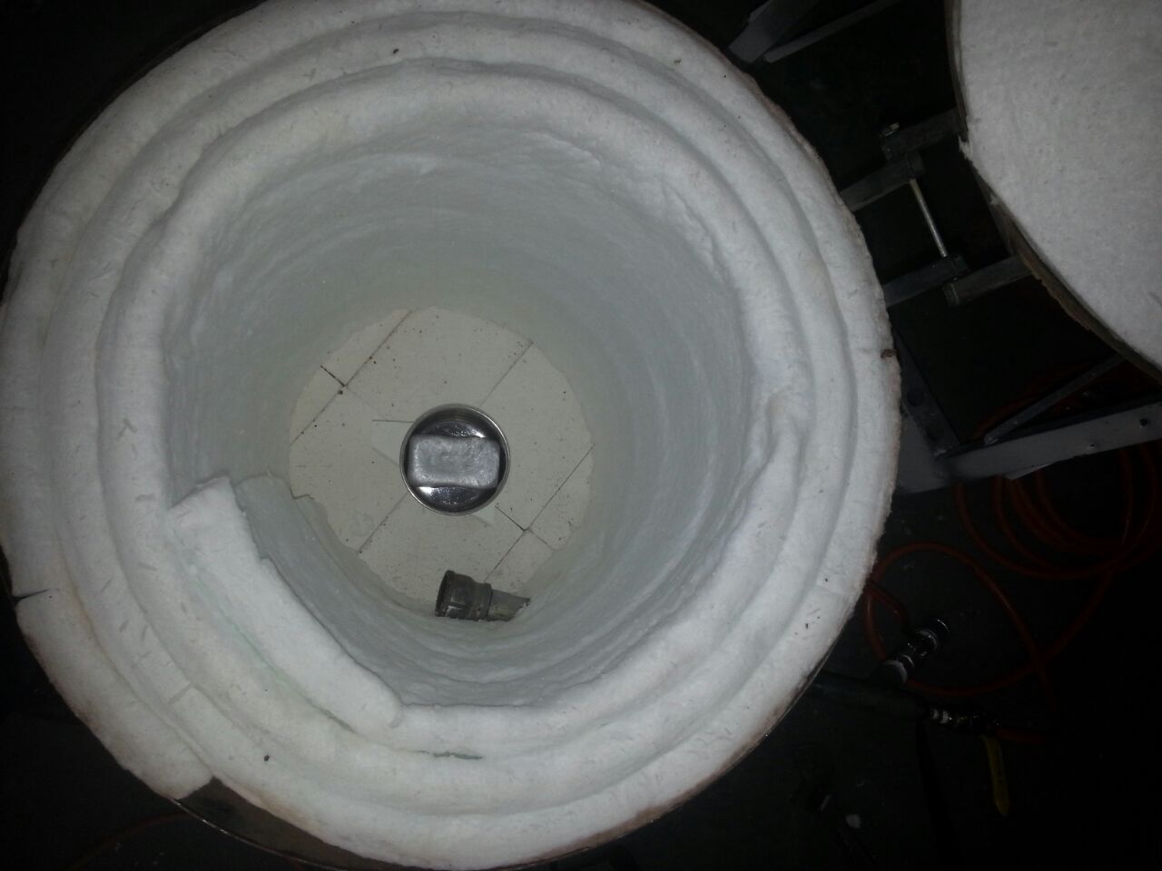

  7. Hi Buzzkill, Thank you for the advice. I hade a discussion with my refractory supplier and he informed me that the ceramic blanket he sold me was a new type (with thinner, longer and more flexible fibres). He said that this new type of blanket should discharge very little if any ceramic particles out the exhaust and that the particles are proven to be relatively harmless. But I ordered the rigidizer as a safe measure and will install as soon as I receive it. Yes the crucible is sitting on a makeshift plinth (refractory brick off-cut) in that picture but I have installed a permanent refractory plinth in the meantime. I forgot to install a drain hole and I will do it before my next firing. I will cut and build drainage channels for liquid runoff and it will land in dry sand (Photos will be posted when complete). On that I still have a substantial amount of silica sand left from my build and also fire clay powder. Your thoughts on those to catch the liquid? Regards

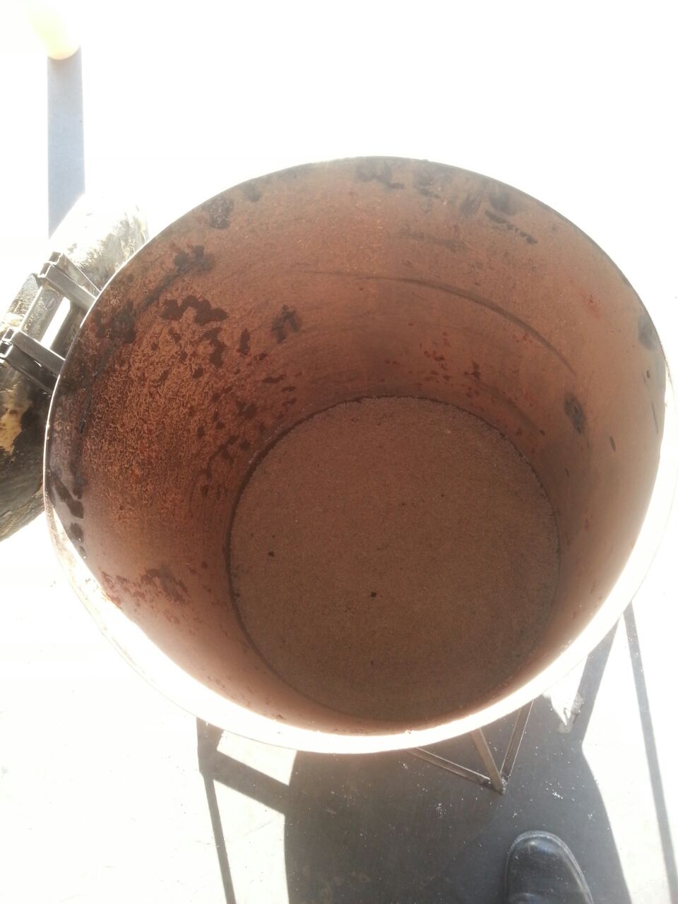

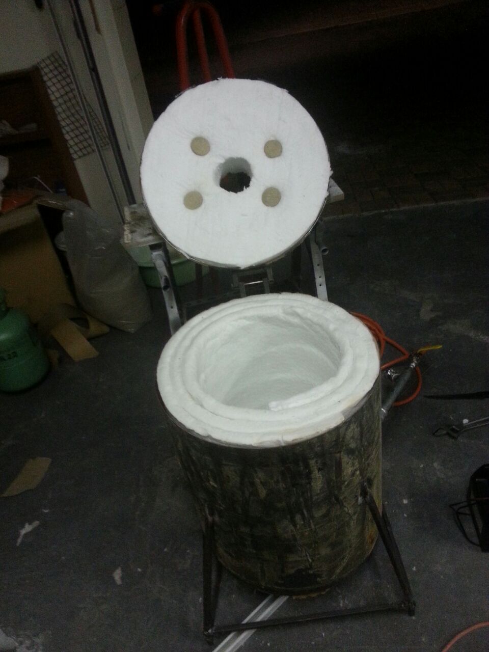

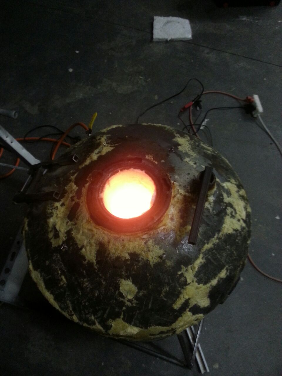

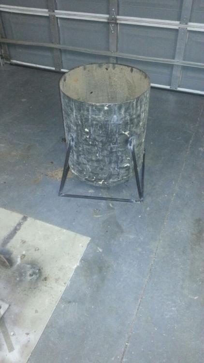

  8. Hi guys, I build a new and improved smelting forge from a old water heater (Giezer in SA). I stabilised the bottom with a mixture of silica sand and plaster of paris to get a flat working base. There after I placed a layer of refractory bricks. Lined the forge with 3 layers of 25mm rated at 1200 OC ceramic blanket. For the lid I stuffed all the offcuts underneath 2 circular pieces of ceramic blanket. This is kept in place by 4 ceramic buttons and filament wire. The burner is something of my own design. I only have butane gas readily available here in SA so after a lot of trial and error I finally got it right to control the gas and airflow accurately. On my initial run I melted an aluminium ingot and realised that my flame is melting my ceramic blanket, therefore I tried installing 2 refractory brick wedges in the path of the direct flame but still keeping my flame in a circular rotation around my crucible (steel in this case) and it worked pretty good. On my second run I tried a couple of brass fittings an old brass ingot which in the end blew up in my face due to phase lock. Don`t worry I was lucky on that one an had learned my lesson. Please raise your comments on pictures added below, I would like to know what you guys think. Regards
  9. jmccostomknives, Not that I was aware of. Frosty, Thanx for the advice and my brass collection made it's way to the recyclingbin shortly after I read your post. I will start collecting bronze instead. Luckily I was wearing the correct PPE at the time. I've got brass blobs stuck to my gloves, apron and face mask.
  10. Hi guys, I had a terrible experience last night. I tested my new furnace and tried some brass ( pipe fittings and an ingot). The pipe fittings melted quite easily but the brass ingot did not want to go. After a while I decided to pour out what was pourable and save the rest for later when I figured out why it did not melt. But as soon as I moved the crucible the ingot exploded sending molten brass everywhere. I cannot find reason for this anywhere and would like to prevent this from happening in the future. Do you guys have any advice?
