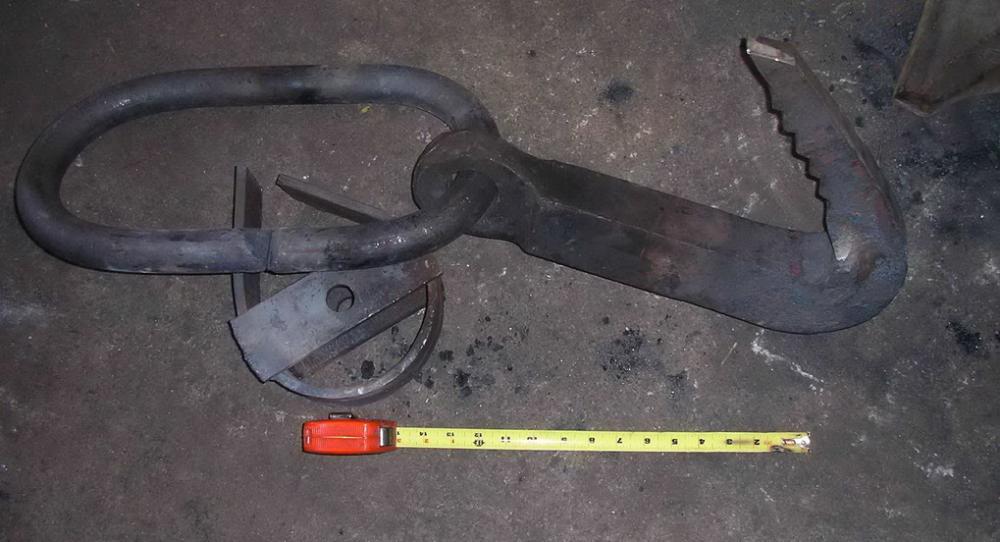

Show Me Your Hooks!
Here is a hook I made several years ago. Not very decorative but was a workout and profitable. I started with 2.5" square and upset a section in the middle of the bar to close to 4" square so that it would maintain the 2.5" section when bent. This was done by hand lifting the bar and slamming down on a piece of 4" plate on the floor. The drawing out and punching was done on a 100lb shop built air hammer, Bending of the hook was done hot with an 8 ton hydraulic press and with a sledge. I bent the link hot on a hossfeld using the bending die shown in the photo.
