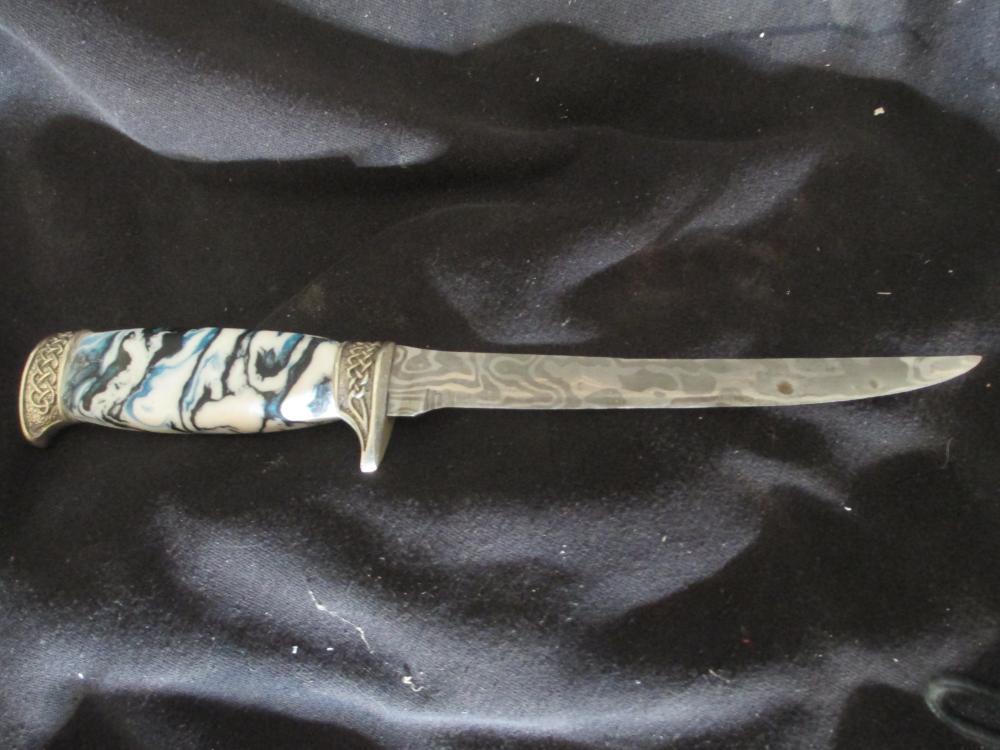

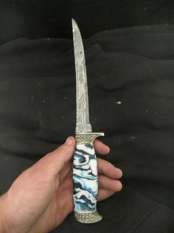

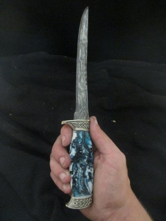

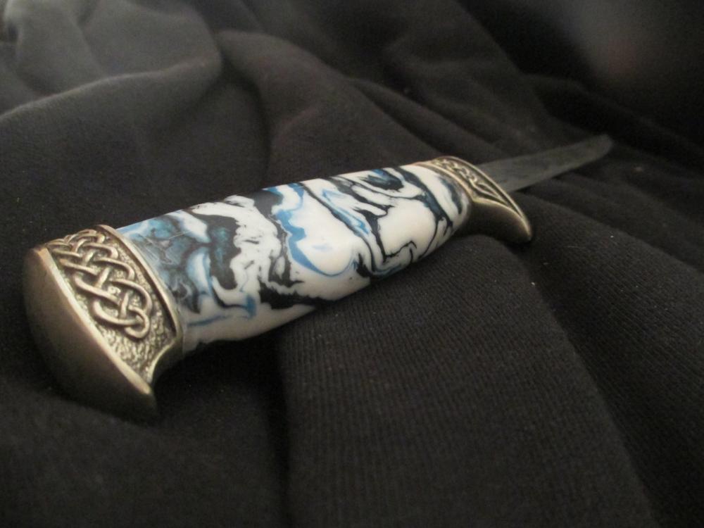

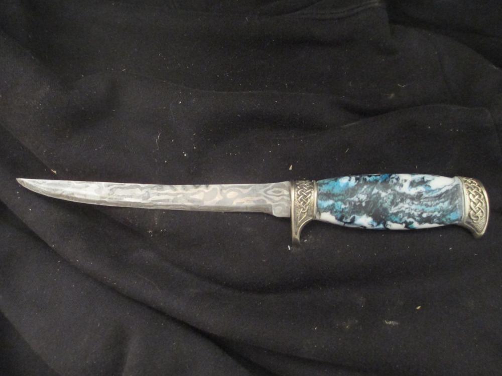

  11. Hello everyone. It's been a while since I've posted any of my work. Recent life events (good ones, thankfully) have kept me quite occupied, but the forge has been busy nonetheless. This knife was a serious challenge. I have never made anything this thin, and thankfully, it all turned out well (with only a slight warp lol.) I was very worried about the integrity of the welds while drawing it out so thin, but they held. Everything besides the steel was of the customers choice. The damascus was forged from 1080 and 15N20. Roughly 30 layers. Etched in hydrochloric acid. The guard and pommel were advertised as bronze, but I believe they are brass. The handle is acrylic liquid inlace, "Frostbite" color. Overall length: 10.5 inches Blade length: 6.5 inches Width: 3/4 inch at the ricasso Thickness: .75 mm, or roughly 30 thousandths of an inch. It is flawed, no doubt. The bevels are short, the pattern could look a little better, and the biggest error of all is right in the edge side of the guard, beneath the ricasso. I just could not get it to line up perfectly and flush (third pic shows it best). The customer is very happy with everything however, so that is what matters. Let me know what you think! Comments and critiques are, as always, very much appreciated. A close up of the guard: And an artsy one, for the road
