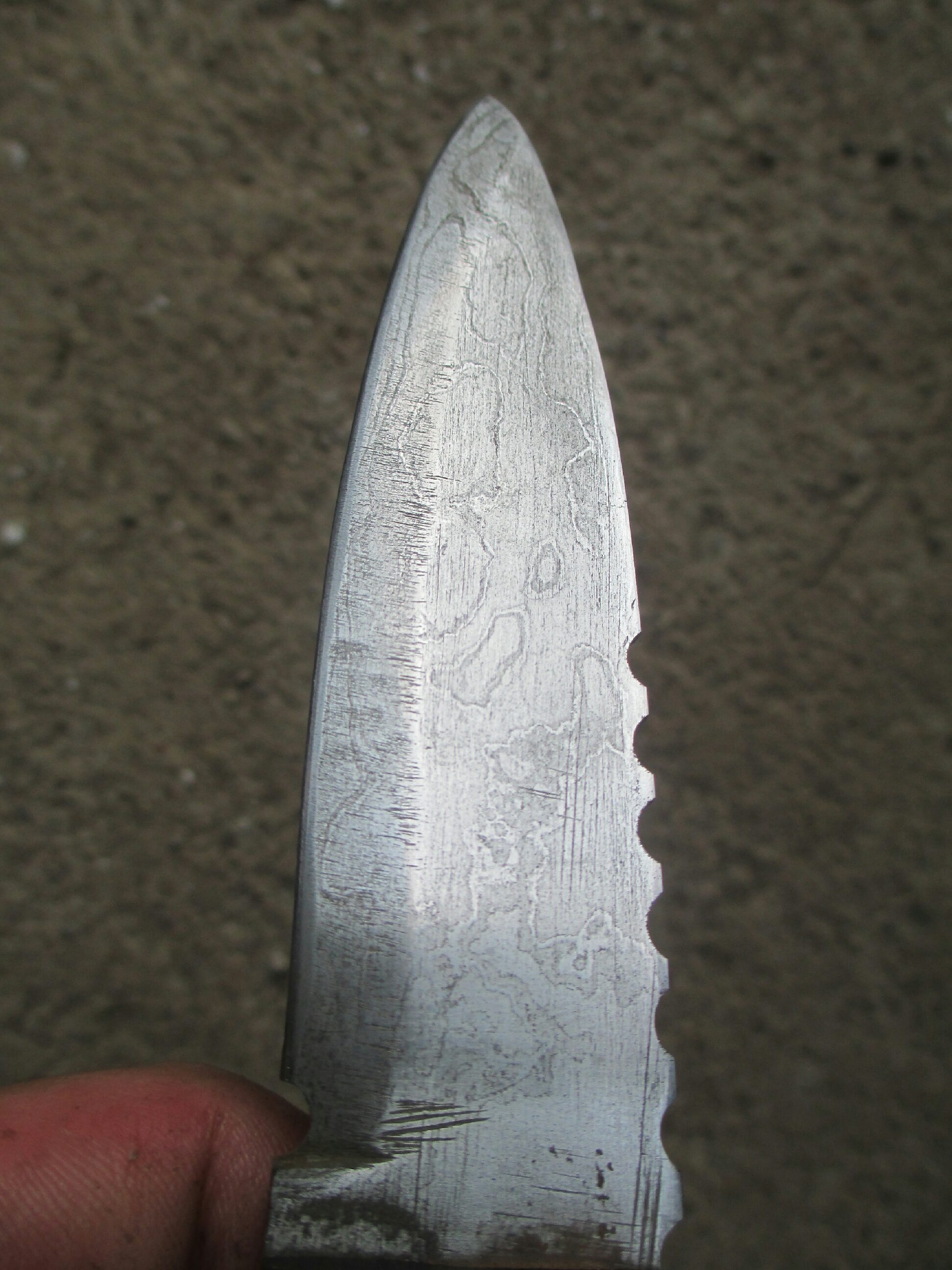

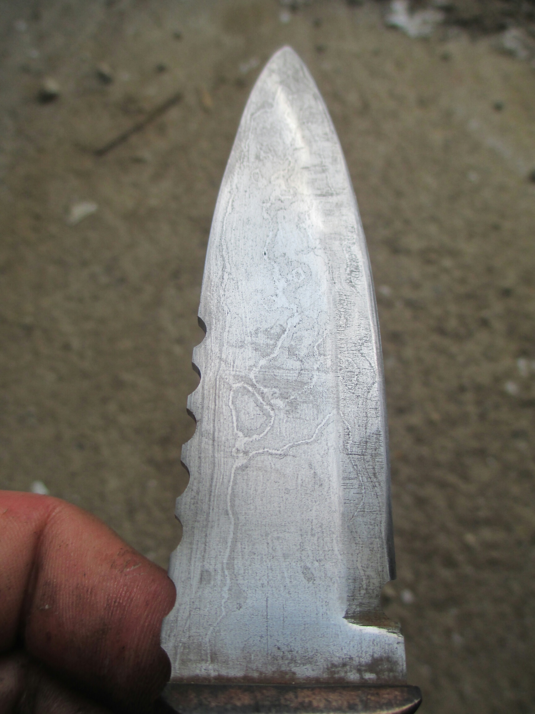

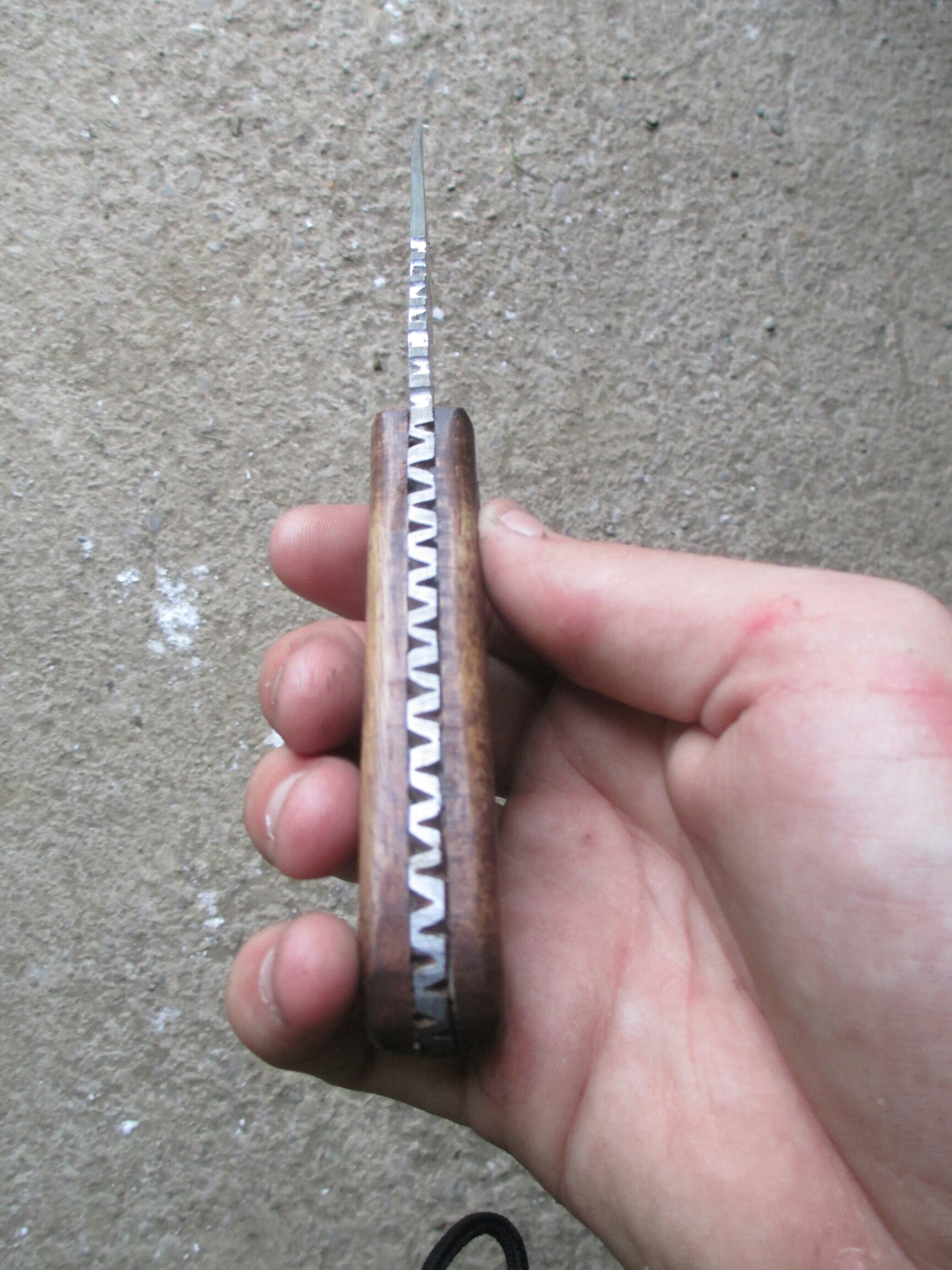

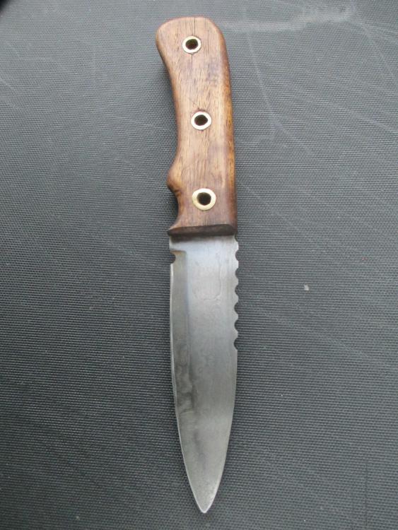

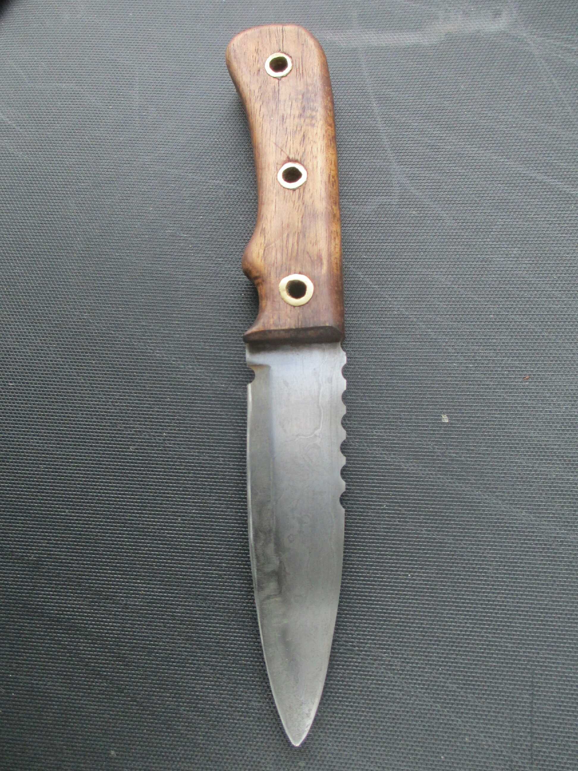

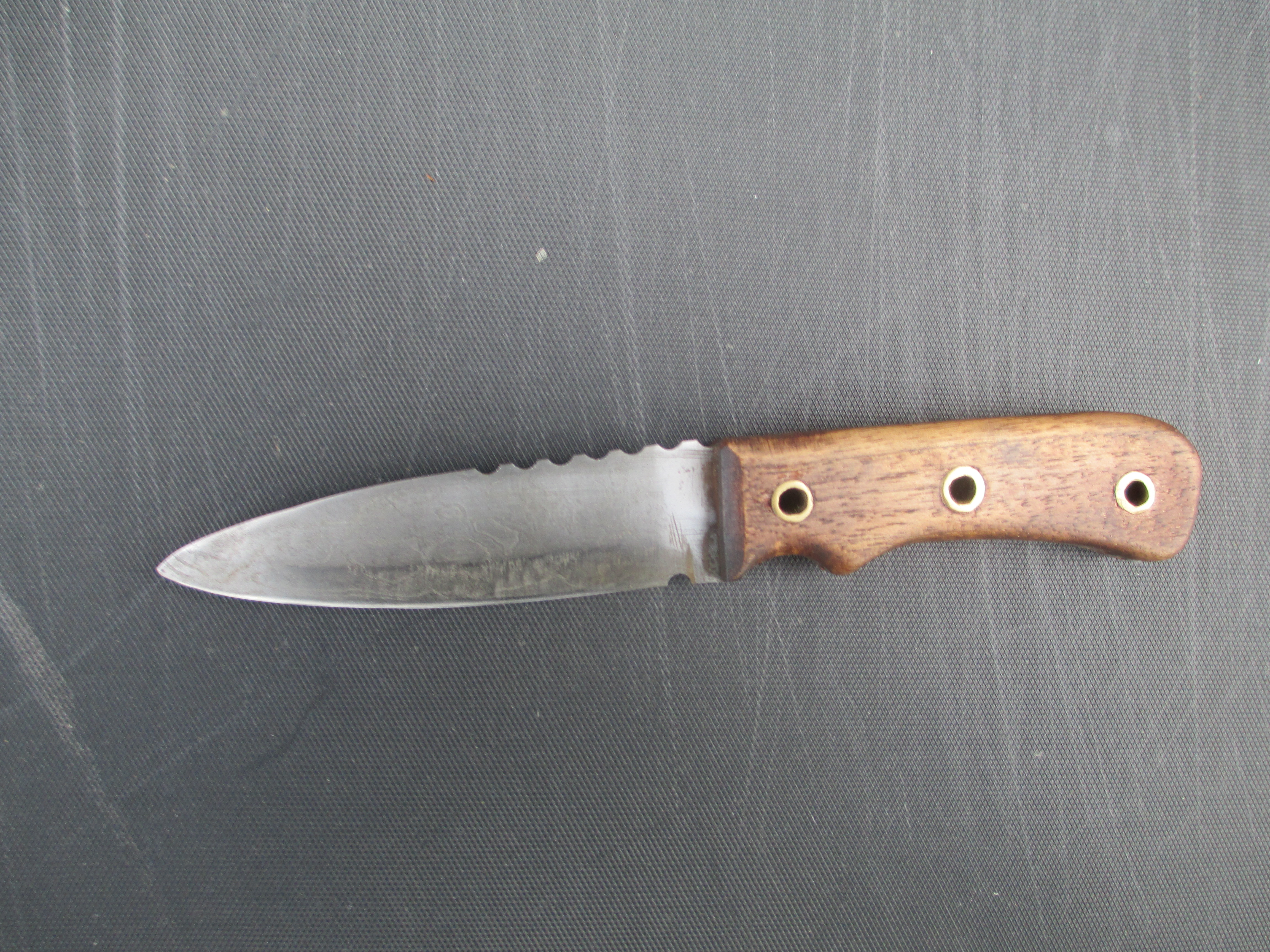

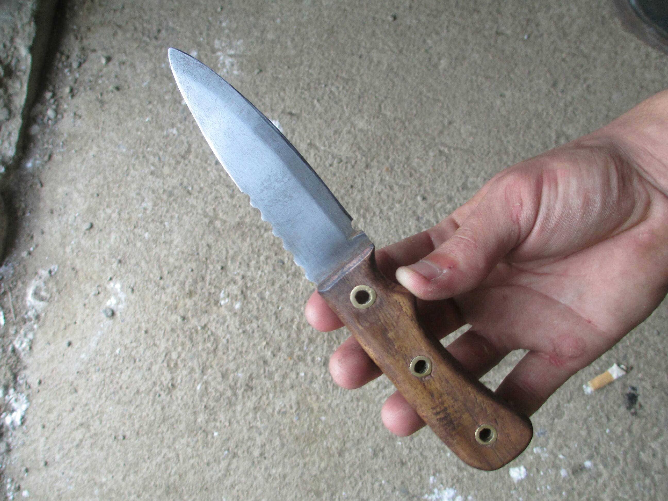

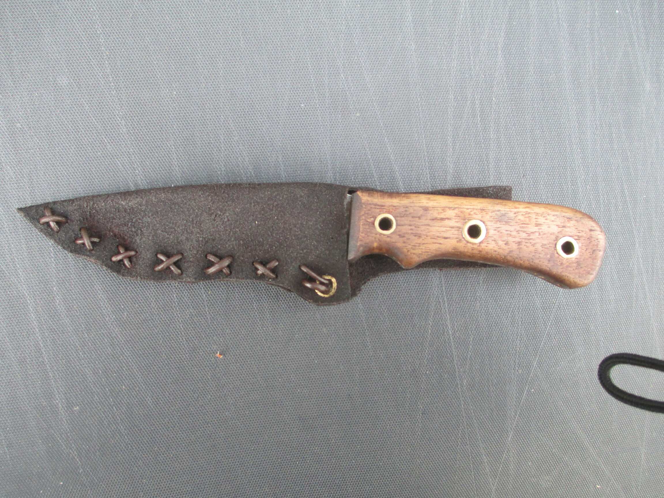

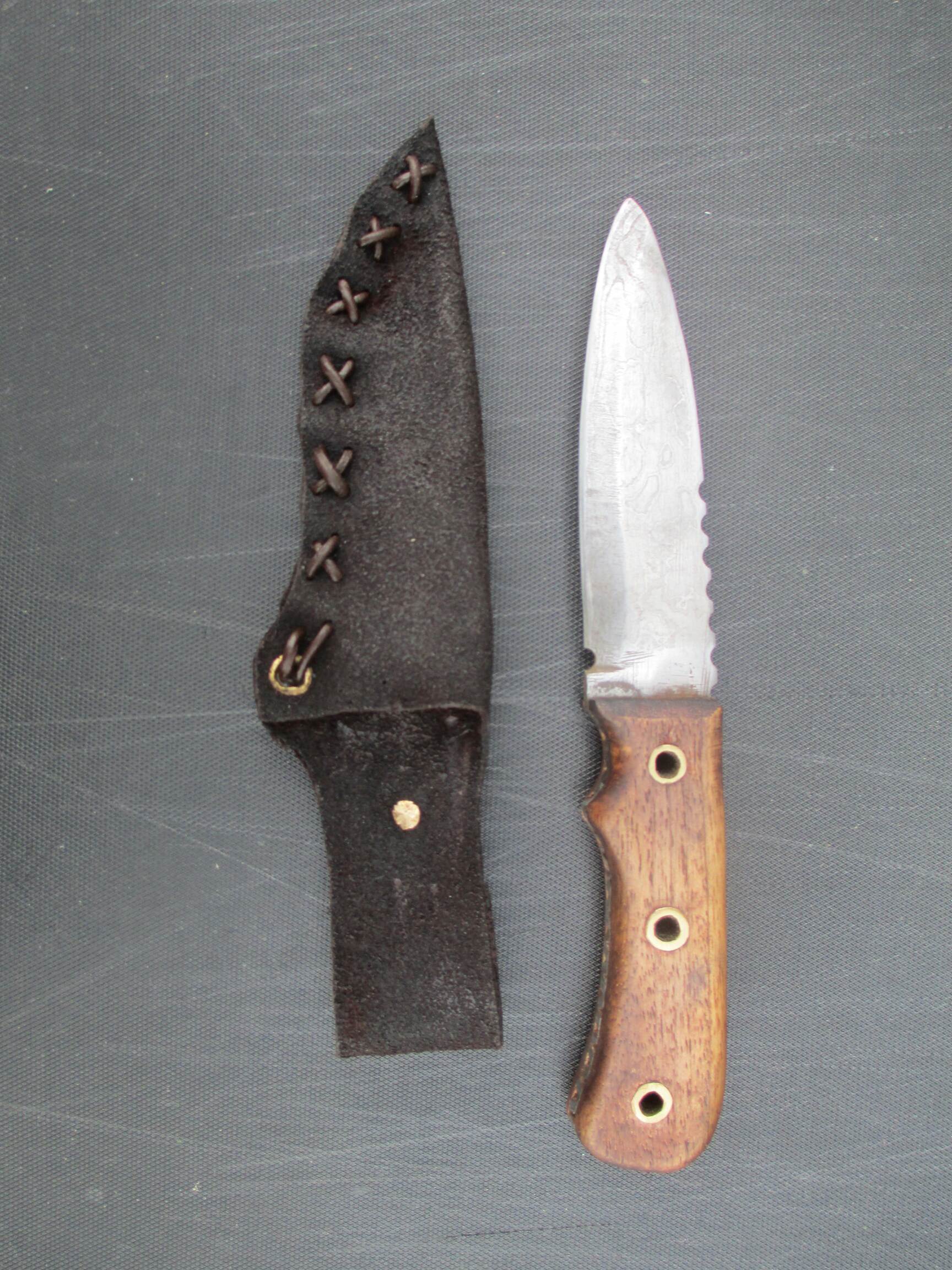

D.IVO First off, thanks for the honest reply. I agree completely about the file scratches. Thats all I can see when I look at it. I simply didn't have time to take them out, I finished everything up the same day I gave it to her. She absolutely loved it though, and said it will be put to good use, so I'm happy. Regarding the bend in the blade, I assume that something happened with the photo to make it appear that way. I realize that sounds silly and like im trying to deny that i did something wrong, but I feel like I would have noticed that when I was working on it, but I noticed no such thing. Perhaps it slipped by me, though. Wouldn't be the first time. I tried to polish it as well as I could without taking away the decent pattern I had (or hiding it, rather.) I have little experience with pattern welding and etching, in truth, so I'm not extremely familiar with getting the patterns to look good. I learn a lot every time. Thomas Now that's a lot of birthday knives that need to be made.
Hello all. This knife will be going to my sister-in-law for her birthday. It snuck up on me so I had to rush a little bit, and my work suffered a little. There's still some grind marks and file marks that I wish I could have worked out. I made the Damascus for this knife using 1/8" 1080 and the highest carbon pallet strapping I had (still a pretty low C content. ~1/16" tested using quench and break method) alternating 1 layer 1080 and 2 layers pallet strapping up to 16 layers, welded and then folded a single time for roughly 32 layers. I potentially could have folded again, but it was thin as it was and I didn't want to press my luck. The pattern is not as drastic as I was hoping for, but it looks better in person than the pictures show. 8" overall with a 4-1/4" blade. White walnut handle, stained "sedona red" with 1/4" brass tubing pins. Im not exactly sure how well the tubing pins hold by themselves, so i was quite liberal with the epoxy. Quenched at ~1600° in vegetable oil and then tempered at 375° for an hour. Despite the lower carbon content from the pallet strapping, it hardened up pretty well. Etched in muriatic acid. The file work goes all the way around the tang. The sheath is leather. The leather was very pliable and... "Floppy" for lack of a better term. I hardened it by applying melted beeswax, and allowing it to soak into the leather and solidify. This also colored it nicely. I am no leather worker, and my stitching shows. I used leather lace. I couldn't figure out how to end the stitch however, so I put an eyelet in (also brass tubing) and put both threads through before tying a knot on the other end. It looks a little odd, in my opinion, but I'm satisfied with it. Anyways, thanks for looking! Comments and criticisms are welcome, as always.

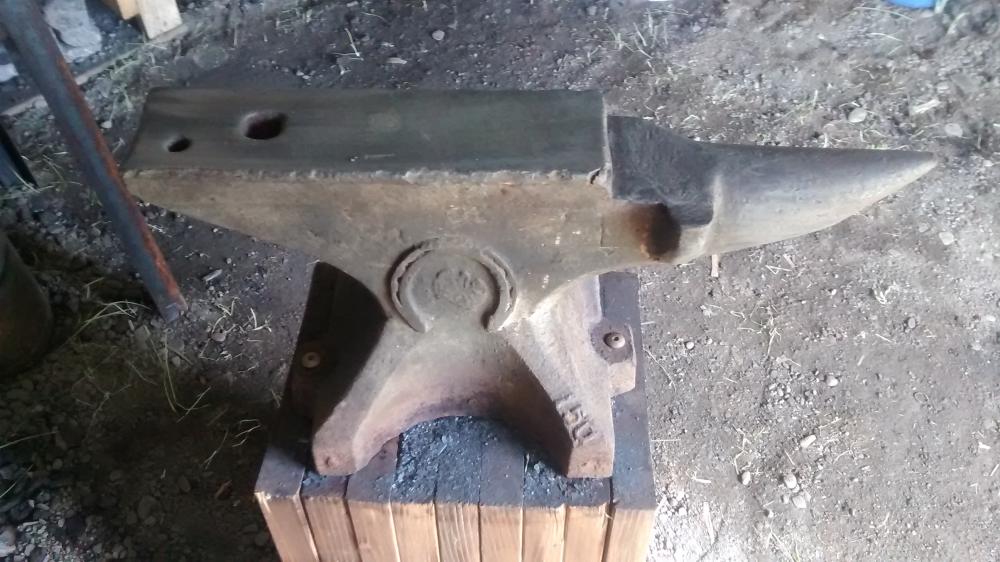

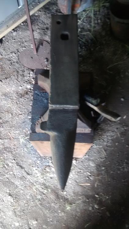

Interesting. Thanks for the replies everyone. Couldn't one just use the edge of the face for the same purpose though? Why cast in a whole separate section? Unfortunately my internet is being weird and won't let me view the video... Das This baby is (hopefully) going to stay with my family for generations. One day my great great grand children will be able to look at a 250-ish year old anvil and wonder what has been made on it before their time, just as I do now. Just realized someone commented on a thread about the same thing I asked and brought it up right underneath my thread. Oops. Sorry for the repeated content. -
Hello fellow anvil enthusiasts. This is my 150# Fisher Farriers anvil, Circa 1905 (date is on the underside of the heel) I love the thing, its a fantastic anvil in my opinion, and I got it for a steal, so I can't complain too much. However I can't see the purpose of that little "nub" to the left of the horn in the second picture. I've been forging almost daily (it's not an addiction, I can quit any time I want!!!) for going on a year and a half, and I have never once had to use it. Ive tried to use it before, just to figure out its purpose, but in almost every situation, there is a better spot to use. The top is flat with sharp-ish corners, and then its round going downwards, and slowly tapers towards the bottom. Perhaps it's a farrier thing? What are your thoughts? Thanks.
