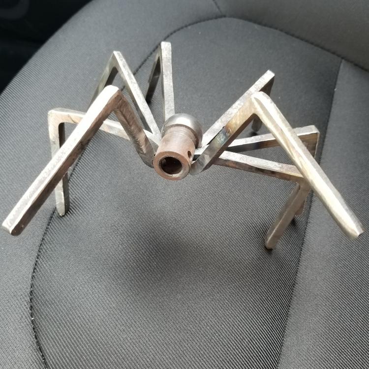

  23. Angle cutoffs plus broken clamp equals new shelf friend. I think he needs a little "Free Hugs" sign.
