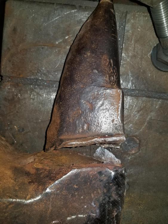

  13. I'd be tempted to stamp any anvils I owned with a custom touchmark. That way I can ID them if they show up online, and it's doubtful the thief would know what it's for and so therefore try to obliterate the mark. Show up to the sale with the stamp in my back pocket.
  14. If you end up building a rectangular/square brick structure out of these, note that they key into each other rather well if you rotate every other one 180 degrees. (Front side out, then back side out, then front again. Repeat.) Of course, that'll depend on whether you're concerned with keeping only the front faces out or not.

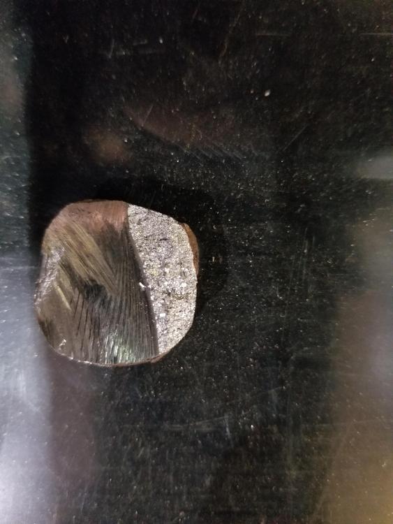

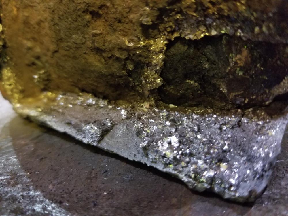

  15. This is off the tip of the horn of the anvil pictured above.
  16. .... does this look like wrought to you guys?

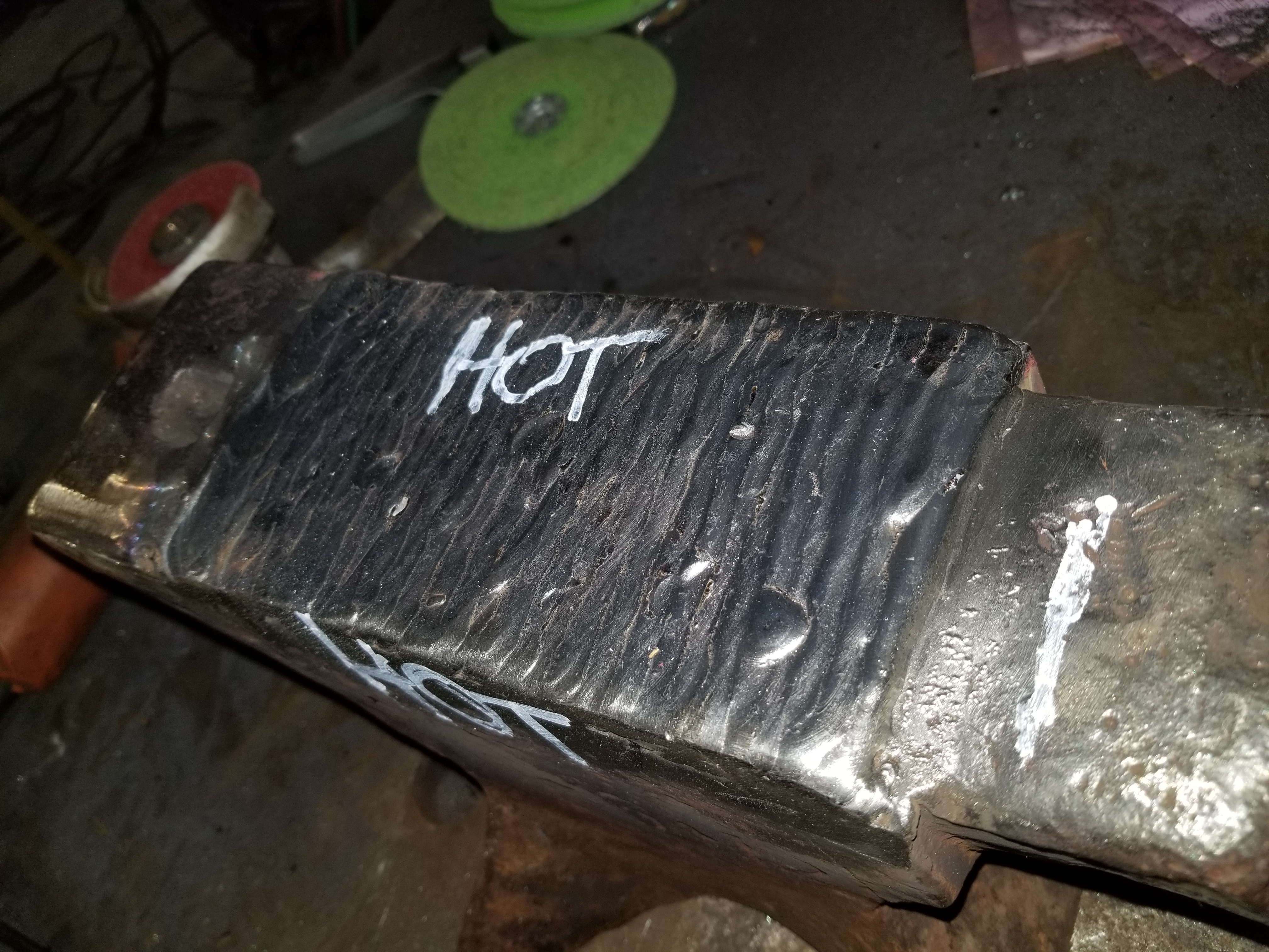

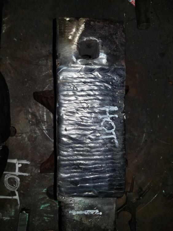

  18. So, my project is on hold for a little bit folks. I totaled my car on Monday and I'm too sore to be doing much grinding. Which is just as well because I haven't gotten the wire ordered in yet anyway.
  19. You're saying that hardness matters, but only for tool longevity. But by saying this, you're actually saying that deformation of the anvil in fact occurs, and energy is really spent in cold forging the anvil surface using the inferior tools of a red hot struck tool and a hammer. Your argument isn't that this doesn't happen, just that it doesn't happen enough for modern smiths to worry about. Which means, for sake of argument, impact resistance, hardness, and, by extension, the ball bearing rebound test (which is a means of measuring hardness), actually does matter. I think 'throwing the hammer back' is just a colloquial way of expressing the increased return in efficiency in a way that is potentially misleading.
  20. Yeah. I appreciate your analogy re: glass on foam rubber. To be honest, I was coming to similar conclusions based on my original research -before- I followed advice from a gentleman with abrasion resistant hardfacing experience; since we're talking apples and oranges, though, I can see where I went wrong. I had a nagging suspicion leading up to it. Should've trusted my gut more. Any issues with doing a proper build-up directly on top of what I've done? My concern is the intact old top plate around the hardy hole.
  21. That's the problem. I have an air peener but as far as shot blasting goes, all we do is abrasive blasting at work. I'd have to send it out. I'm also looking at Stoody 965. Good impact, good abrasion, no cross checking. 50-60 HRC as deposited. Or I could probably just get some 1105 ordered in.... I'm just less confident in my stick welding (I have gotten far less helmet time in with that process) which is why I've been looking for a comparable wire.
  22. See, I'm curious. Stoodite 21-M sounds intriguing. According to the manufacturer it's a work-hardening wire that hardens up to 45 HRC, no cross checking, unlimited number of layers. Used for forging dies, hot shears, and piercing plugs.

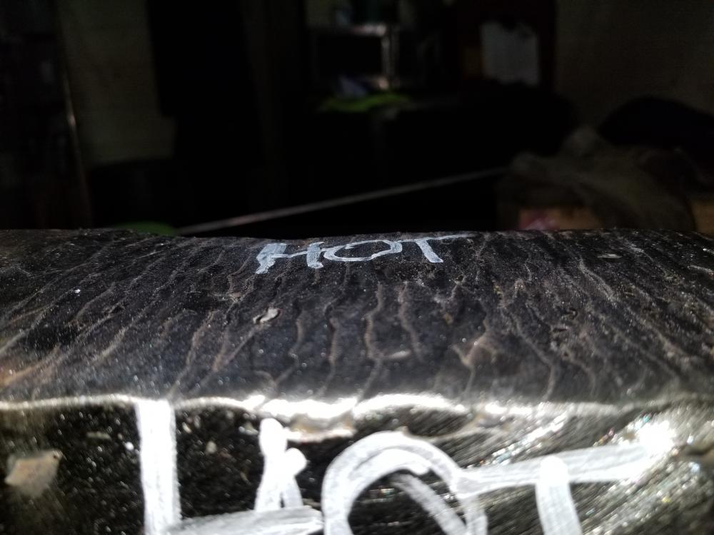

  23. $0, but government jobs are an amazing perk at my place of employment. I'm keeping rough track of what I use, so I may have a ballpark figure once I'm done.
  24. Straight labor, not counting research time, I'm 8 hours in and not half done yet.
