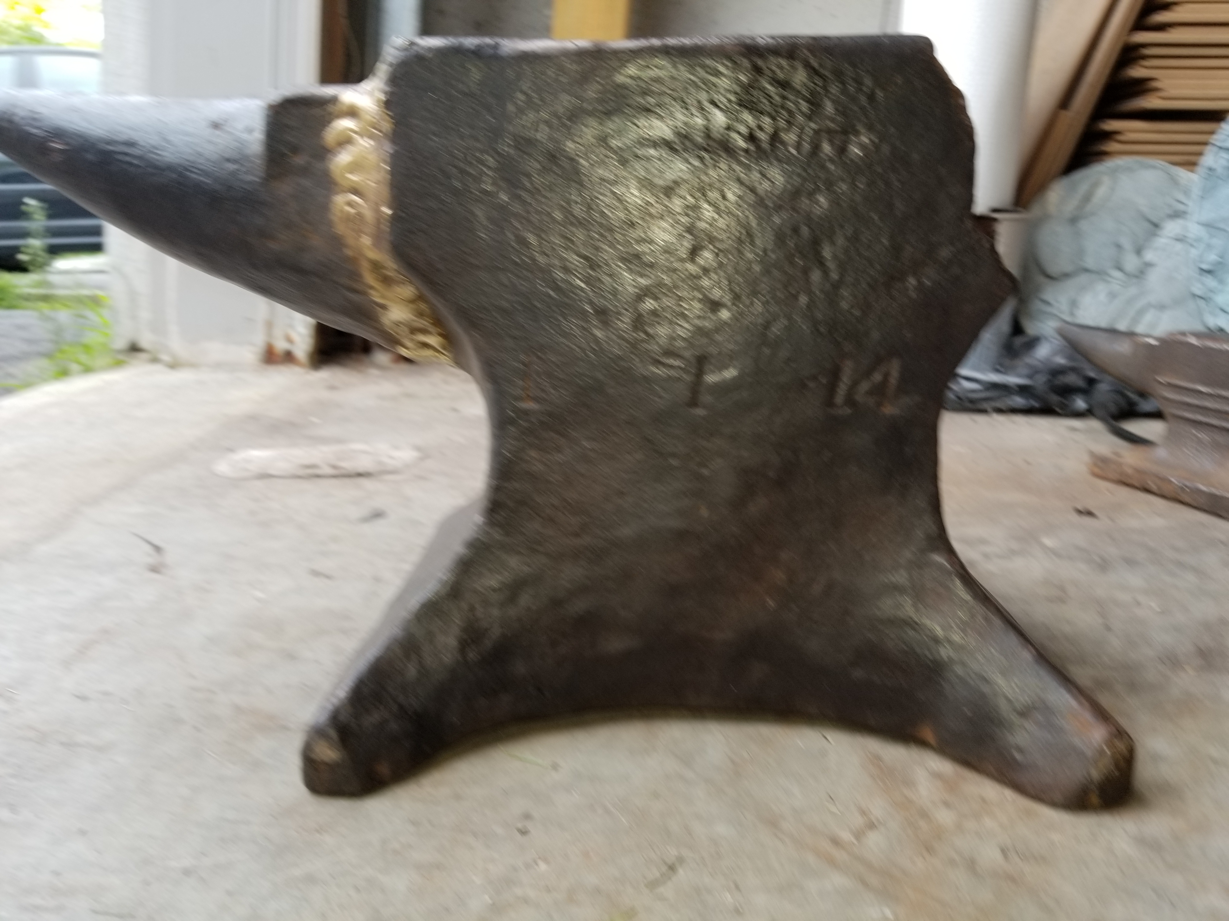

One somewhat blurry post-cleaning shot. I think she's got character. And a bit of bling in the shined up braze job.

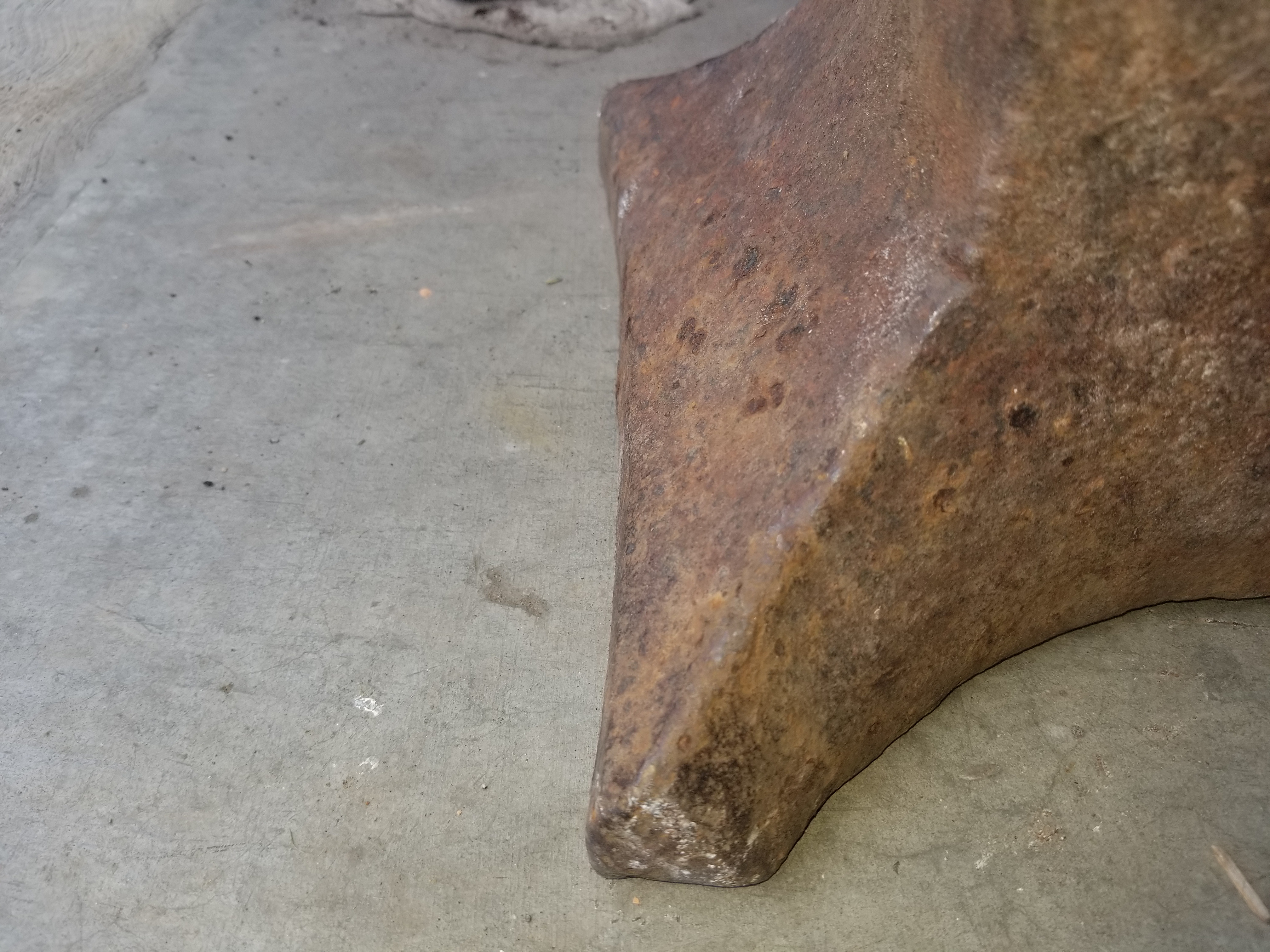

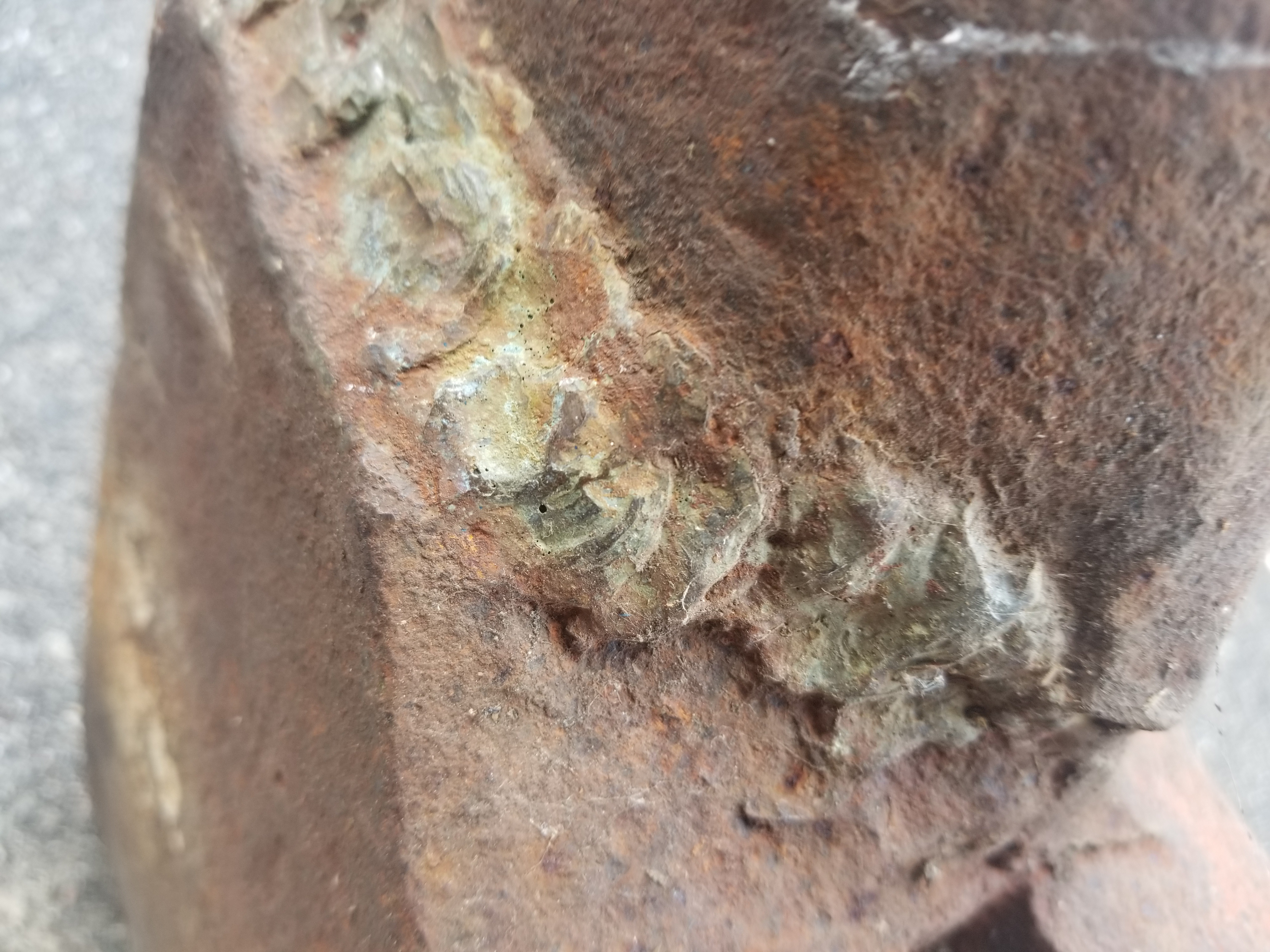

So update: (pictures forthcoming soon as I can) Horn is, as I suspected, brazed rather than welded back on. The only further letters I can make out on the maker's stamping are what looks like "ENNITT" The welds themselves are dead soft but the area around them doesn't seem to have suffered much. Ground to just about flush. Recommendation on cleaning up the section where the heel broke off? I'm concerned that with time bits of the face may break off near the fracture line and become shrapnel. I figure at a minimum eliminate any potential points of failure and radius out ledges and so forth

I'd take something more aggressive than a flap disk to it until you get through all the kerf lines from the torch cut. Then move to lighter and lighter abrasives until you're happy with the finish. Go to a pretty aggressive wheel to start, IMO. You'll be at it for ages like that. And unlike an anvil, there's no top plate to worry about damaging.

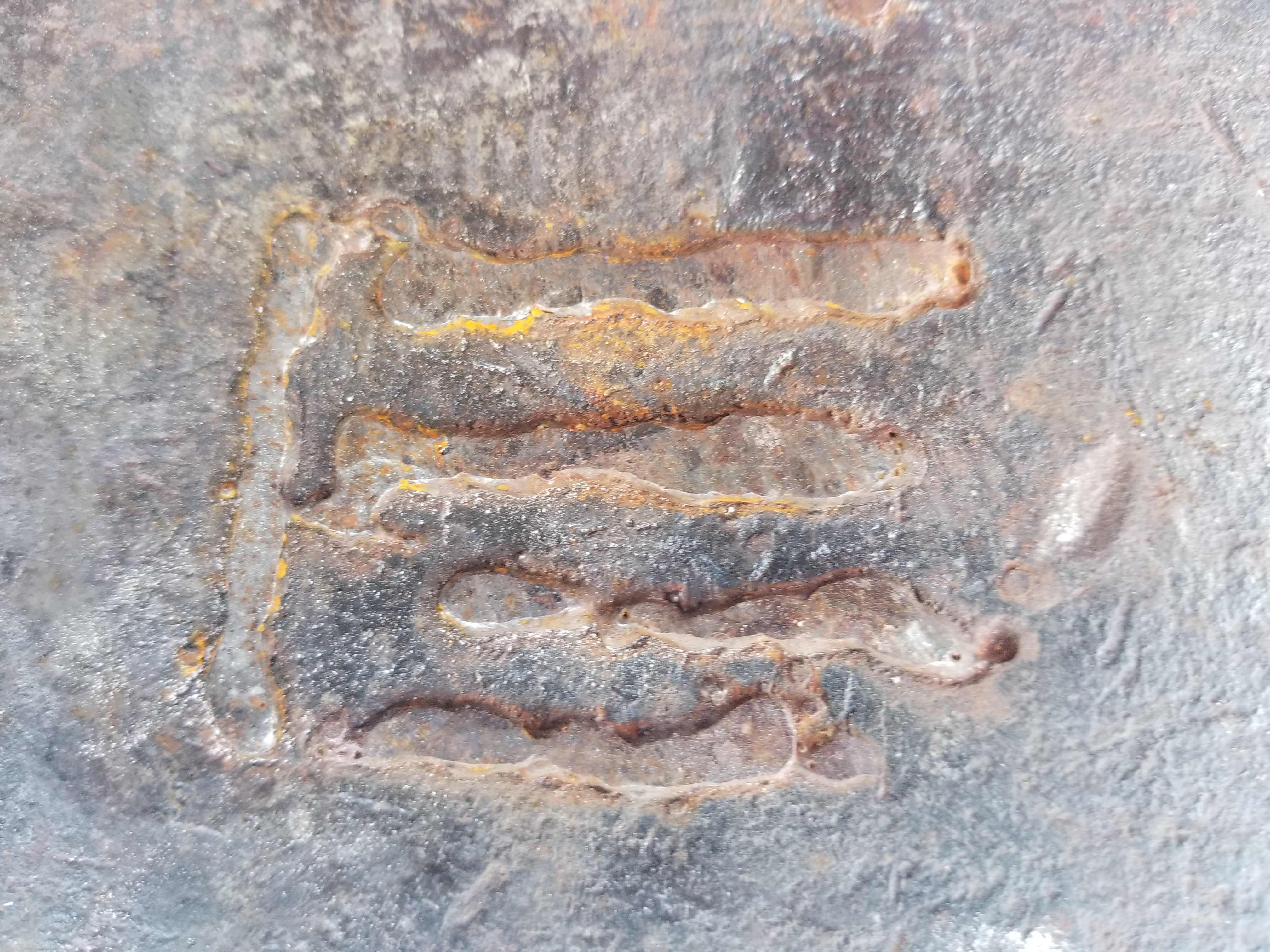

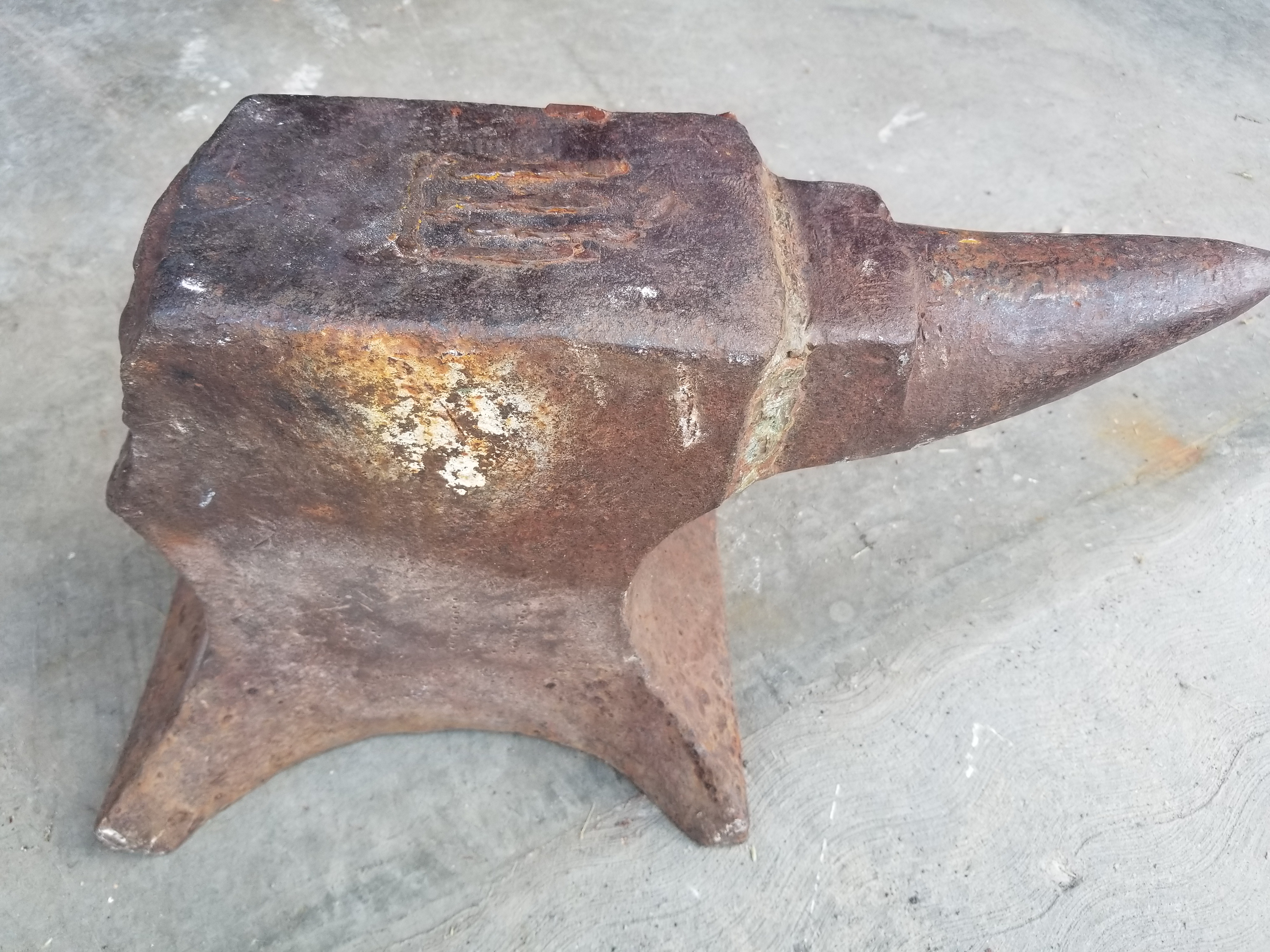

Little rough around the edges but the price was right. Thoughts on ID? Only markings I can make out are 1 1 14 (no dots between) and a very faint "TT" on the side near the edge of the face. Looks like the end of a word... Also about cleaning up those welds on the face... Grind to near flush then sanding disk to blend in? (Yes they look inverted in the bottom picture. Stand on your head and they'll pop out of the surrounding surface instead of looking sunk into it)
