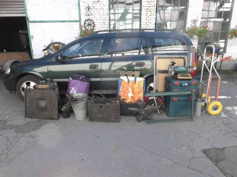

jlpservices I rarely use the belt grinder. Most work is done with a cordless Bosch anglegrinder in one of the smaller blue boxes. The other one contains a cordless drill. The big blue box contains the ppe, the samples, some cordless led lighting and some other items to make life easier and more convenient. The aprons are from Angele. Daswulf Except for these photographs I don't haul that 45kg Peddinghaus. I only shift it from the trunk to the stump and then use the hand truck. I am lazy, I am not stupid. Ausfire No overweight, I simply leave everything unnecessary at home. Frosty For heavier equipment I use my trailer. It has a pickup crane. Some photographs: Willy

Great idea, but that 150kg Bêché doesn' t fit in my trunk. Willy
This is a special setup: I forge with children (between 6 and 86 years) . In the car (an old Opel Astra G) Car unloaded. Built up (without sidewalls) Some details Aprons, safety glasses, gloves for the kids. Samples on the right side.
