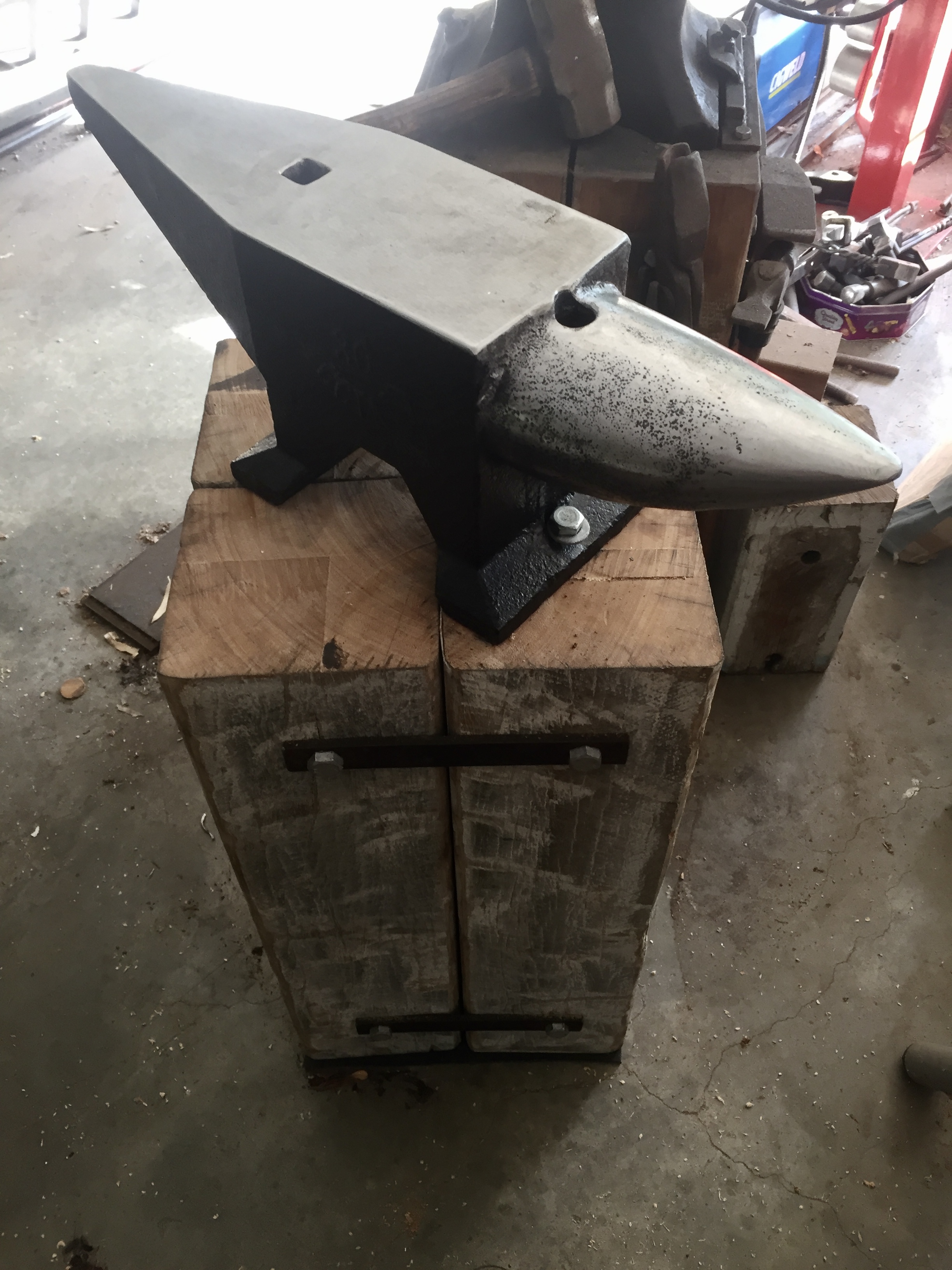

  1. New anvil just mounted. Got myself a cheap Accaiao 66lb cast steel anvil to go with my ancient saddle backed Dudley. Quality was as expected but even though the horn was not cast symmetrically I got a nice flat hard face and no holes in the casting anywhere. Stripped of the blue paint and applied some rust preventer (wish I had just oiled it, went a bit too black). Dressed the edges and hardy hole. I mounted it to a hardwood base using lag bolts through the holes in the feet (tidy). Put a magnet under the tail to reduce the ringing. Seems like it will do the trick!
  2. Anyone got comment on the eye size? I guess the widest part should also have a shallow taper.

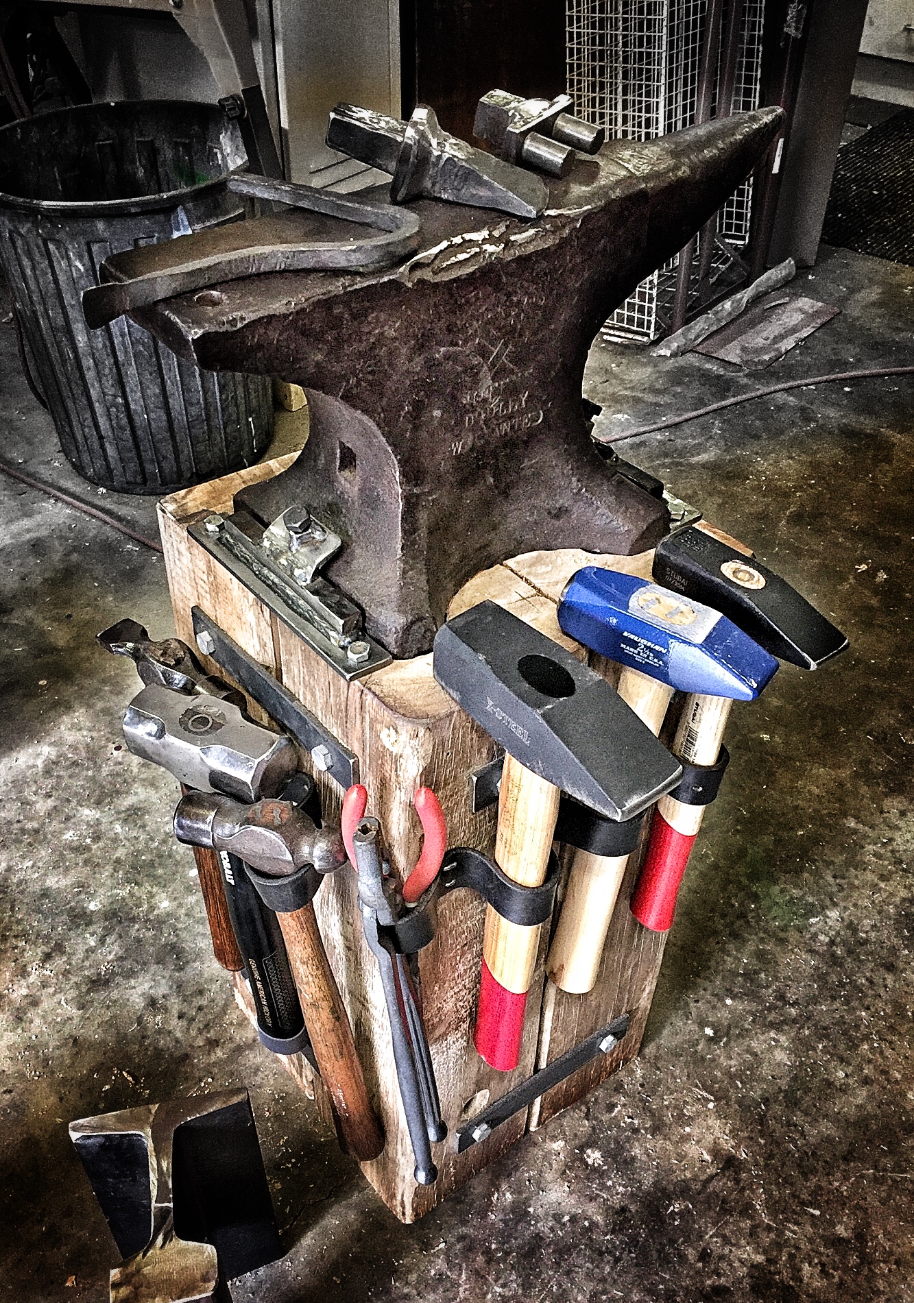

  14. Posted elsewhere, just adding to collection. It is a Wilkinson and weighs about 90lbs
