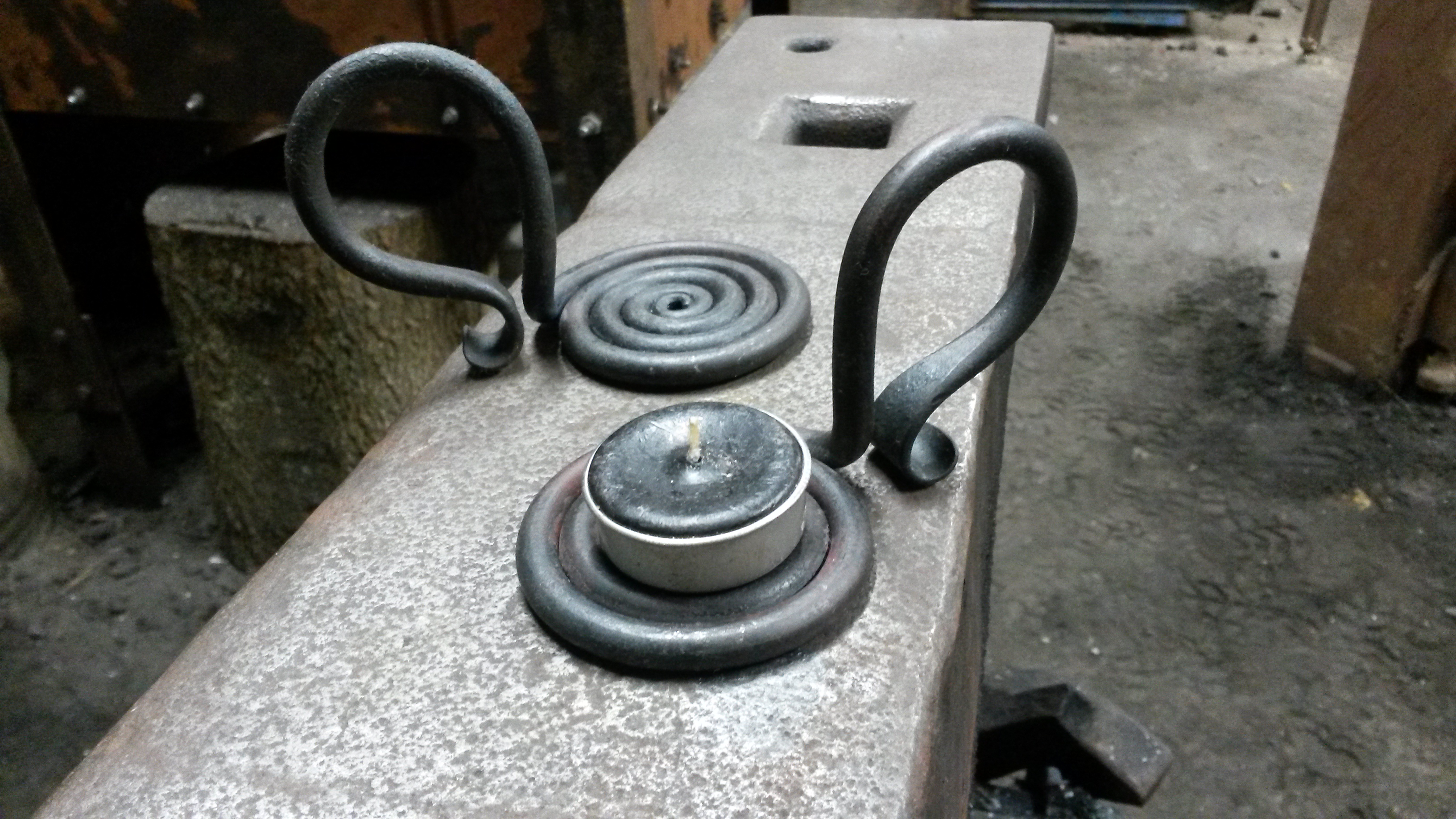

  14. Here's an early Christmas present from me to the newbies, though I'm still a newbie to 'smithing. A short video of a method that'll speed you up no end when making these tea light holders. These tea light holders are a pretty standard project for newbies and they used to be a stock item for me to sell at markets. I haven't made any in a long while but I thought they'd make a nice addition to the present I've got for the inlaws. The one thing I forgot to say in the video is you have to pull towards you (as if you were pulling on a piece of string to keep it tight) as well as bending the bar down, otherwise the bar will bow in unwanted areas. Pulling it towards you makes the bar follow the coil tightly without any gaps. As I say in the video, getting the heat in the right spot is pretty important. The other great benefit of this method is that the vice naturally keep the coil flat. You'll figure out pretty quickly where you have to pinch it in the vice. I got a bit carried away and rolled up the coil in the video a bit far and had to un-roll it a tad so it matched the one I'd already done. Merry Christmas. https://www.youtube.com/watch?v=OUtdZbPVCLw

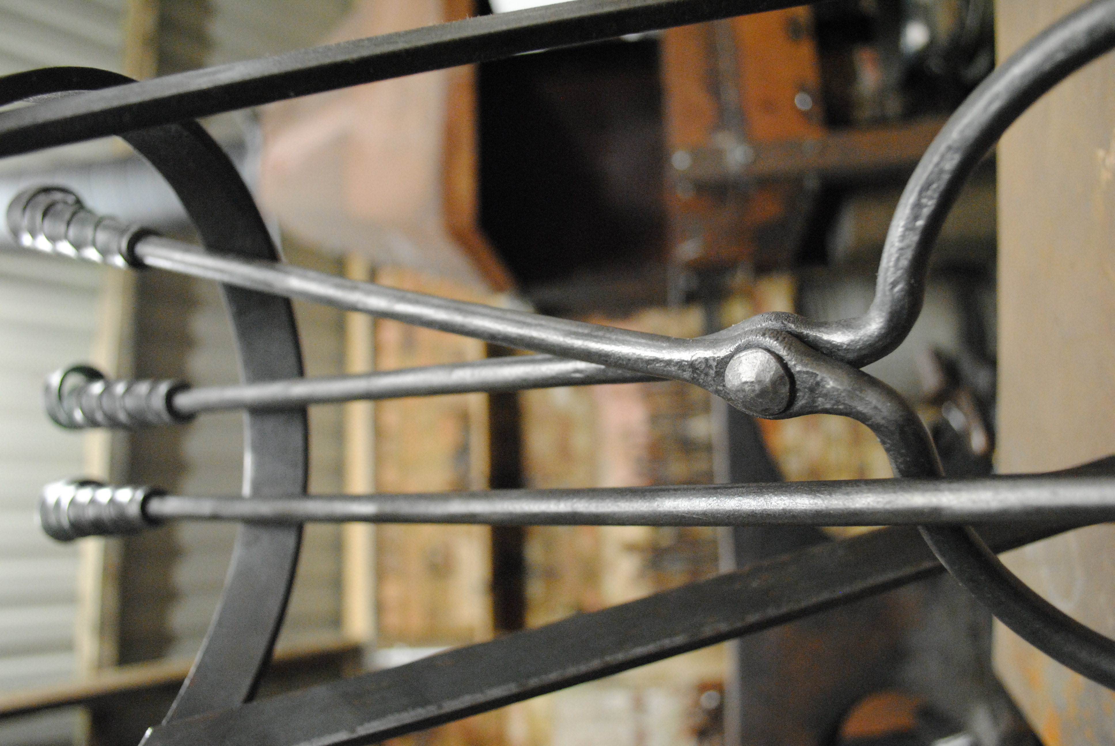

    Nice tongs Curly. My reason for asking is because it kinda feels to me like (without upsetting the hinge zone substantially) there's not really a way to forge hinges from small diameter bar in a way that's good all round. Thinking aloud - Curly, the great thing about the type of thinned down hinge you've forged on your tongs means the tongs naturally open and shut in the same plain, and there's a good amount of surface contact area on both bars to keep their direction of travel straight, so as long as the shoulder on the rivet is a good size then their direct of travel should always be true and not toe inwards/outwards. The downside is the thinned down areas of the hinge are now a weak spot and could bend out of alignment if the user was too ambitious with the size of log they wanted to pick up, or if there was a side impact whilst the tongs are leaning up against the fireplace. Your tongs are obviously small one handed tongs for small fireplaces so you'd expect the user is trying to pick up logs of an appropriate size with them. I made some tongs yesterday for a companion set, I slightly upset the hinge zone then just split and drifted the rivet hole. Unlike your method of creating a flat spot, the downside of mine is that they don't naturally open and shut in the same plain, so the bars have to be slighty bent into alignment, and the only thing that's keeping their direct of travel in check is the large surface area of the rivet shoulder. The upside however is that the parent bar thickness is maintained throughout the hinge zone so their strength is maintained sideways. It strikes me that the only way to get the best of both worlds is to massively upset the hinge zone, then forge them flat (like Curly's), back to their parent bar diameter.
