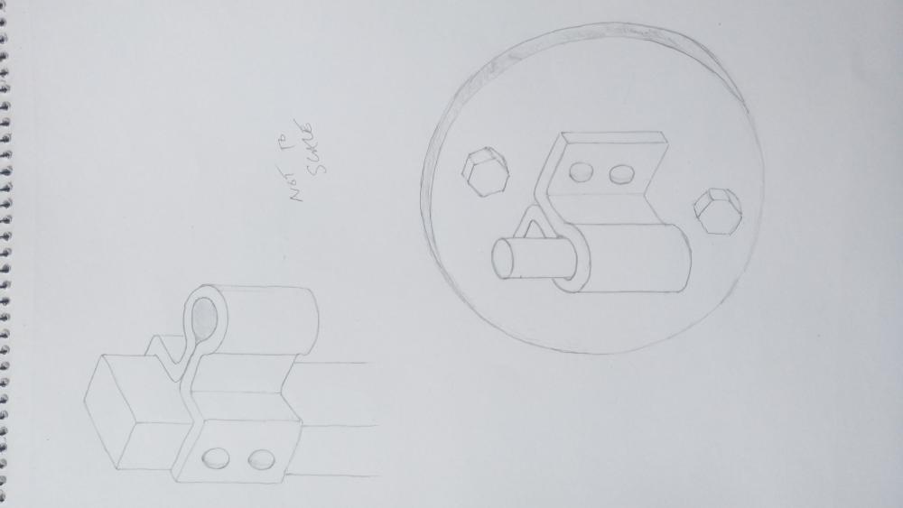

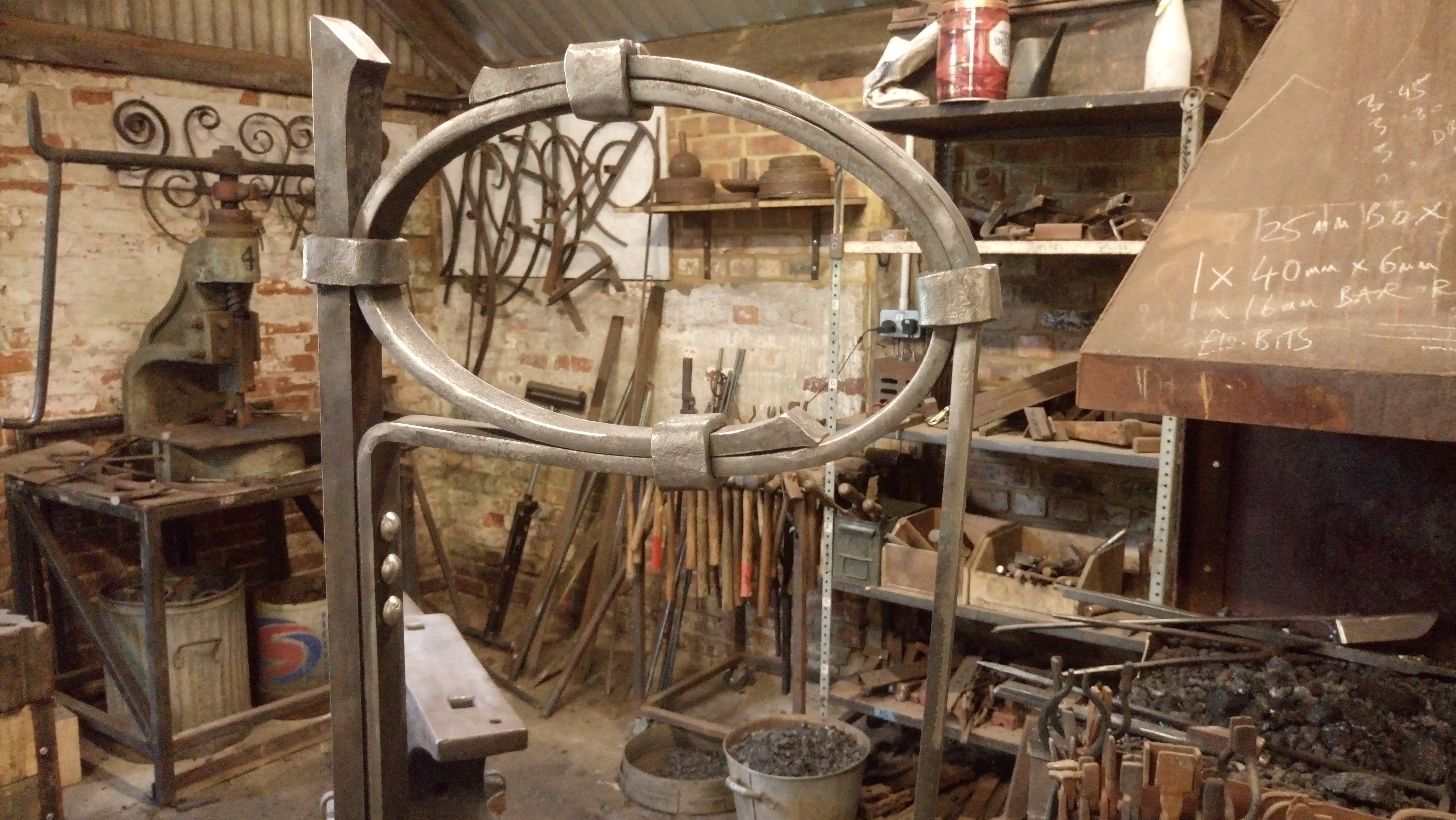

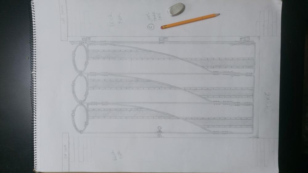

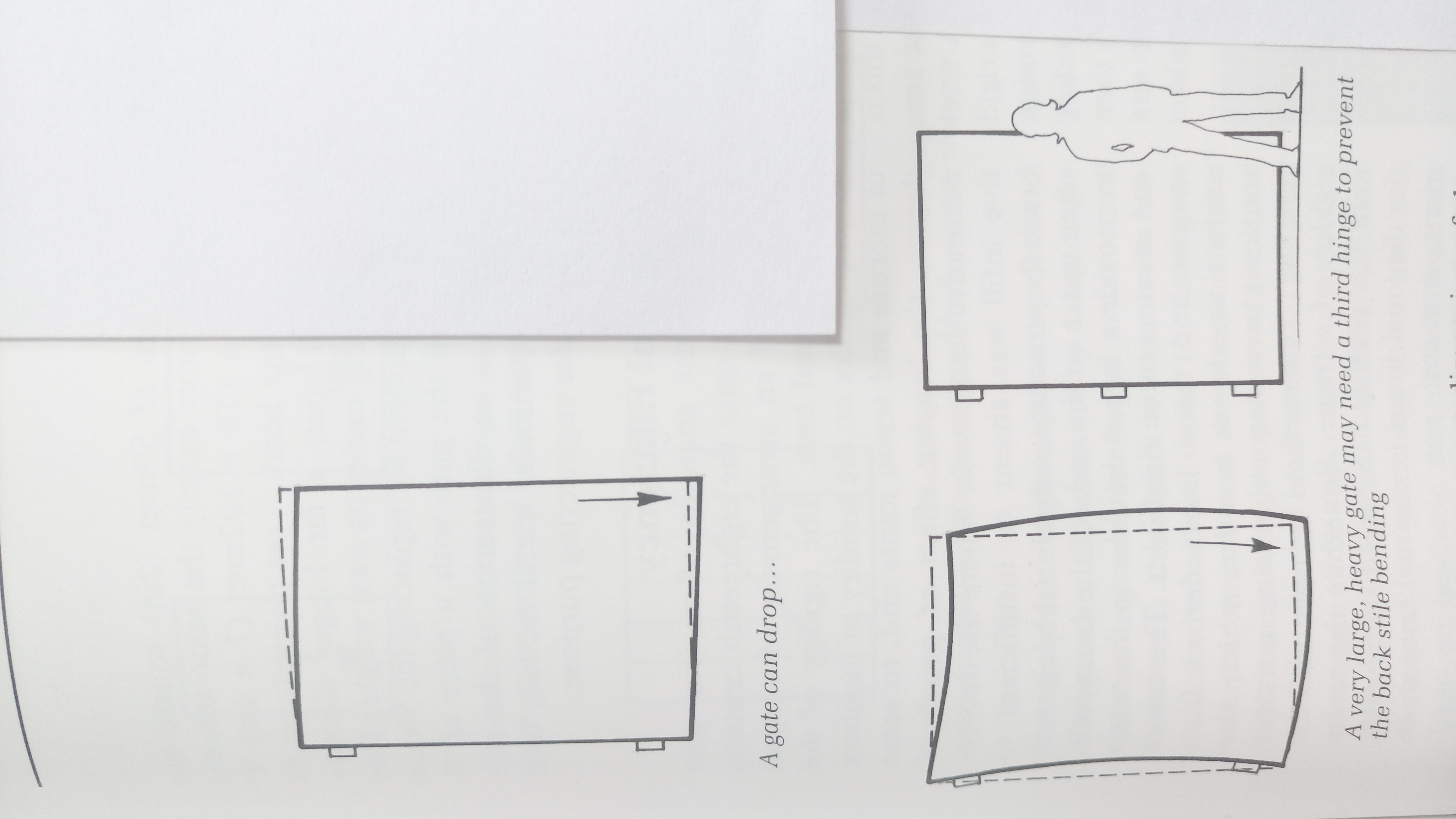

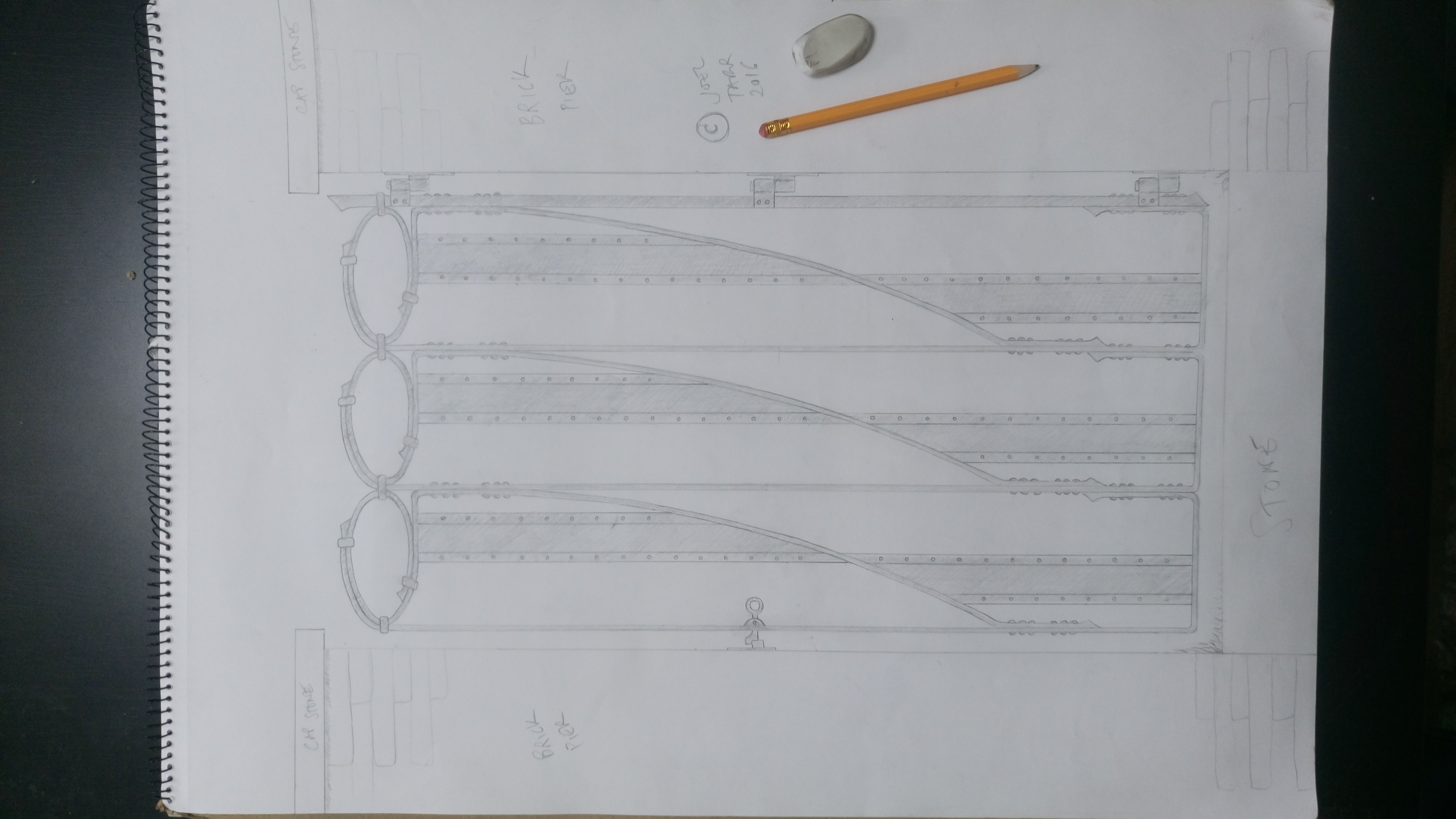

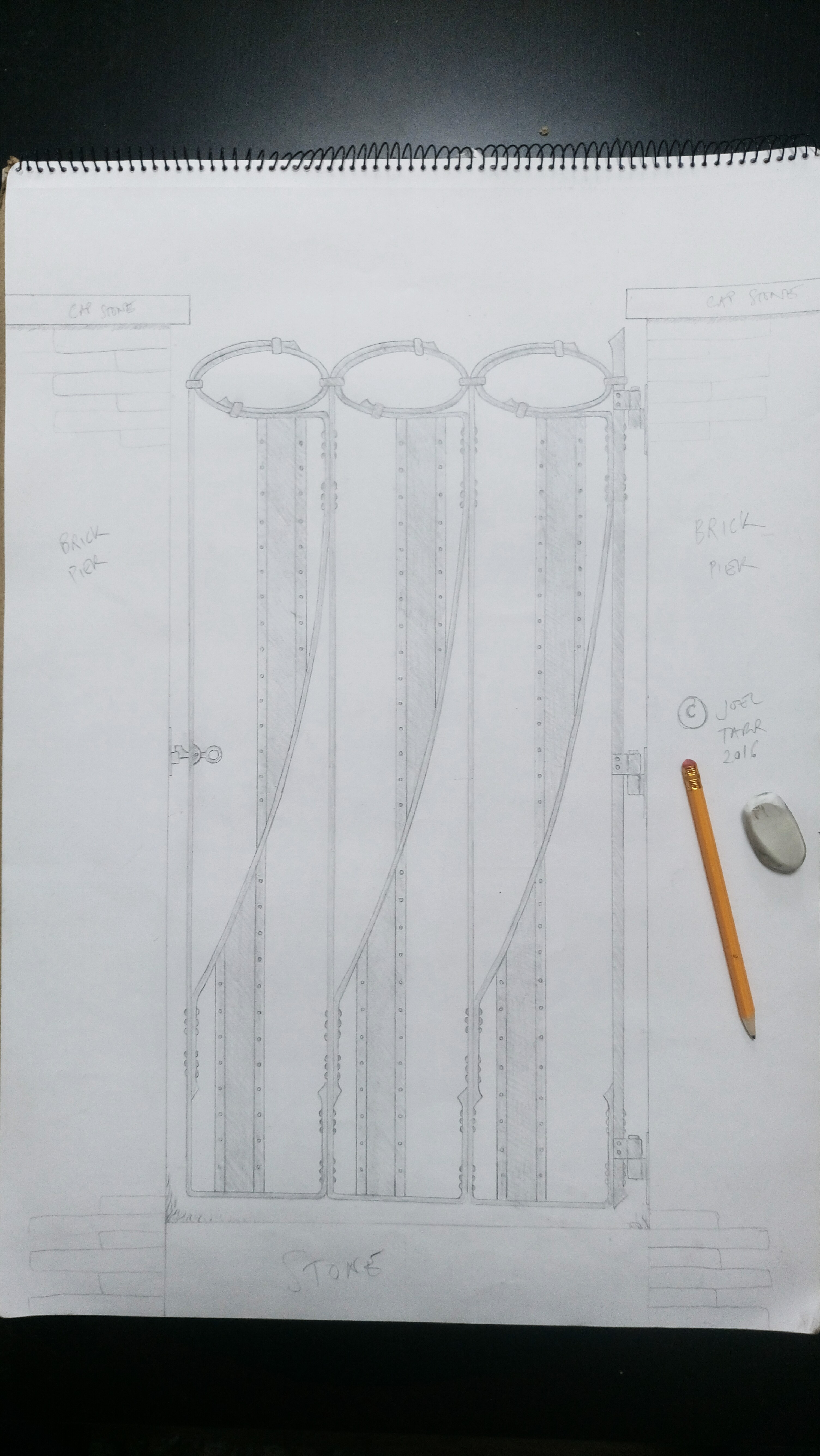

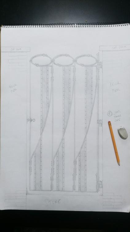

  20. Not sure if that was aimed at me or Arftist but the gate is my design, not an architects. The 3rd hinge discussion came about because the client was at one point concerned about the weight on the brick pier. He's satisfied it's not a problem now & would be happy with 2 hinges, but I had drawn in 3 hinges for the sake of the gate & keeping the back stile from bowing in the middle. The consensus seems to be that 2 is enough & 3 causes grief so I'll probably just run with 2. Cheers

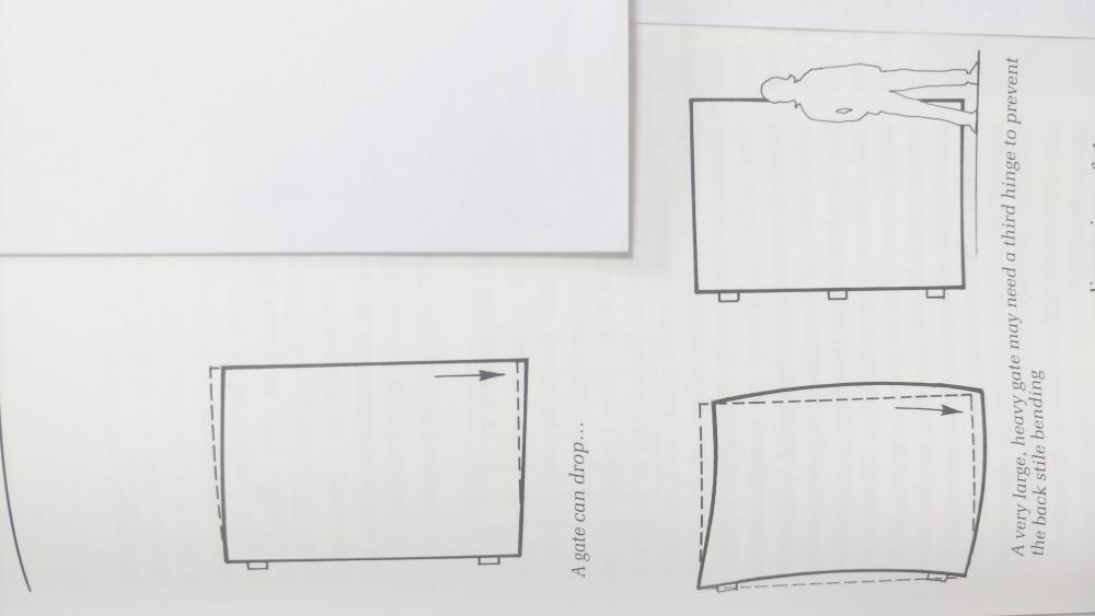

  21. Thanks very much for the comprehensive reply. I'll read it again a few times later when this hangover has worn off. I always set both hinge pintles facing up so the weight of the gate is spread across both hinges. I put a security pin through the bottom him pintle so the gate can't be lifted off. The chance of a 3rd hinge binding had crossed my mind. To be clear my concerns about the back stile bowing are as per the bottom 2 images, not the top. Pic taken from Peter Parkinson's brilliant book on Forged Architectural Metalwork. I'd really recommend his books to everyone, full of great info.

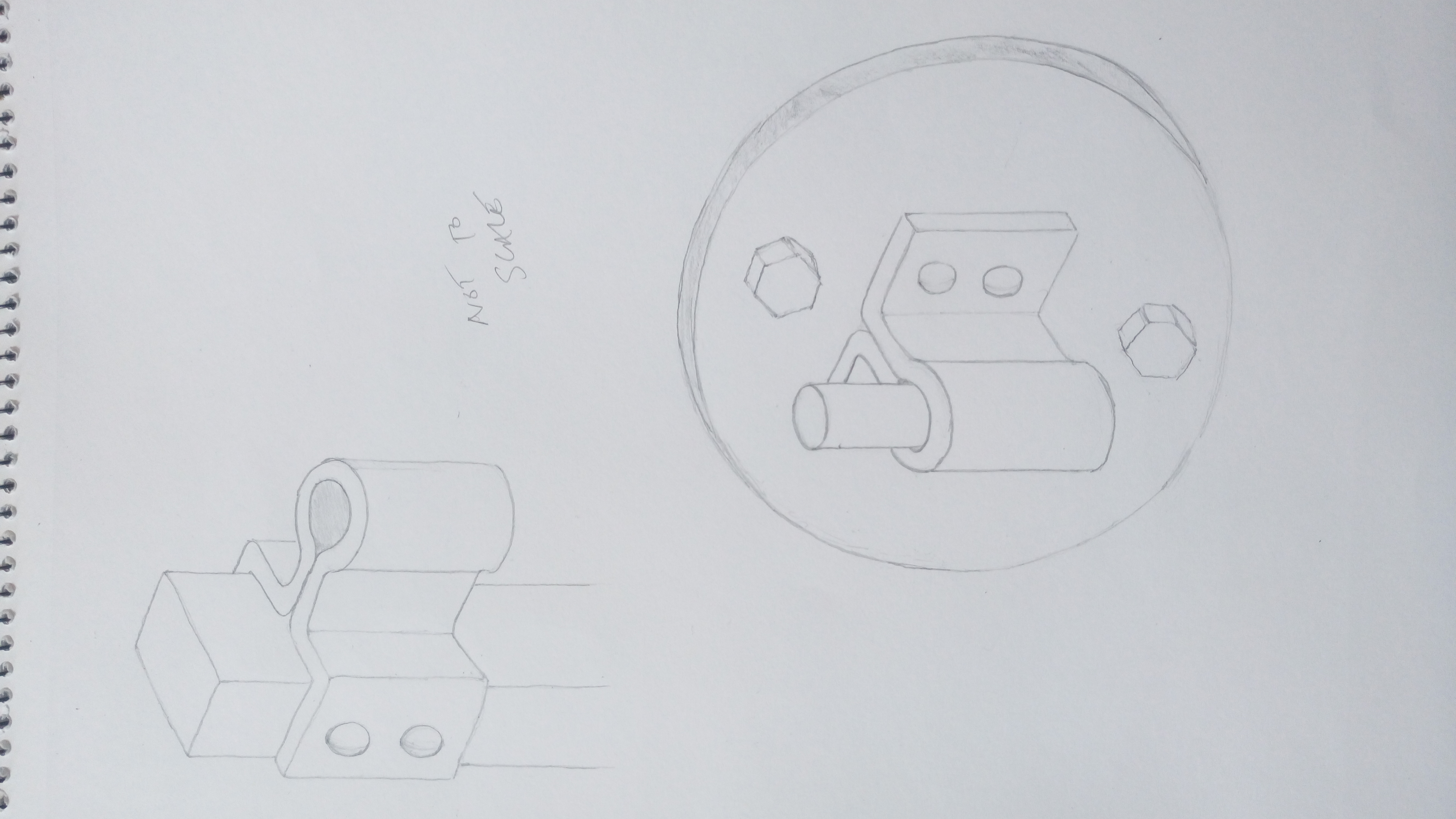

  22. I have just been given the thumbs up from my client for a gate design, 3rd hinge discussion ongoing. Picure of sample piece & designs attached. (Hex head bolts to be re-forged to square & more fixing points on round hinge plates). Steels to be used: 30 x 20mm back stile, 30 x 10mm curves, 2mm sheet panels, 20 x 3mm riveted edge softening strips. Total weight approx 75kg. Back stile weight approx 10kg, remaining gate weight approx 65kg. Think the 3rd central hinge is needed to prevent the back stile bowing? No young children, infrequent grandchildren visits to use it as a swing.
