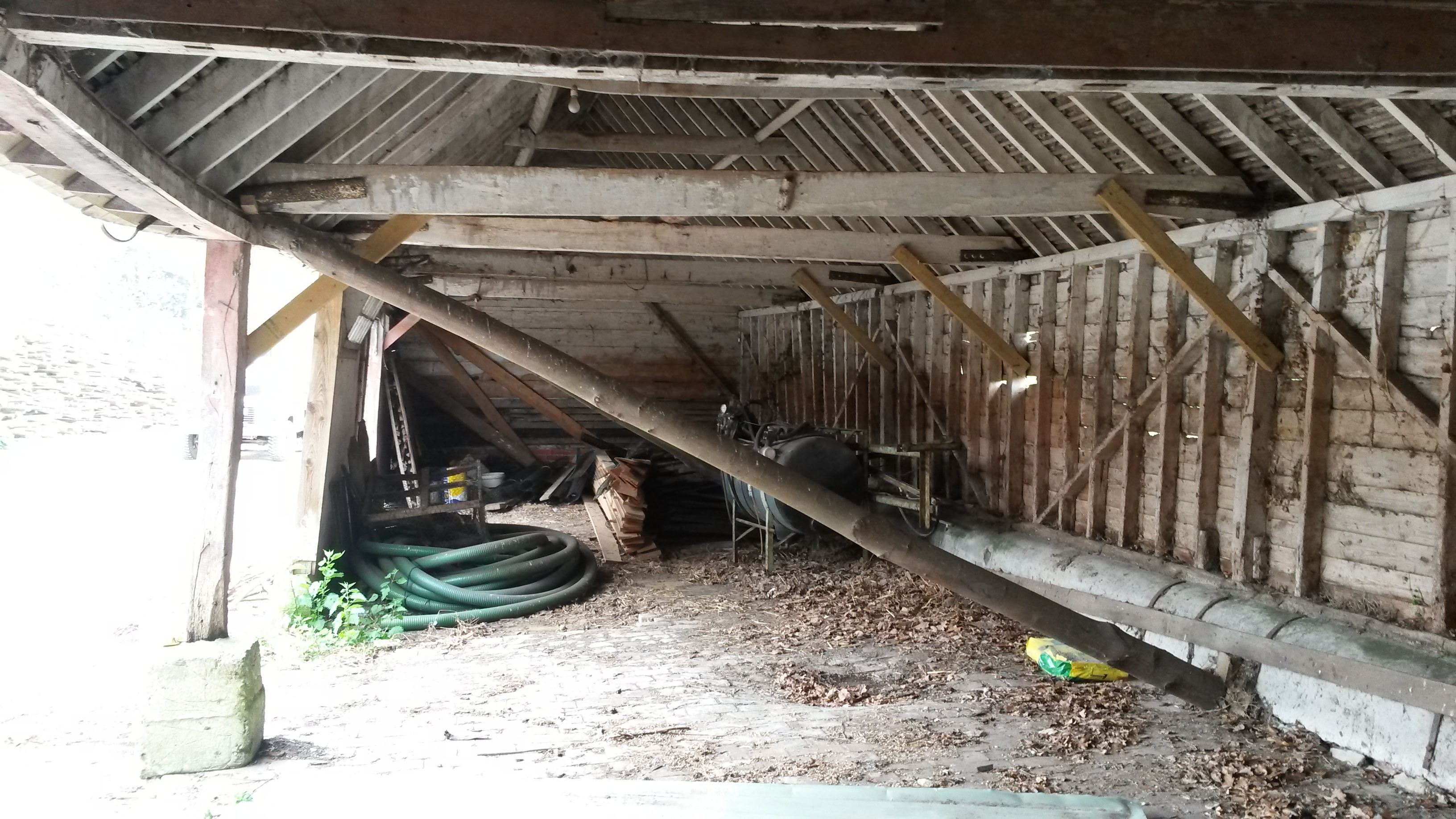

Like getting tools into the building to transform a farm barn into a workshop! Uneven floors are their enemy then I take it?

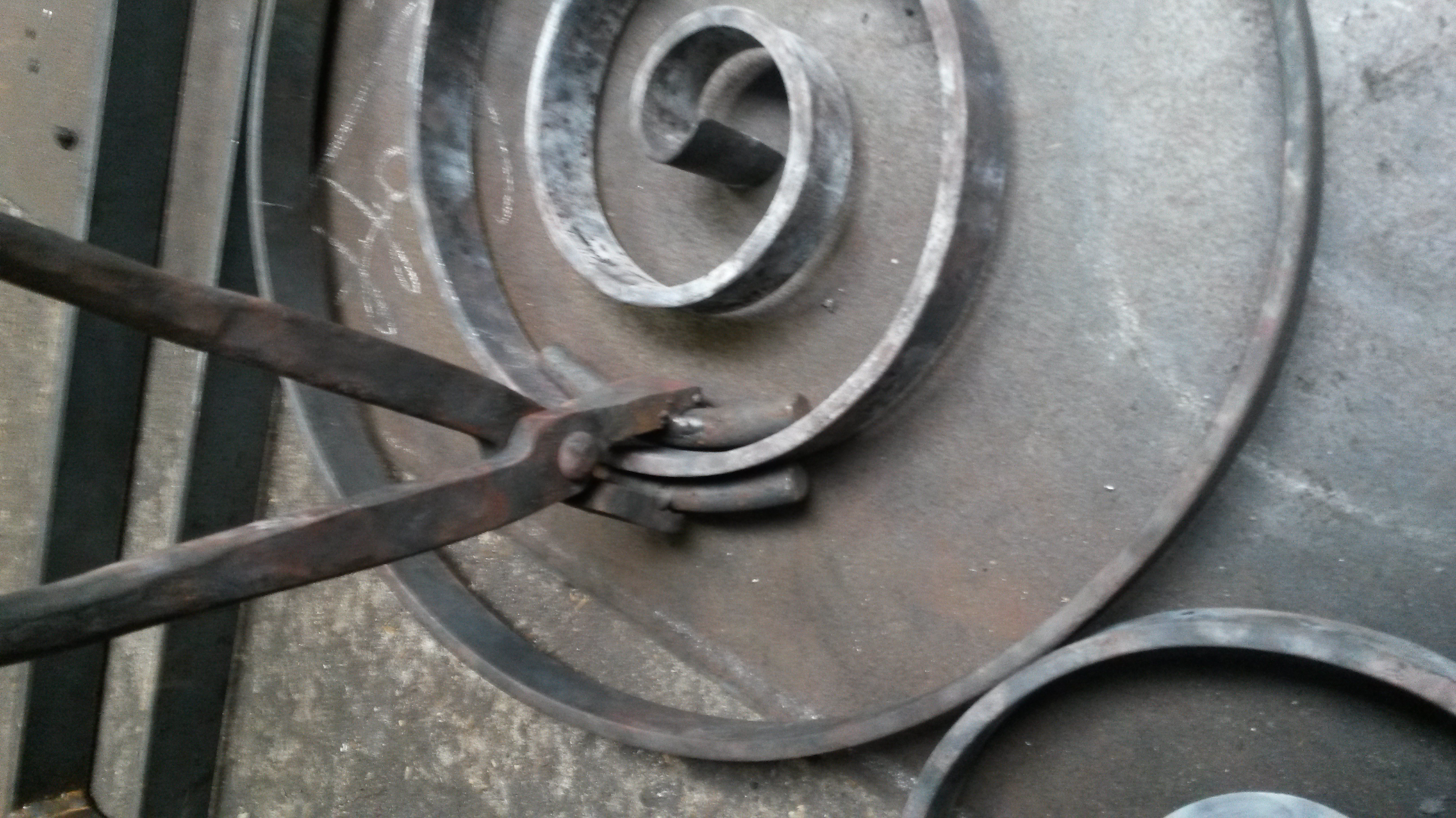

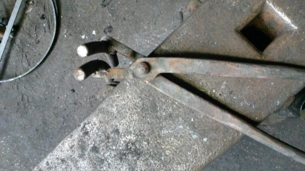

tongs to remove scroll flats

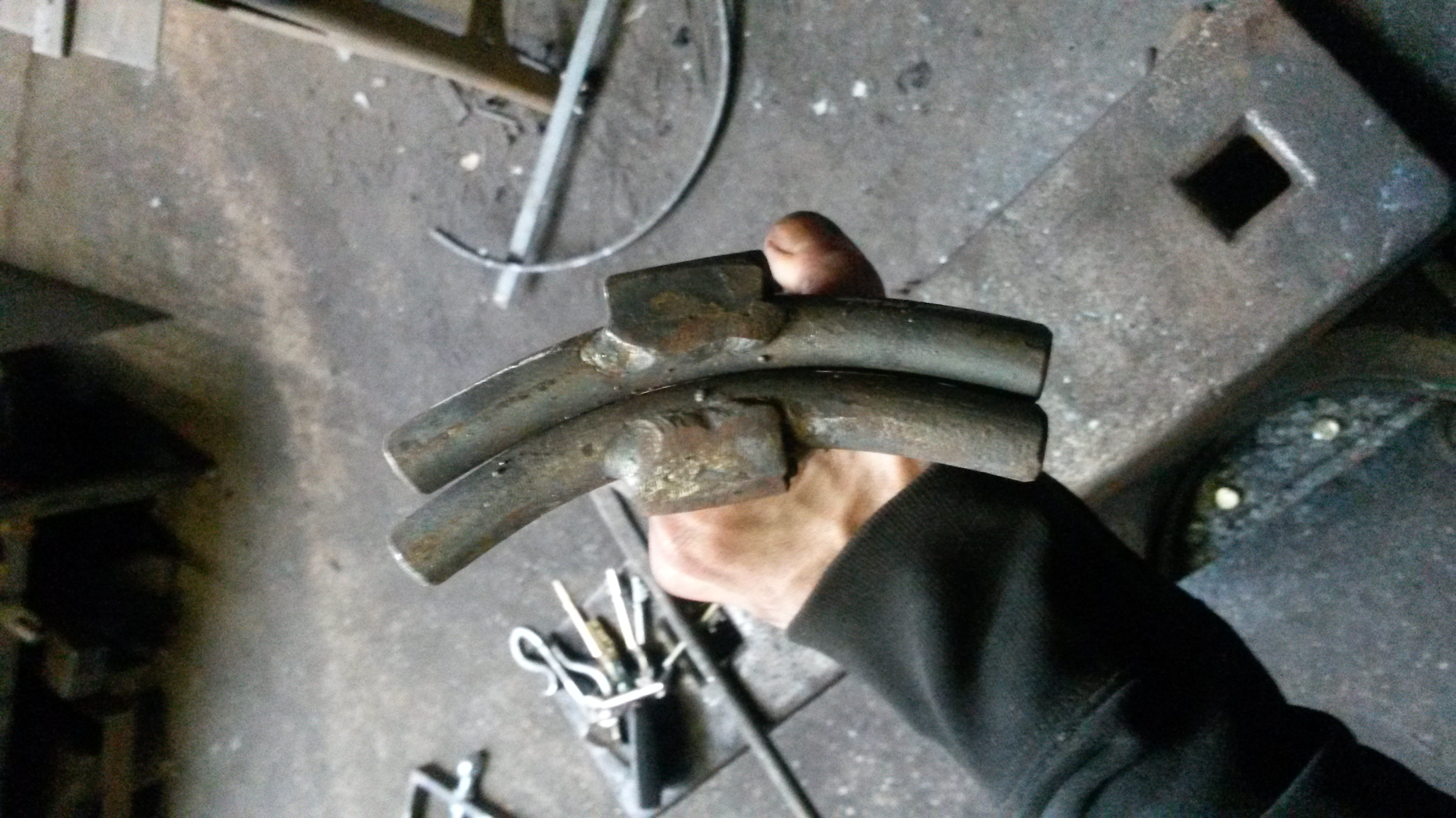

My success rate with bending forks isn't great & scrolling isn't really my favourite job (though I'm getting better at it) so anything that makes my life easier is a plus. I like the tongs for their simplicity as they have a predetermined shape. Use them the "right way" round to close up flats or the "wrong way" round to open up curves that are too tight. You don't need to hold the scroll either, you can just lay it on the ground. My first pair of these were actually some small tongs I made to hold bowls without marking the edges (as flat tongs do) & I grabbed them in a hurry to close up a small flat spot on a scroll, they did the job well so I made more of varying sizes.

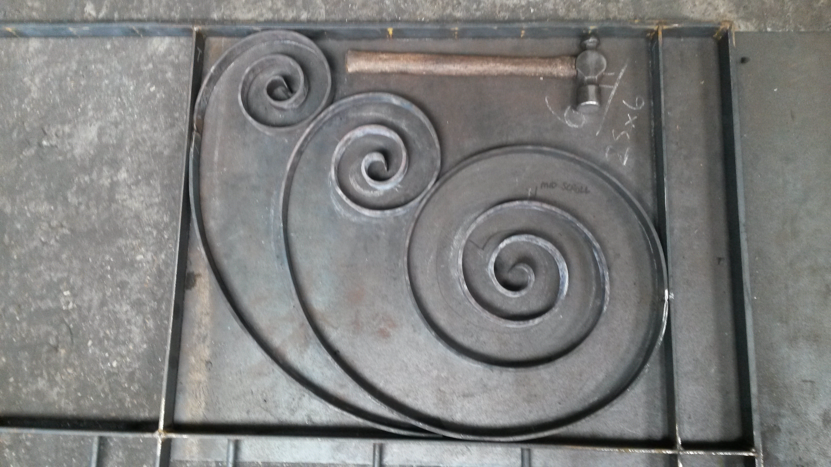

Jig made by hand/eye/hammer/swearing. Got several of these to do for some fabricator mates, made to their sadistic design. The inside of the largest scrolls starts off on the middle scroll jig up to a certain point, after that I move onto another jig I made for the outer rings of the scroll. These tongs are really helpful at blending in those little lumps and bumps where one jig ends and the next begins.
Hi folks, just thought I'd share a few pics of some useful tongs I made for removing flats in scrolls. I've made a few pairs of these to varying sizes so between them I'm pretty well covered against unsightly flats that creep in. I expect these are old hat and I'm reinventing the steel but hey ho. Use and abuse as you see fit.

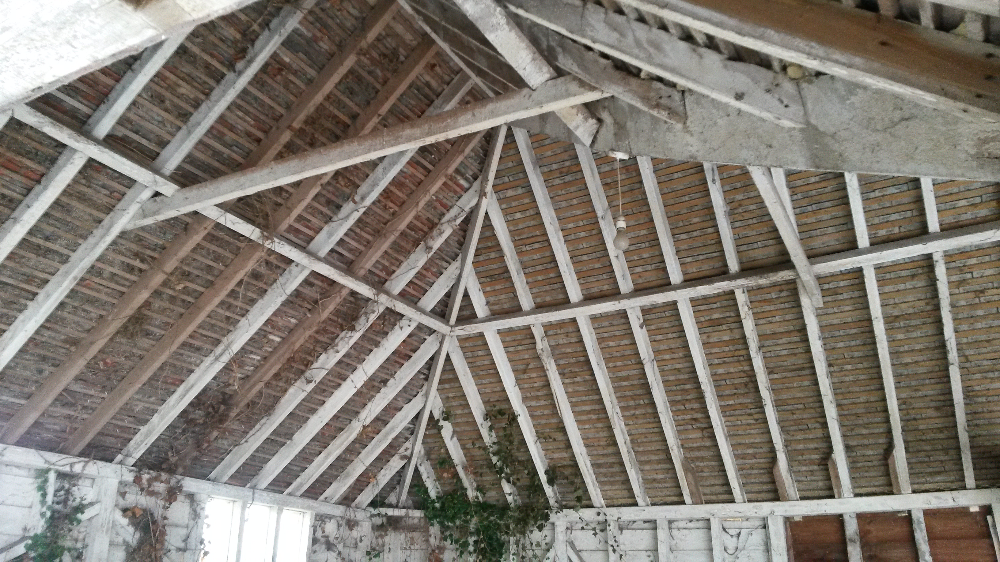

UK workshop rental prices

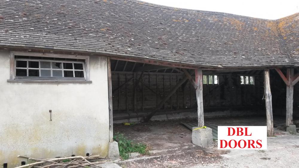

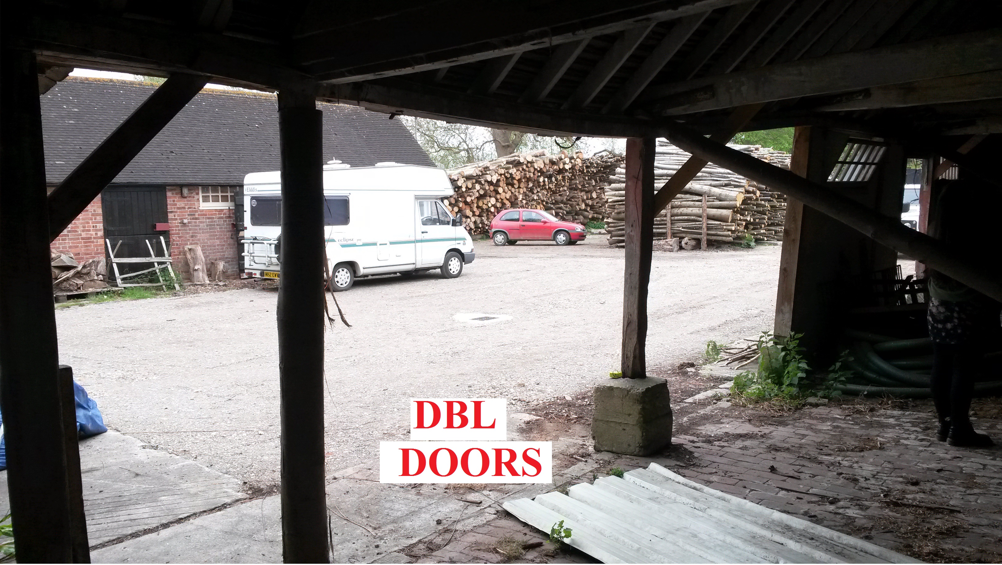

Well it seems the estate manager has conceeded that a concrete floor at the forging/fabricating end of the workshop would be beneficial so the steels in the floor aren't required anymore, though they do sound great I think I'd be pushing my luck. At the weekend I got down to the workshop site to take some pics of my wing of the building. I mainly aimed my camera towards of that end of the building I just mentioned, in that zone there's an area of approx 6m x 4m without any tie beams in the way and there's very good roof height. It really does seem to be 1 step forward 2 steps back with this place, there's cottages on the estate that are rented out and when I popped down I happened to meet the tenant of the cottage that's closest to the workshop, his cottage is approx 65m away (measured on Google Earth). Seems like another conversation with estate manager is now needed regarding noise as he's got some interesting ideas about me quietening down when he wants to be in his garden.

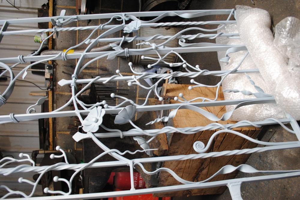

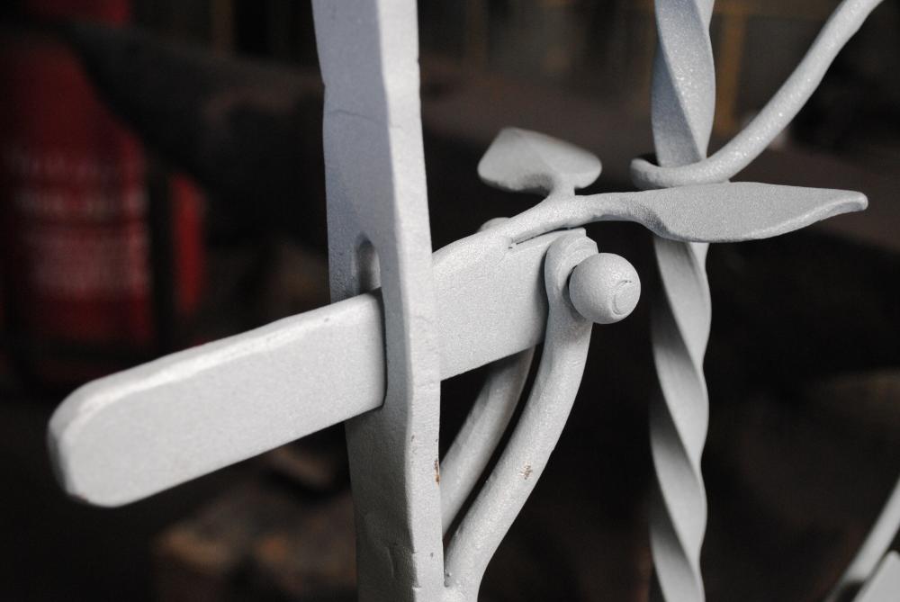

Wish me luck...

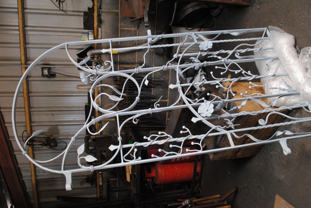

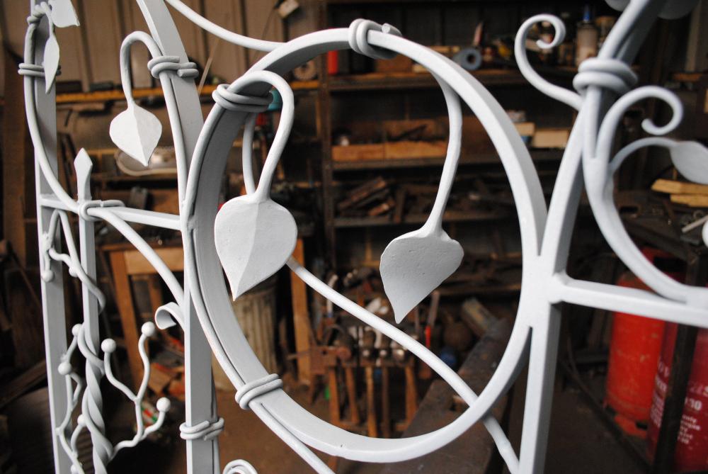

Thanks for all your pointers with this folks, I took your advice on board and included more bracing - all with the client's prior approval of course. I'm self taught and only been smithing for a little over 2 years so this was a fantastic learning curve. There's parts I'm happy with and parts I slightly wince at. If I had to do it again I'd definitely redesign the subframe so I didn't have to create so much bracing from the climbing shoots. I'm happy to say the clients are delighted with the finished result though the clients wanted me to make the gate first then install posts to suit so I haven't got any pics of the gate in situ. These pics are of it in the workshop when I got it back from the zinc spraying firm. I took these pics before treating the gate in any way but after taking them I sprayed some clear laquer on some areas and lightly burnished some other areas in an effort to make the colour change at different rates, to increase the "organic" look. I'm a stick welder and I don't have a MIG welder or a gas torch...now I desperately want both. (If the pics come out on the wrong orientation can a moderator spin them around so they're right? No matter what I try some pics always upload wonky).
