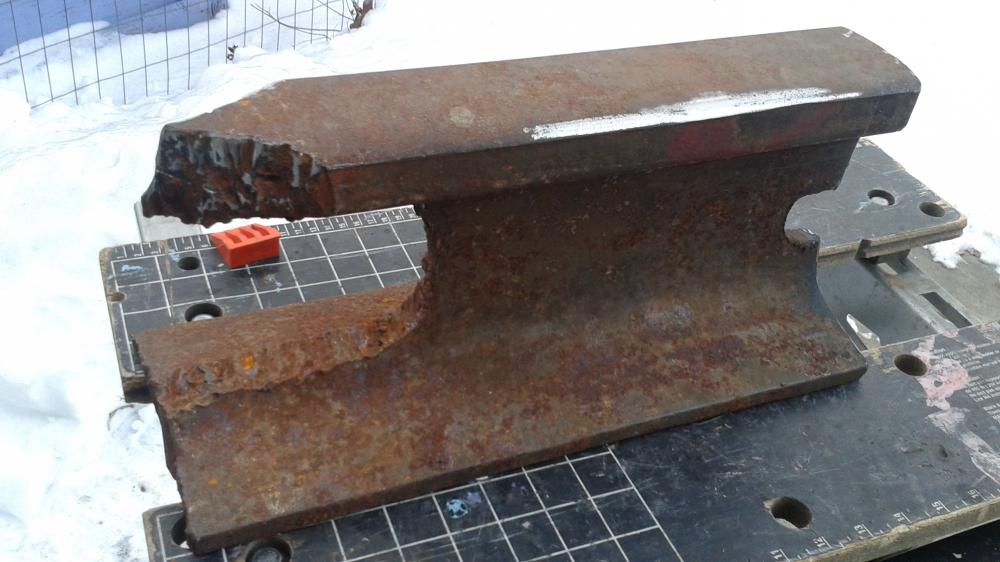

  2. It was 9 degrees out today, so I moved into the garage. Frosty will probably say that's a veritable heatwave, but I like being able to feel my fingers when working with an angle grinder. I cut out somewhat of a horn on the web of the piece that will stand on end and a bending bar on the other side. It has a nice ring to it, but the hammer leaves small indents in the top. Is that normal? Will it be much of a problem? I am just a hobbyist, and I am not looking for perfection.
  3. After another grinding session.
  4. Here is the horn beginning to take shape after another cutting session.
  5. That's why I cut it in two. One will be standing on end, and the other that already has a rough horn cut out I'll have laying horizontally. The one on end I'll cut out one or two horns on the web.
