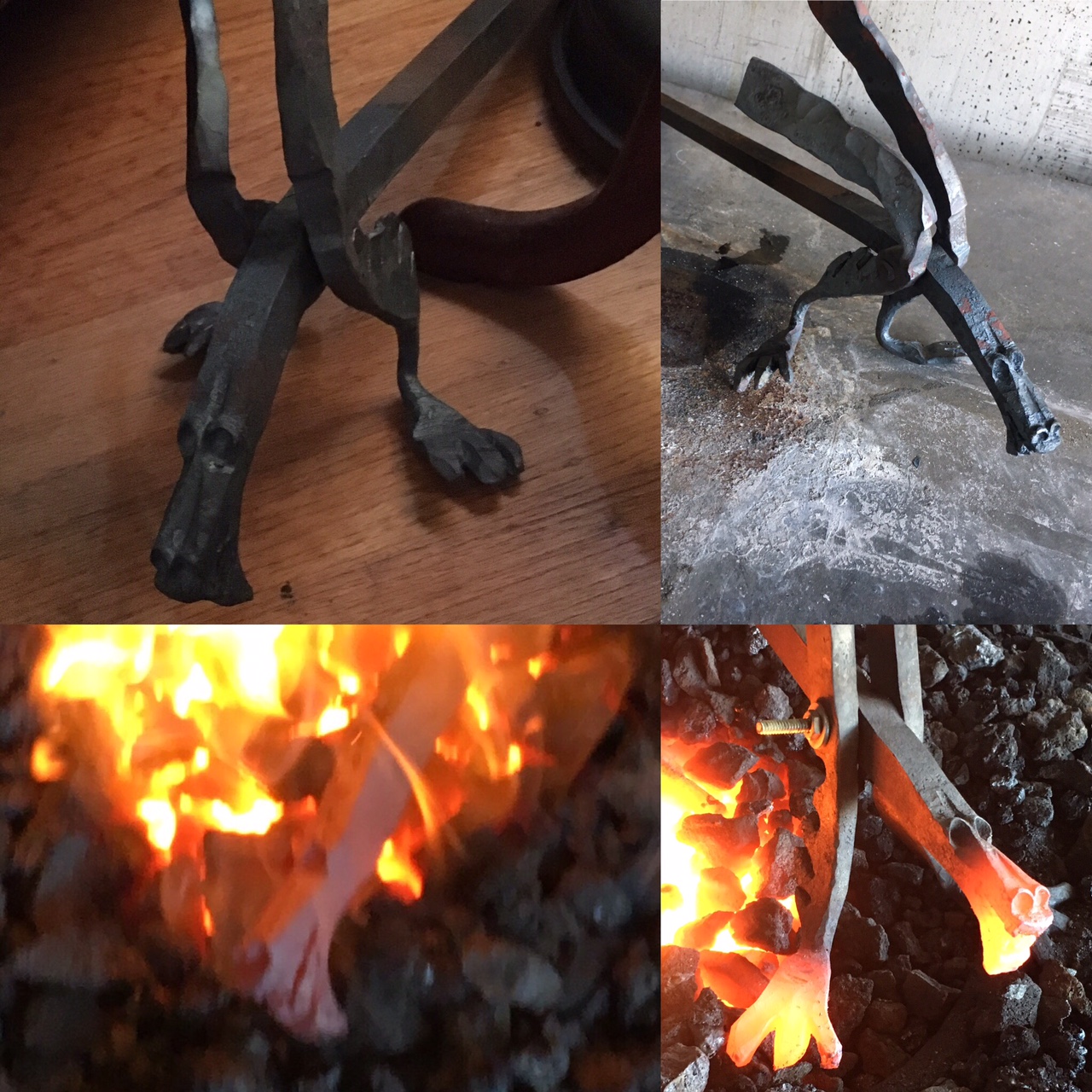

  18. Here you go Andrew, I took a half day off yesterday (fewer neighbors around mid week when I'm burning coal in the suburbs) and finished the dragon. Pineapple twist on the body, another on the tail. forged out the wings and curled them around the back. Tried for a fishtail sort of look but it came out as a lump, may go back and trim it to a traditional spade shape. Middle shot is the leg/wing combo straightened out to make fullering the wings easier. More a proof of concept that's been banging around my head for a while. Next one will have a more pronounced scales on the body, bigger wings and smaller feet. Maybe the wings and feet separate parts riveted to the shoulders.
  19. Sure, go right ahead. I'm borrowing ideas (at least 3 or 4) from other smiths in this project.
  20. Got about half a dragon done over the weekend. Made many dragon heads, but not the full thing. 5/8 bar, about 2 hours for the head in the coal forge and another hour each for the feet/legs/wings. Went back out Sunday for an hour or so with the gas forge to refine the shape of the legs, make them a bit less chicken-like. I'll wait till I'm almost done to cut the horns, need a little practice first. Plan is to pineapple twist the body for scales, only realized after the fact I could punch the shoulder hole (legs are temp riveted on) after twisting. Notes to self for the next one.
