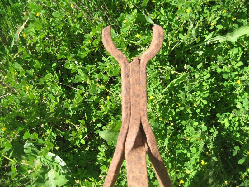

yahoo2 Posted August 30, 2015 Share Posted August 30, 2015 the picture shows a stand for holding hex shaft that was made during a forging demo. The steel is 1045 and was welded with sand only, as a matter of fact, apart from the hot cutting everything you see was done in the one very swift unspectacular and relatively cool heat. It was a sobering lesson in efficiency from a retired professional. Quote Link to comment Share on other sites More sharing options...
