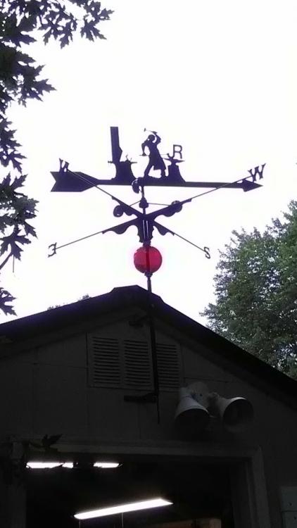

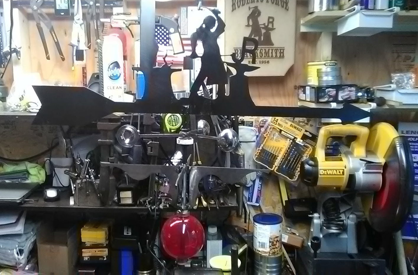

I've made a couple of Blacksmith themed weathervanes. The 2nd one for my own shop has an anemometer I made from 2" stainless steel ladles. I made up a simple Delrin thrust bearing for the pivot so the anemometer would turn in the slightest breeze. I use the "two finger method" to find the balance point of the mass. I put two 5/16" ball bearings in the top tube so it can turn in any breeze easily.
Stitch
Very nice!  I don't think I could get away with that though as our spring winds are very strong, (we had 80 MPH straight line winds the first spring I was here and the joke is that you can tell it is spring in New Mexico when your neighbors' concrete blocks start blowing into your yard...)
Have you made any whirligigs with the blacksmith actually striking?  How did you get your anemometer to produce measurements?
