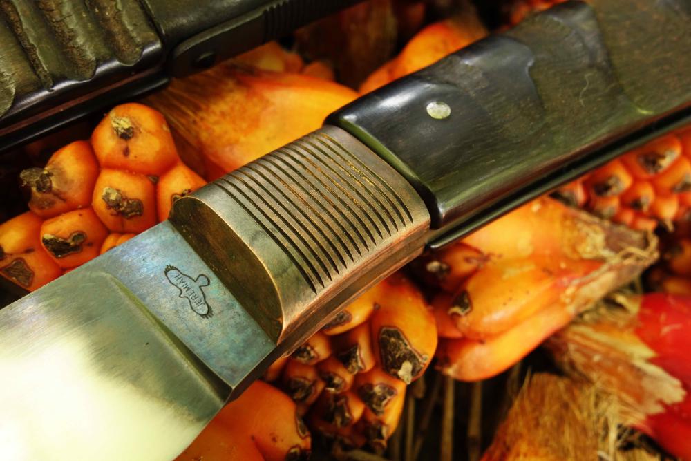

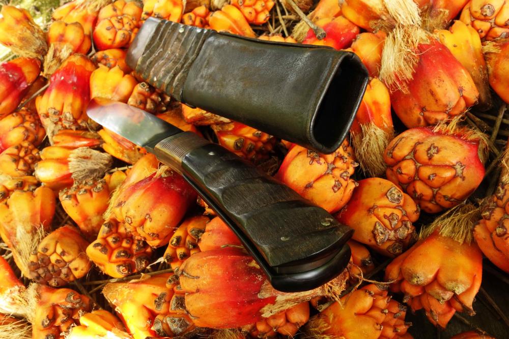

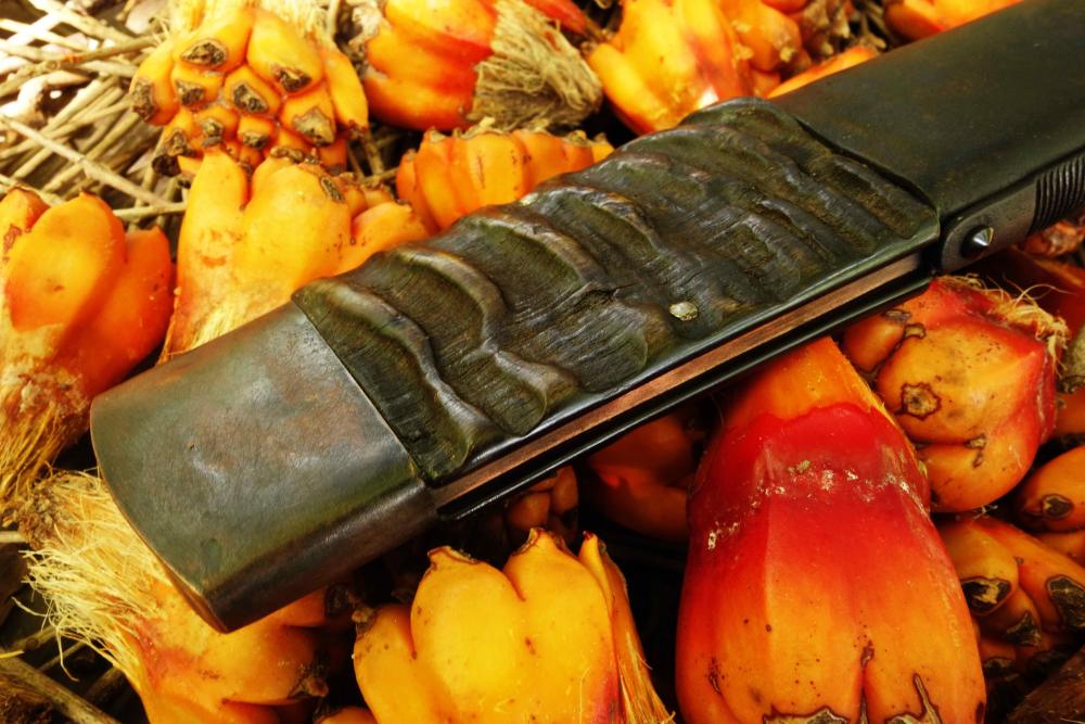

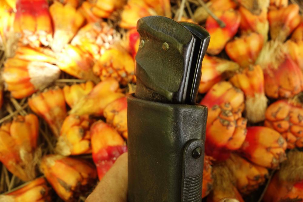

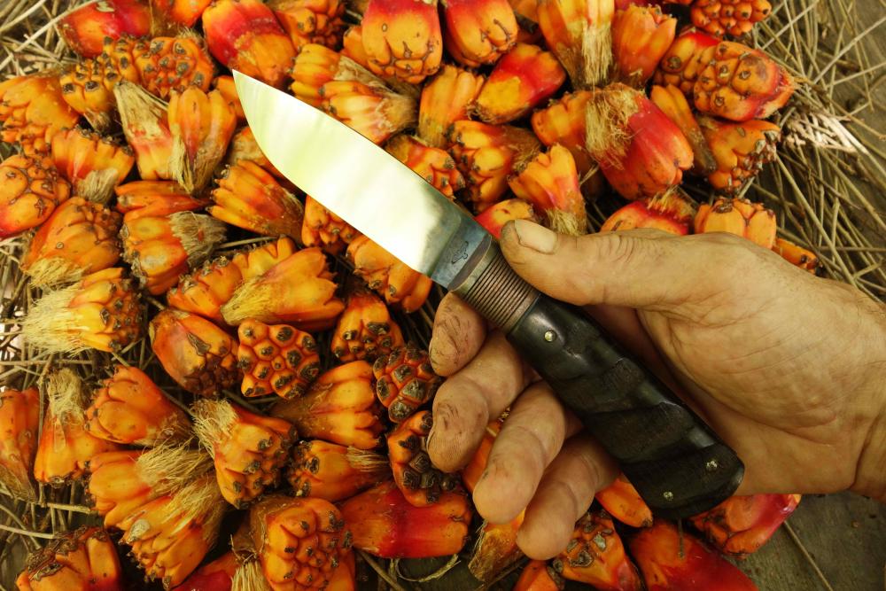

Here you see a hunting knife with forged blade from O7, copper bolsters and steel pinned Thompson's gazelle horn for the handle slabs and the liners of the sheath.
Blade length is 110 mm and it measures 230 overall.

Beautiful as usual. A good using blade is my preference and yours is a fine example. I was wondering too, what are the "berries, fruits, ?" in the picture? They make an excellent background. Just busy enough to keep the eye from wandering off the subject but not so busy they distract.
The background are in deed Pandan fruits as Hefty(Jono) already pointed out.
It is very close to an old fashioned artificial indefinable sweet taste like vintage chewing gum(not spear mint or the like)...even natural it tastes super artificial, I don't like it.
But the smell is really fragrant.
Finding a good background for the pictures is mostly not easy, especially for very dark knives like this one.
Some of the fruits were already in an very overripe state and I found myself between stench and scent.:huh:

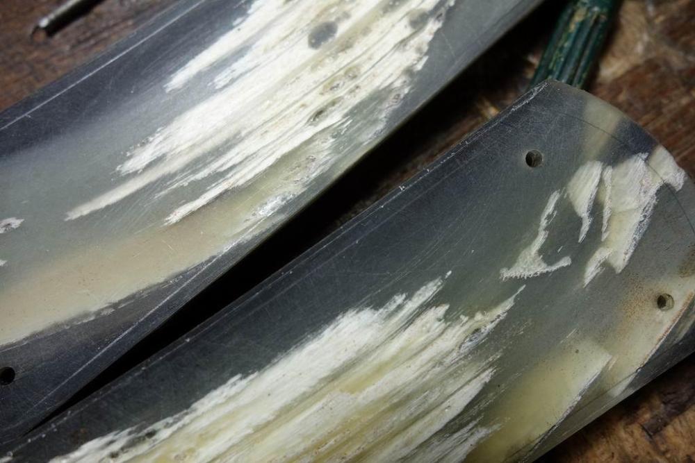

7 hours ago, Hefty said:
 How do you create such an accurate overlap on the oversize scales/slabs?
Jono, I once took pictures of the process to explain a fellow knifemaker how I do this.
Give me a little time to find the pictures again then I will post them here....I won't forget;)
Cheers

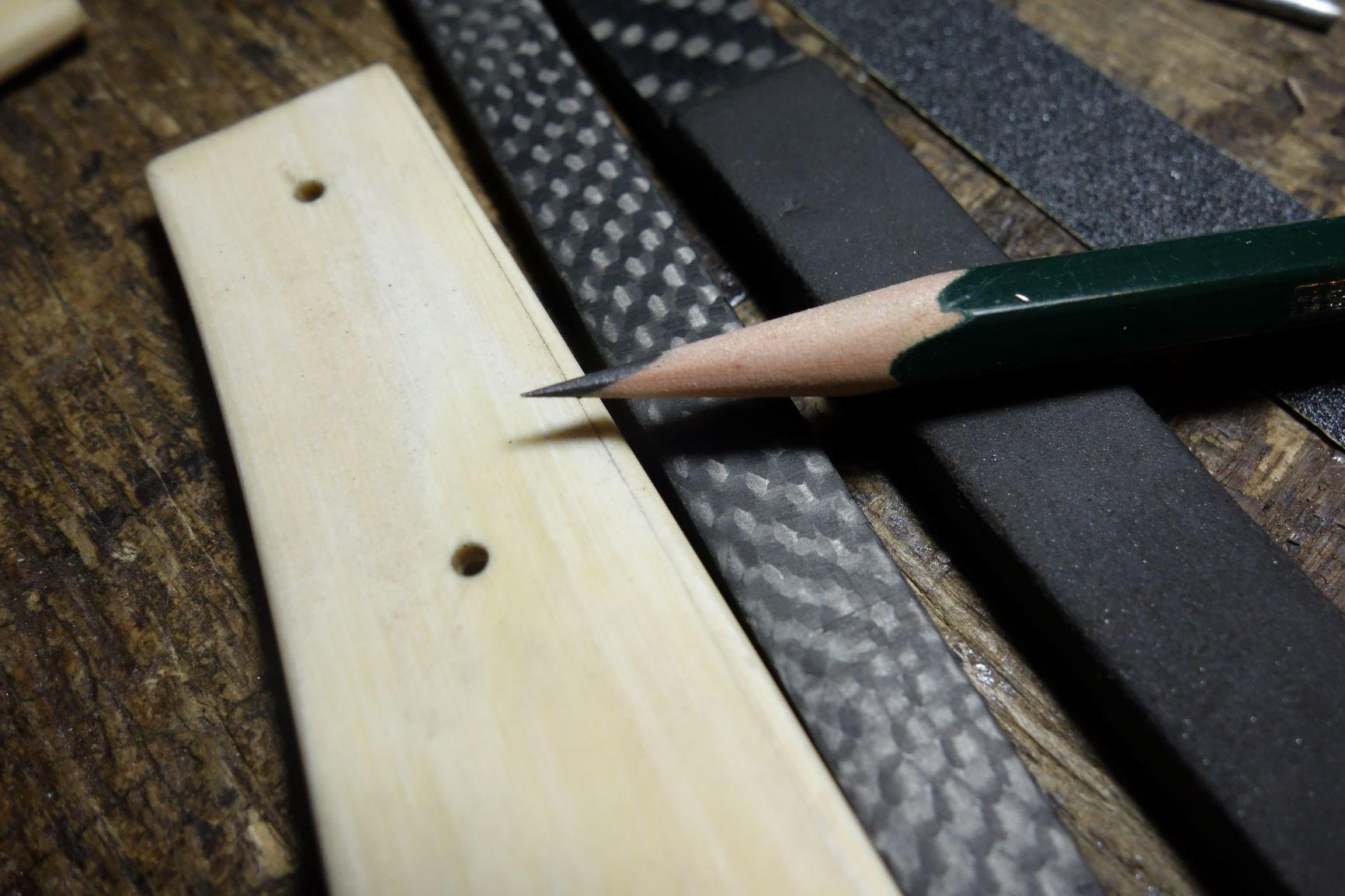

Here is the basic process:
For light material grind a hard pencil super sharp and thin to keep the scribed lines as narrow as possible.
Dark material as horn I take a fresh sharpened steel scriber.
There are three main bevels, one is on top of the scale and two are on the inside.
To speed up the process I take my belt grinder with variable/adjustable speed.
I grind with a very low speed and a medium sharp 240 grit belt
and grind the three bevels on the rubber covered contact weel.The bevel which is closest to the tang is difficult because it is very flat.
This flat bevel is done safely by sanding by hand.
Then I connect the bevels by rounding them up with a sandpaper file.
You can do the whole process with sandpaper but with a belt grinder it is faster and the alignment of the bevels are more accurate.
The amount of the material which is removed is so small that you really have to watch out not screwing it up....
Work slowly and with patience then it will turn out well, that's it.
Cheers
