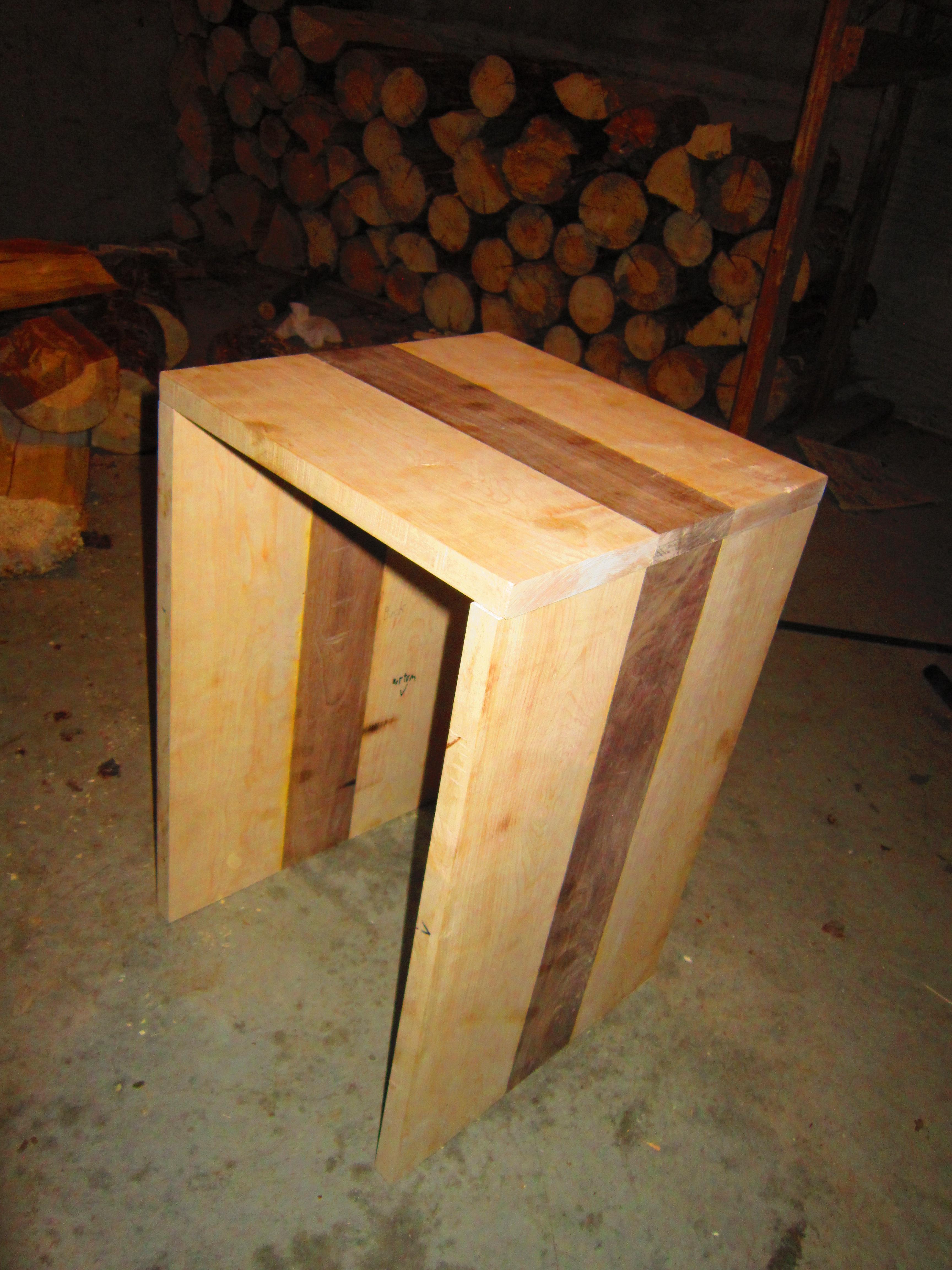

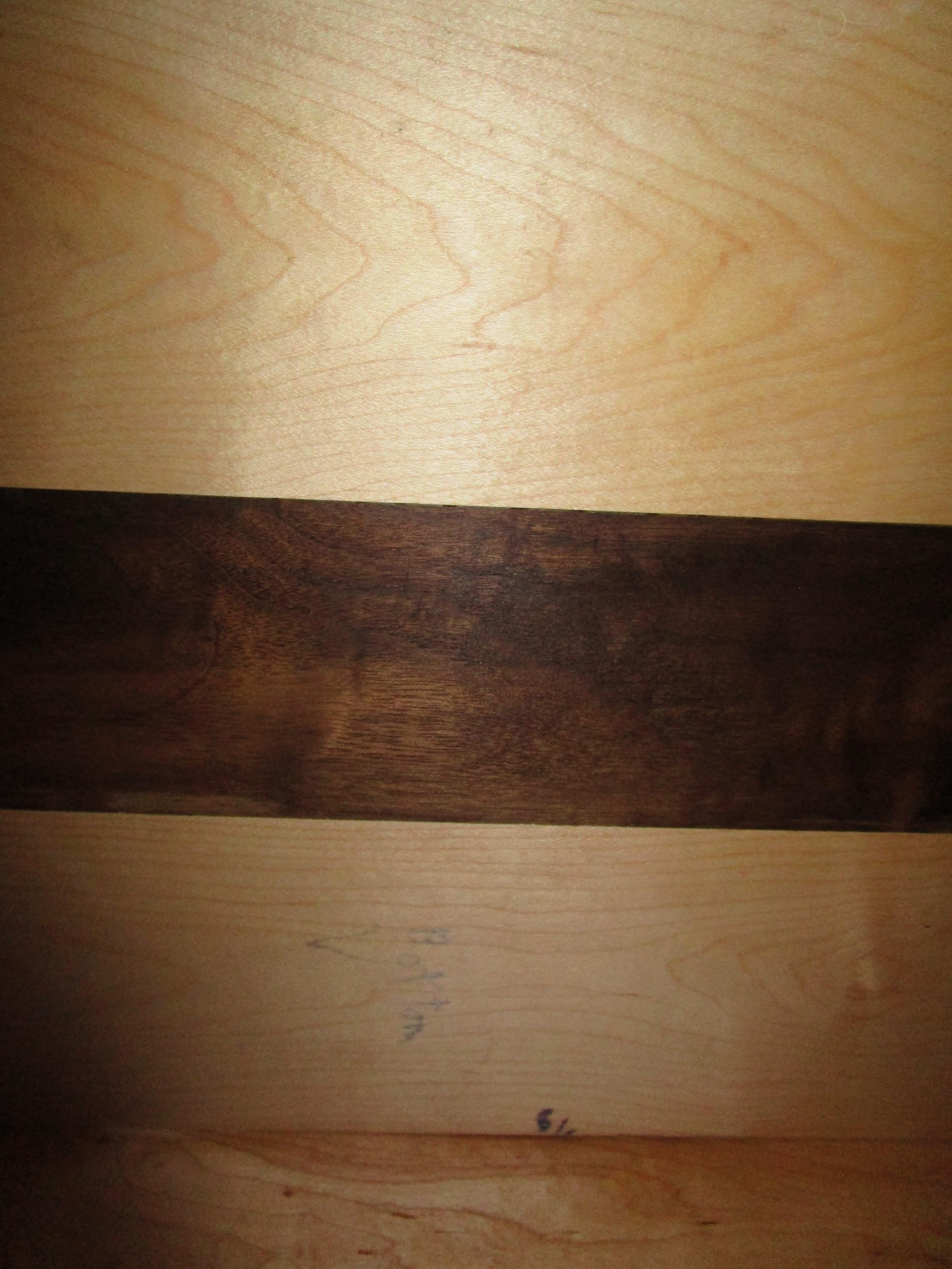

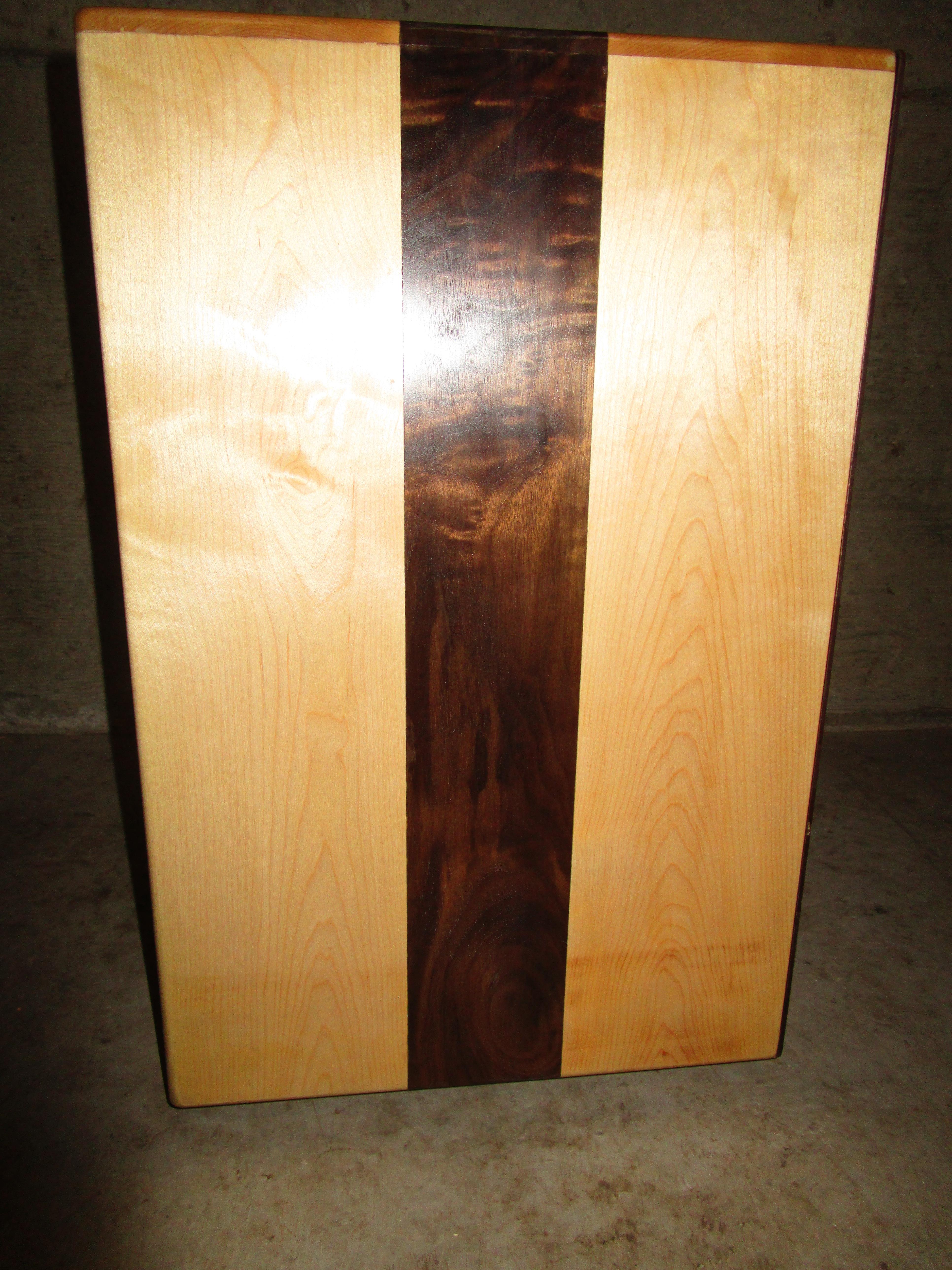

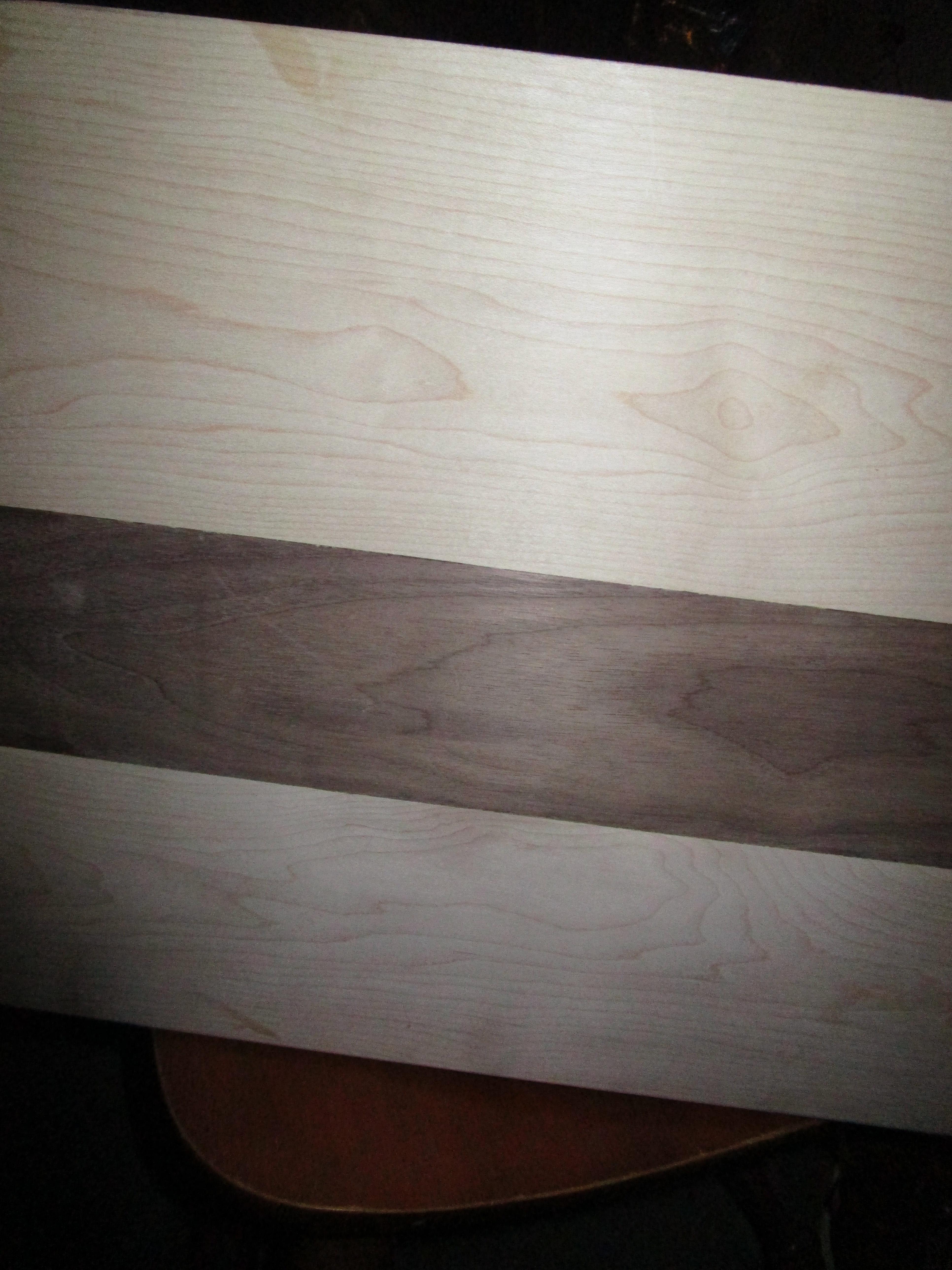

now for what I'm working on currently: A Cajon
for those who don't know a Cajon (Spanish: box) is a wooden percussion instrument that consists of 5 sides  1/2in. to 3/4in. of plywood or solid boards and the 6th is a thin (3/32-3/16) sheet of plywood
this one should come to a final dimensions of 12.5x12.5x19 inches the wood is maple and walnut 3/4in. with a piece of pine plywood for the bottom side. The front is going to be 1/8th birch plywood

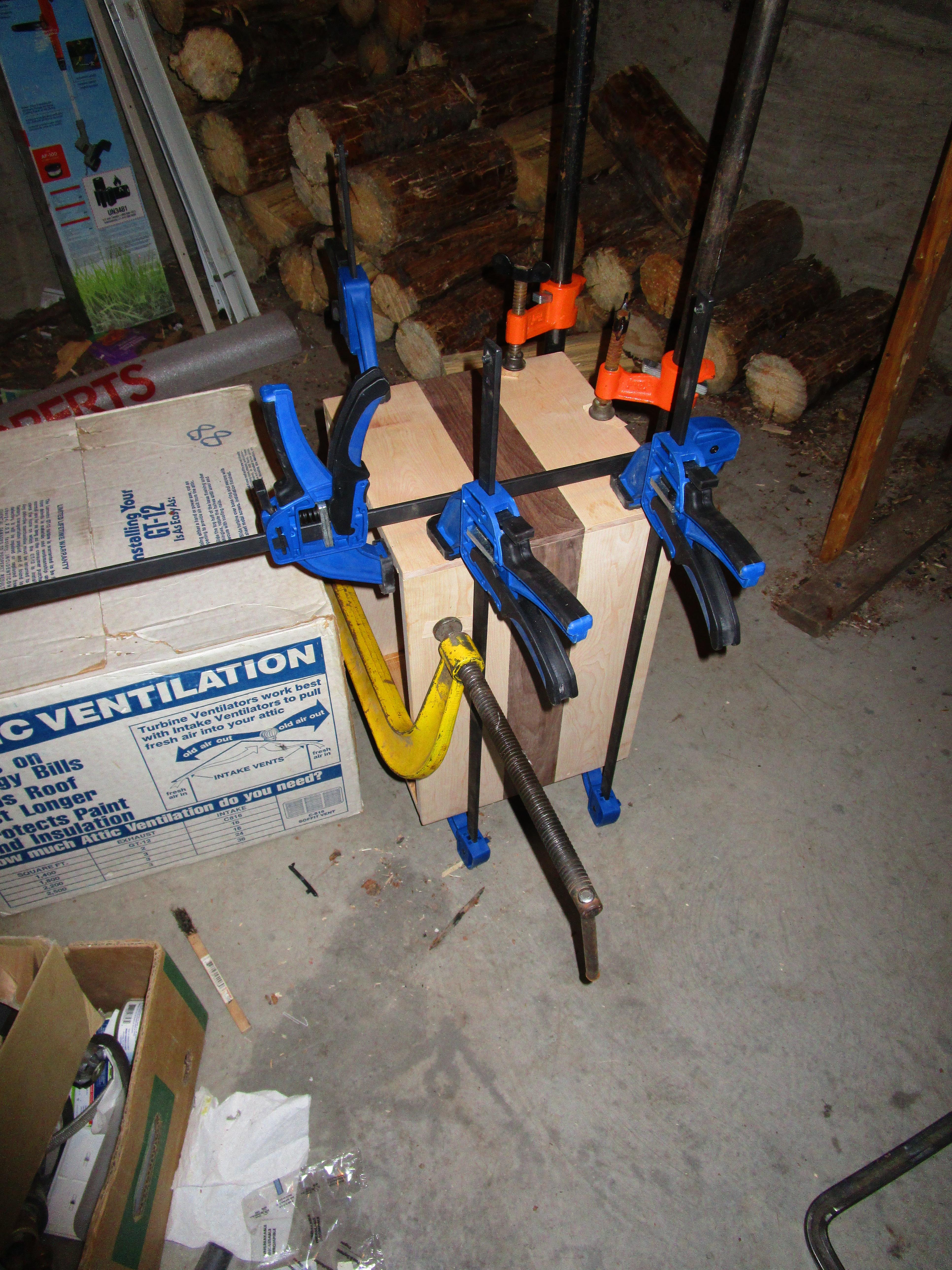

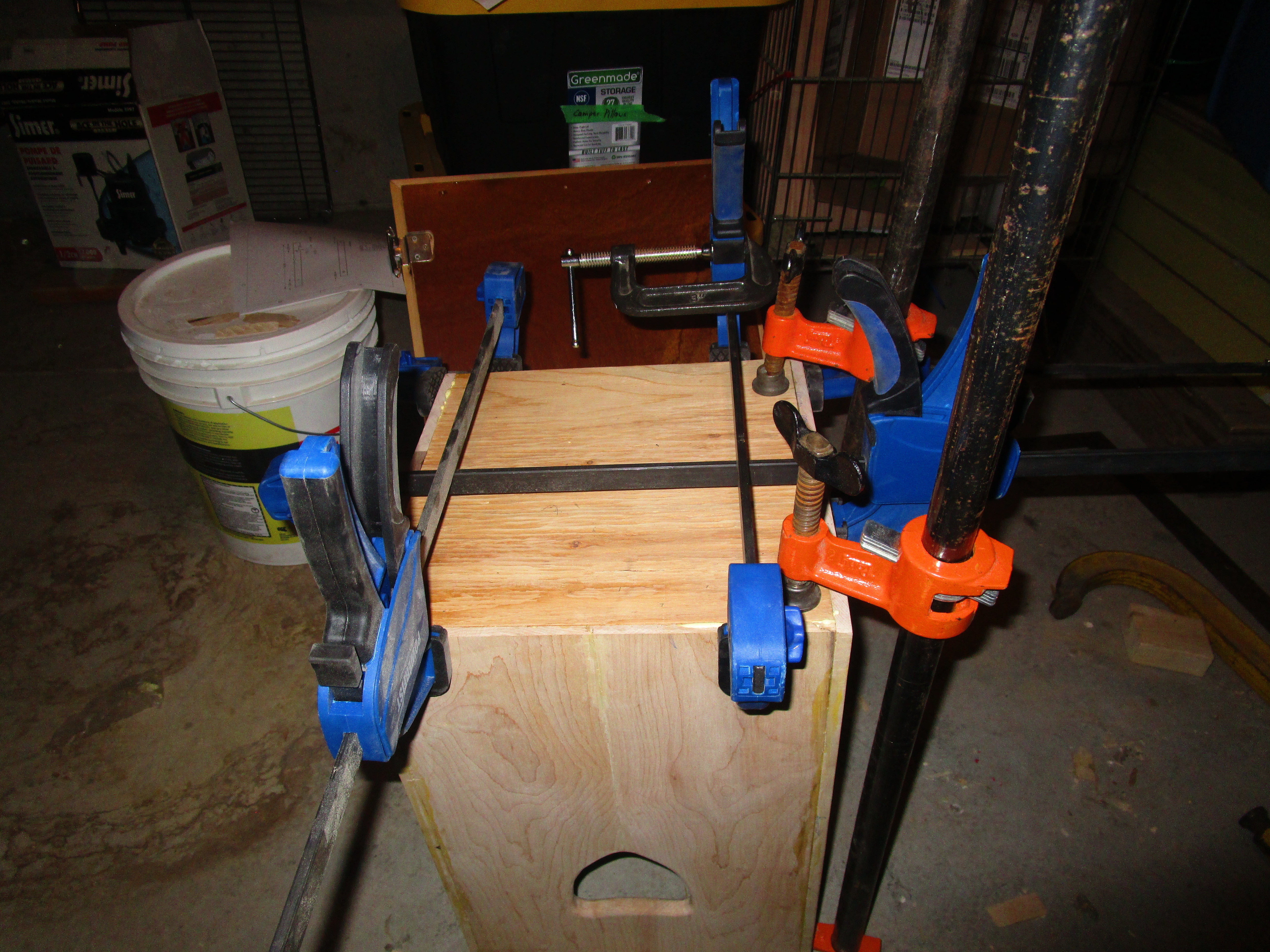

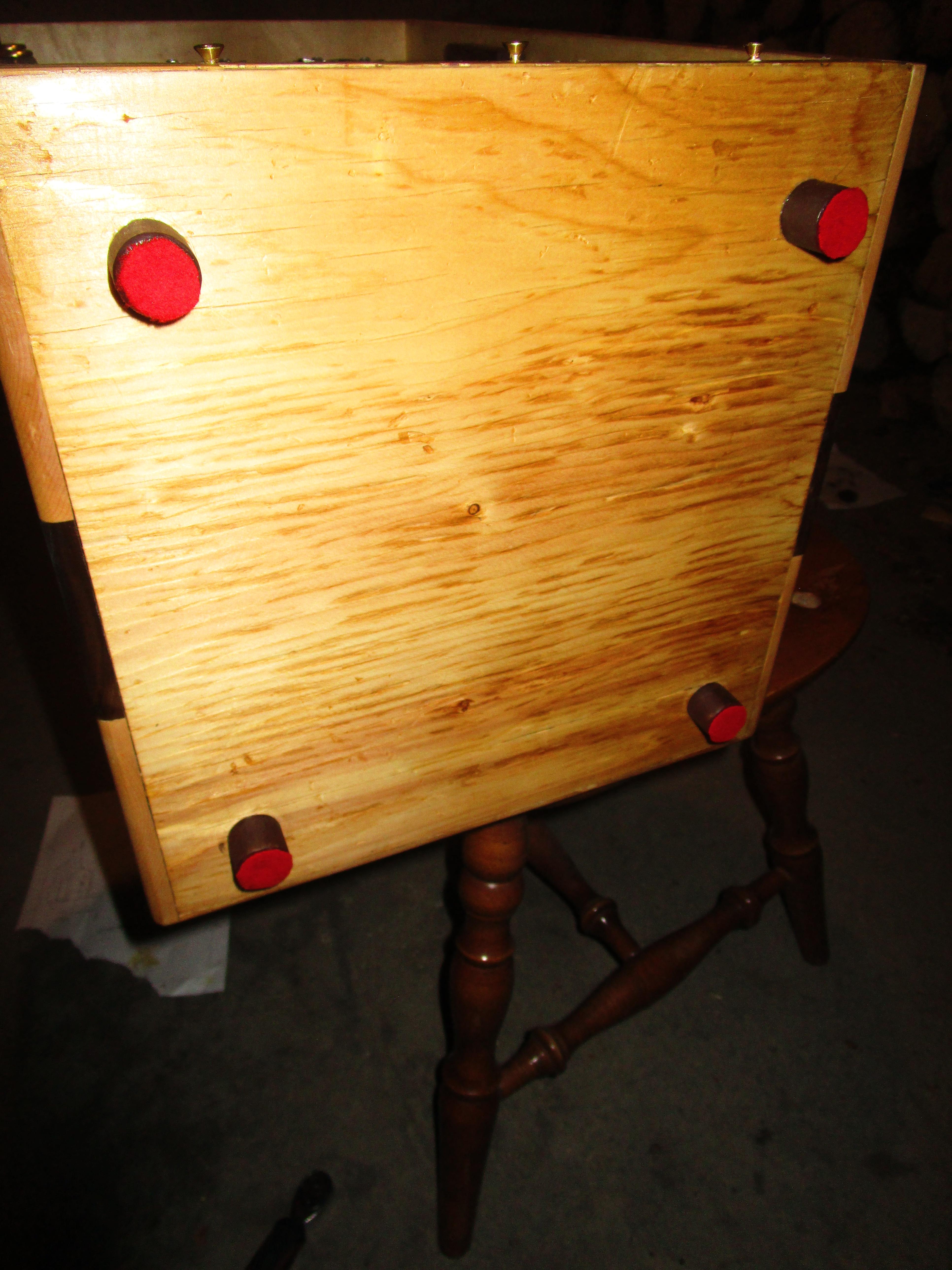

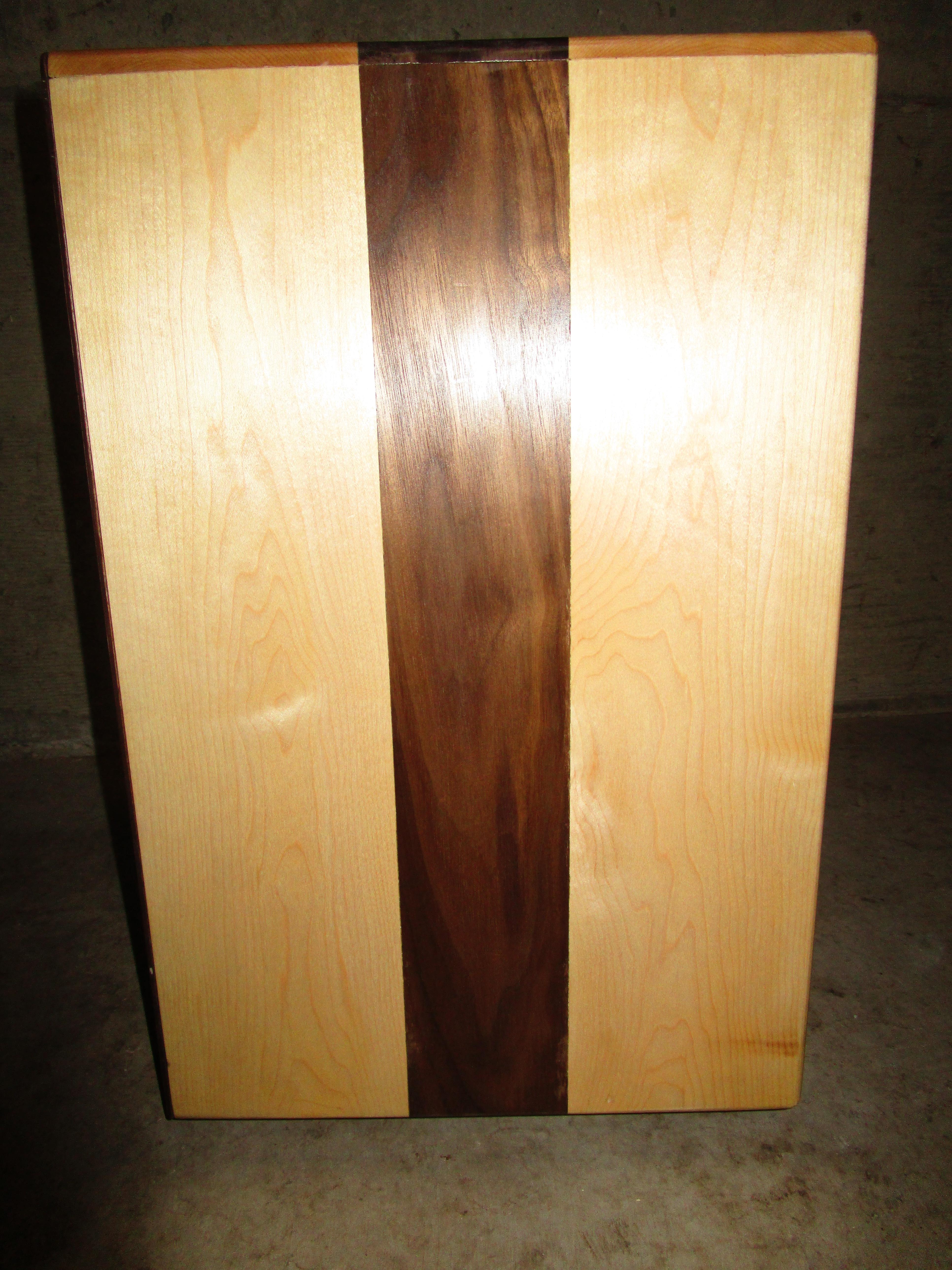

some more progress pics on the Cajon
gluing the bottom on

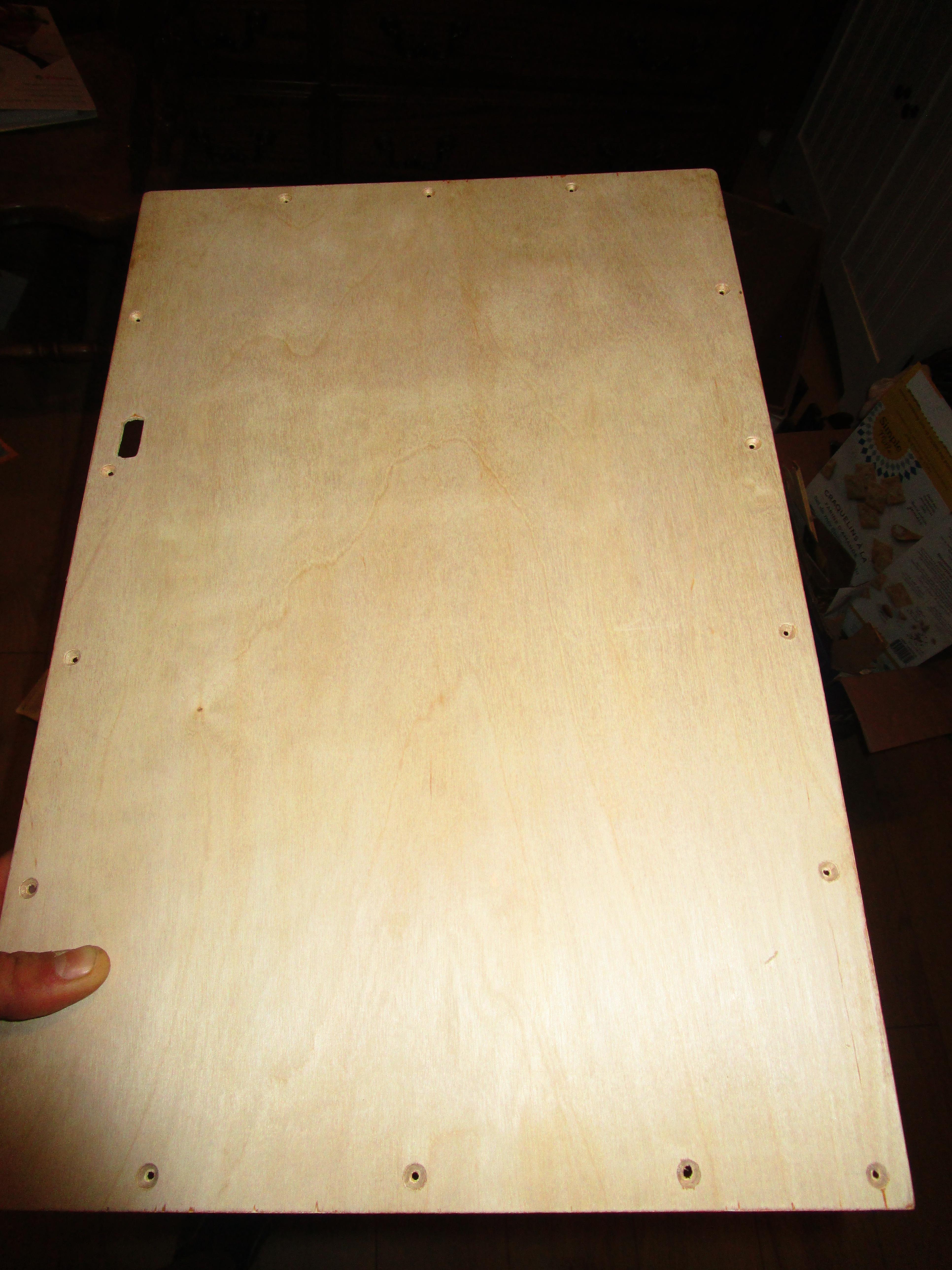

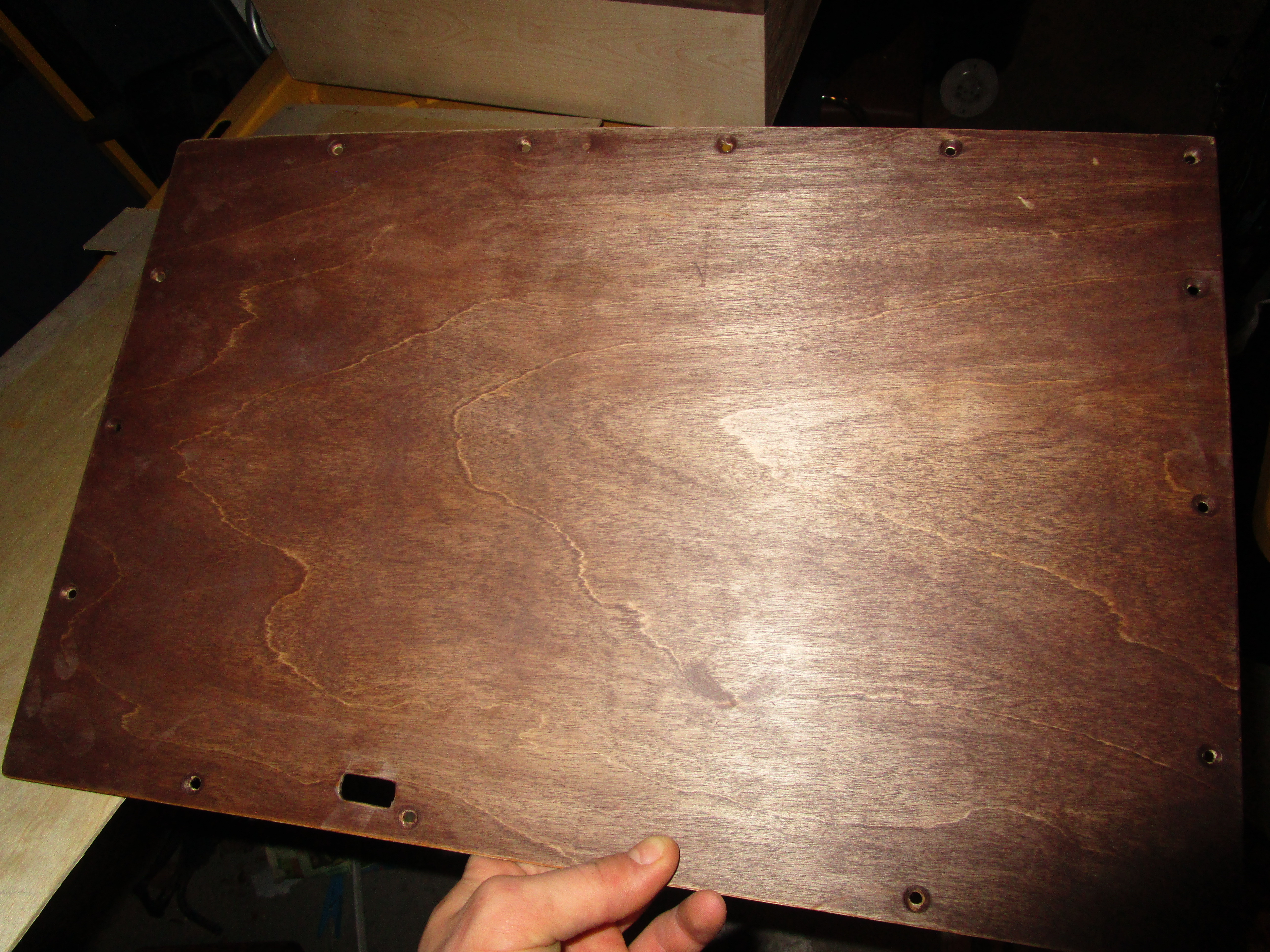

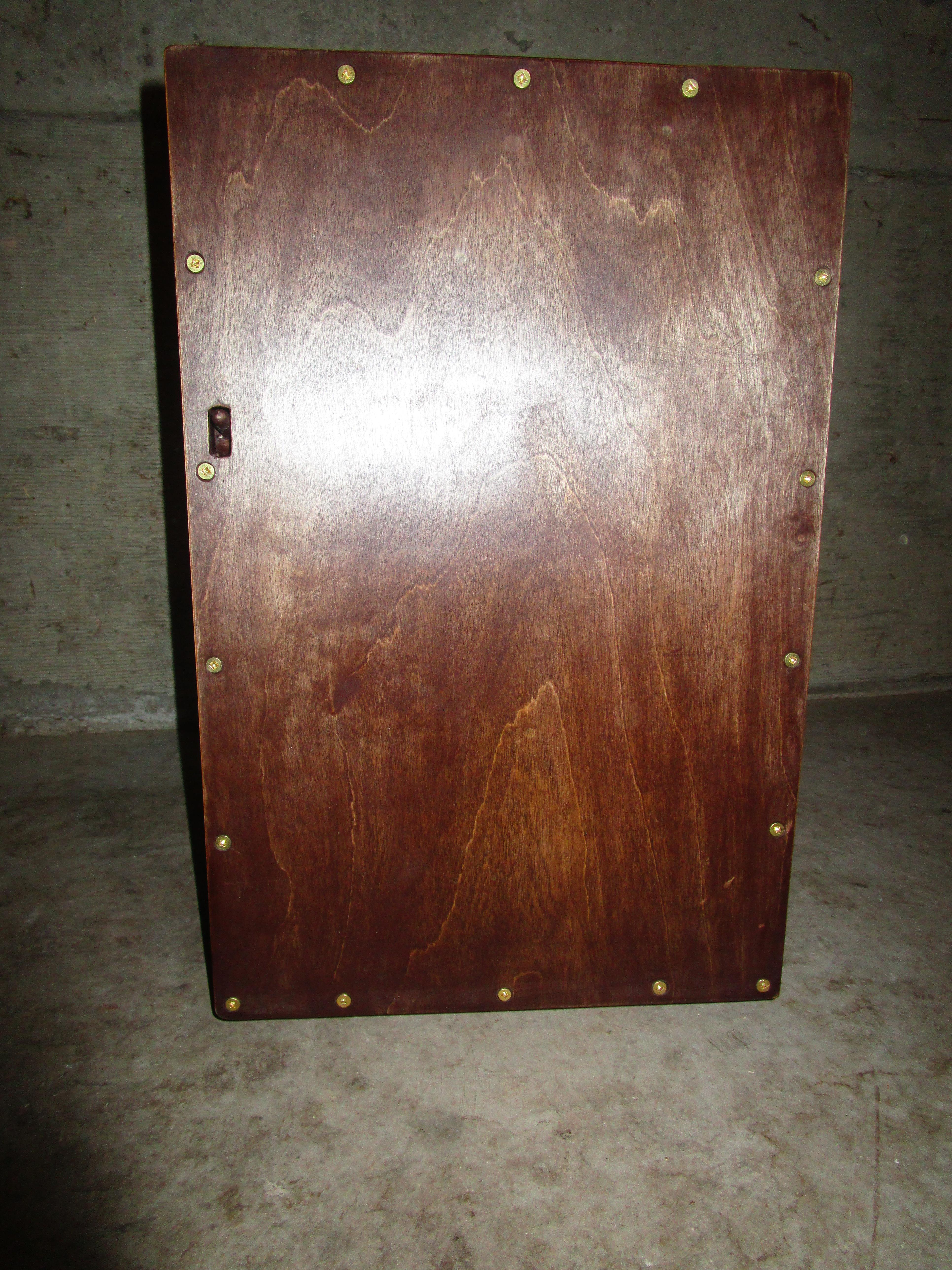

the tapa (front) 1/8th Birch plywood cut and drilled

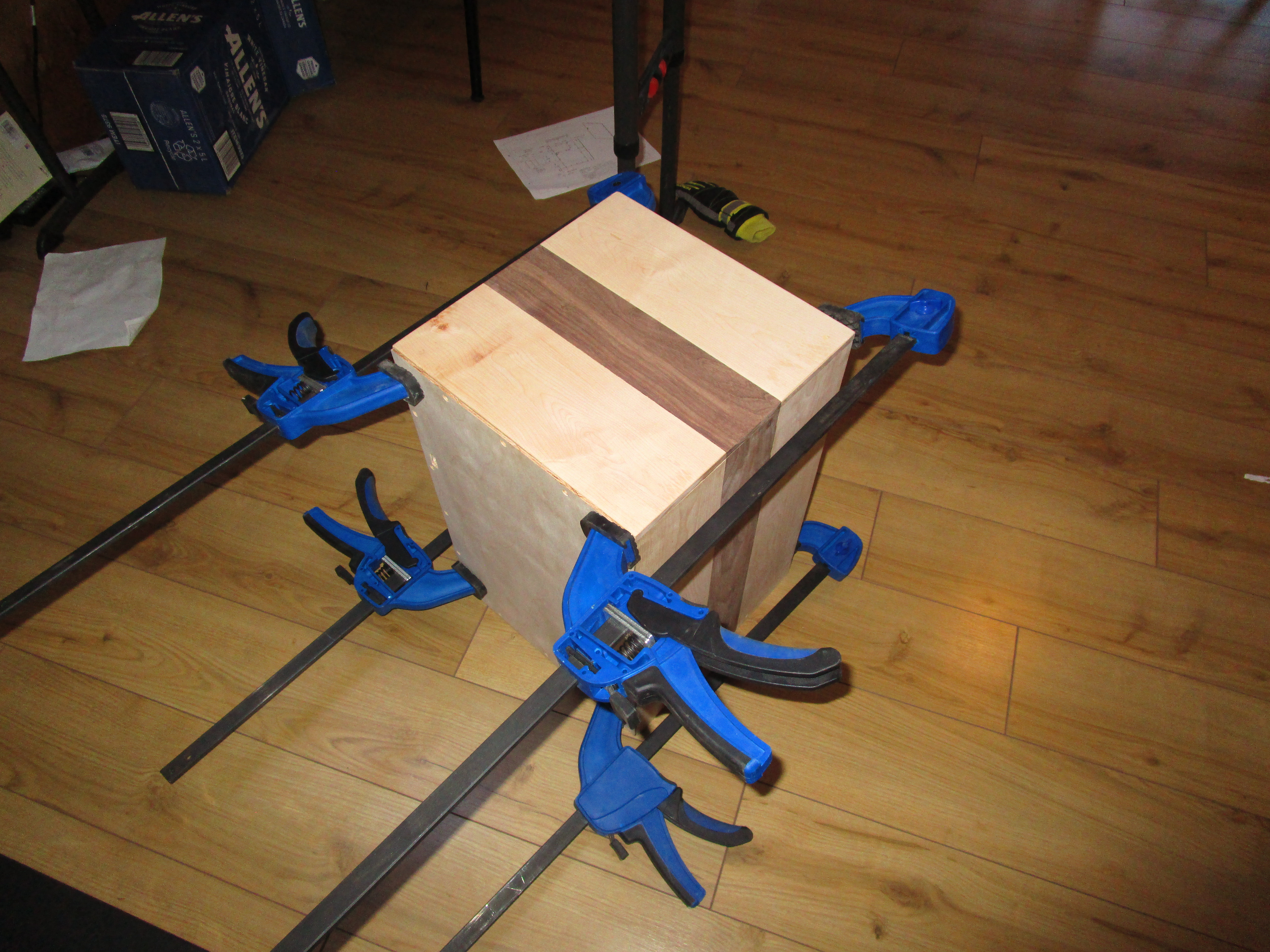

the top being glued on

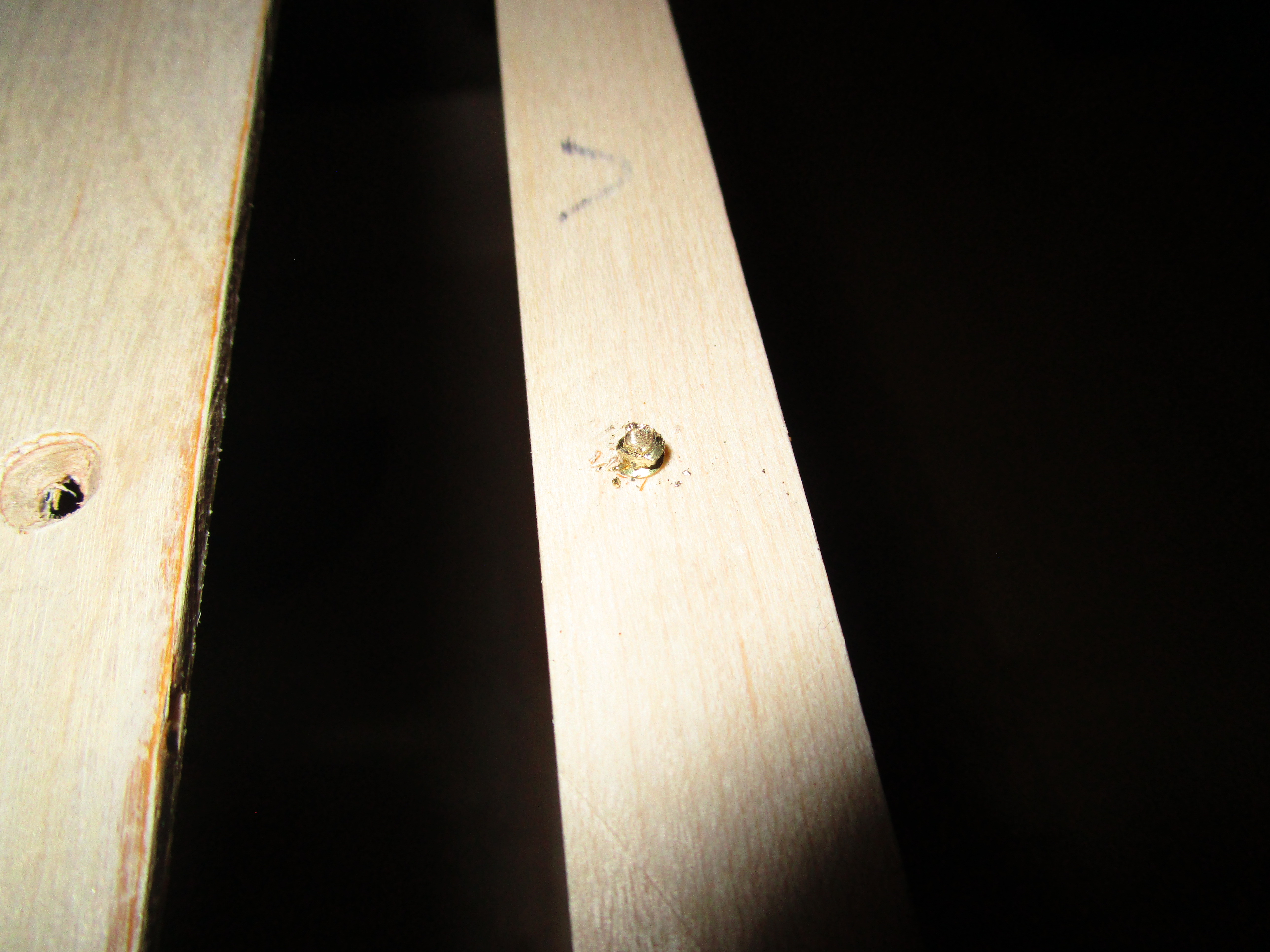

a problem I had last night was that the brass screws are snapping before they get tight I pre-drilled to the specs on the package for hardwood (3/32nds) and it is drilled deeper than the length of the screw i had the clutch on the drill at 4 so it should have been low torque.

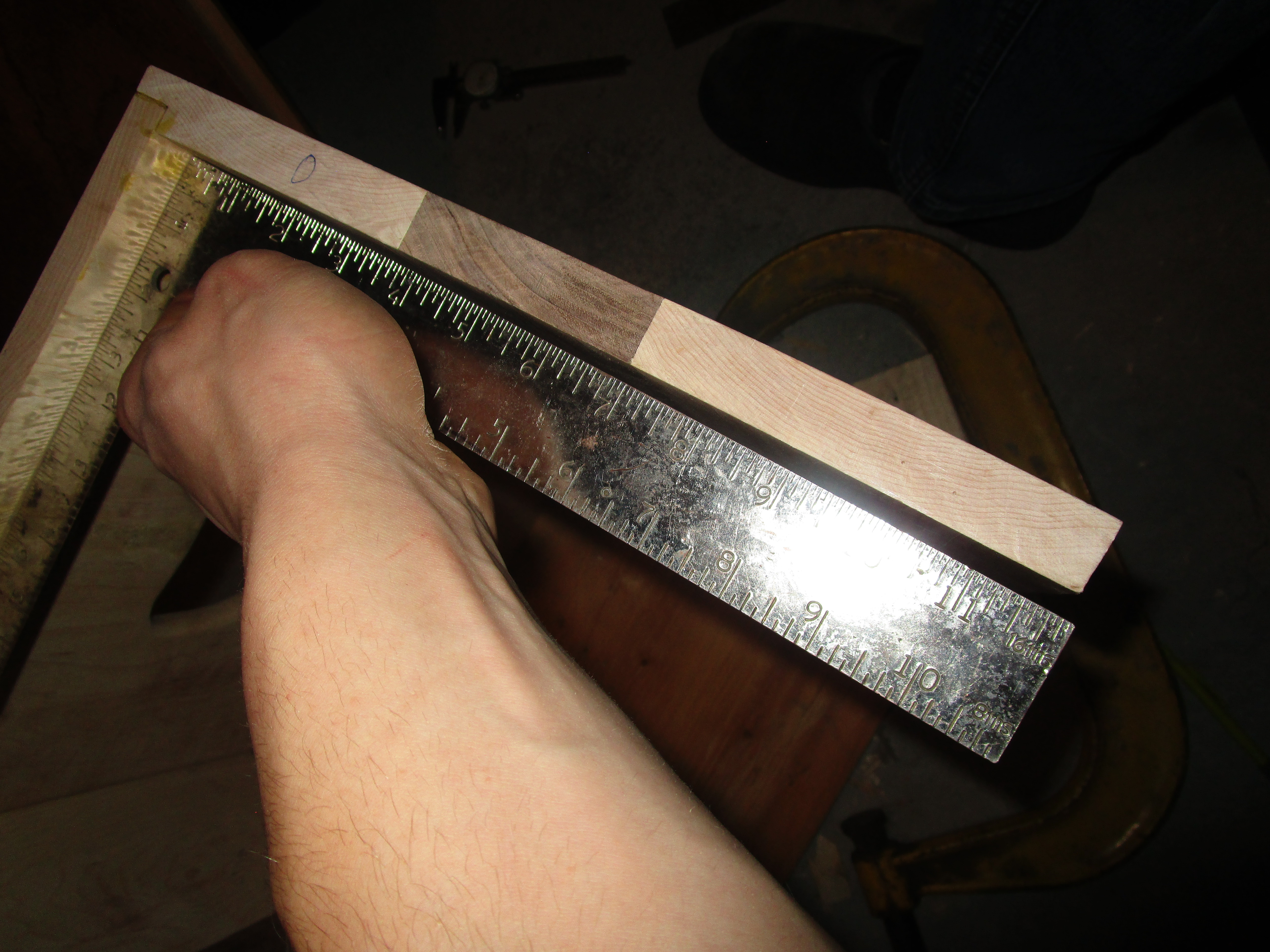

also just how bad I am at making things square

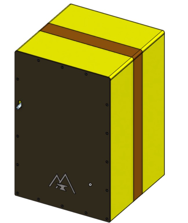

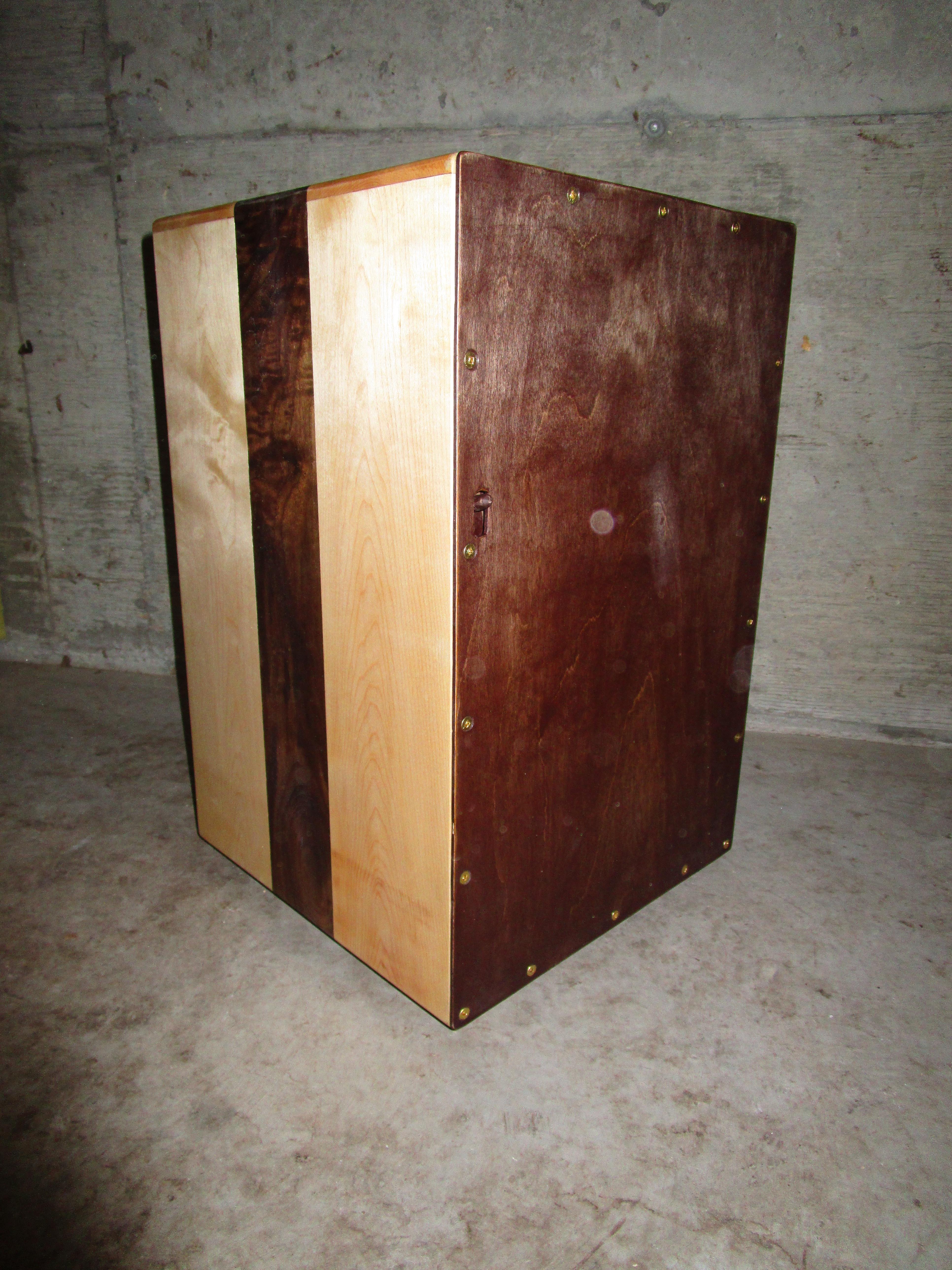

finally a mock up of what it will look like (before finishes applied)
have a great weekend

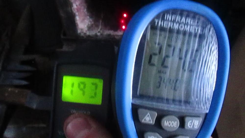

a while back n it followed me home i mentioned this laser thermometer it sadly but expectantly fell out of their given accuracy currently contacting them so will se if they will fix this problem

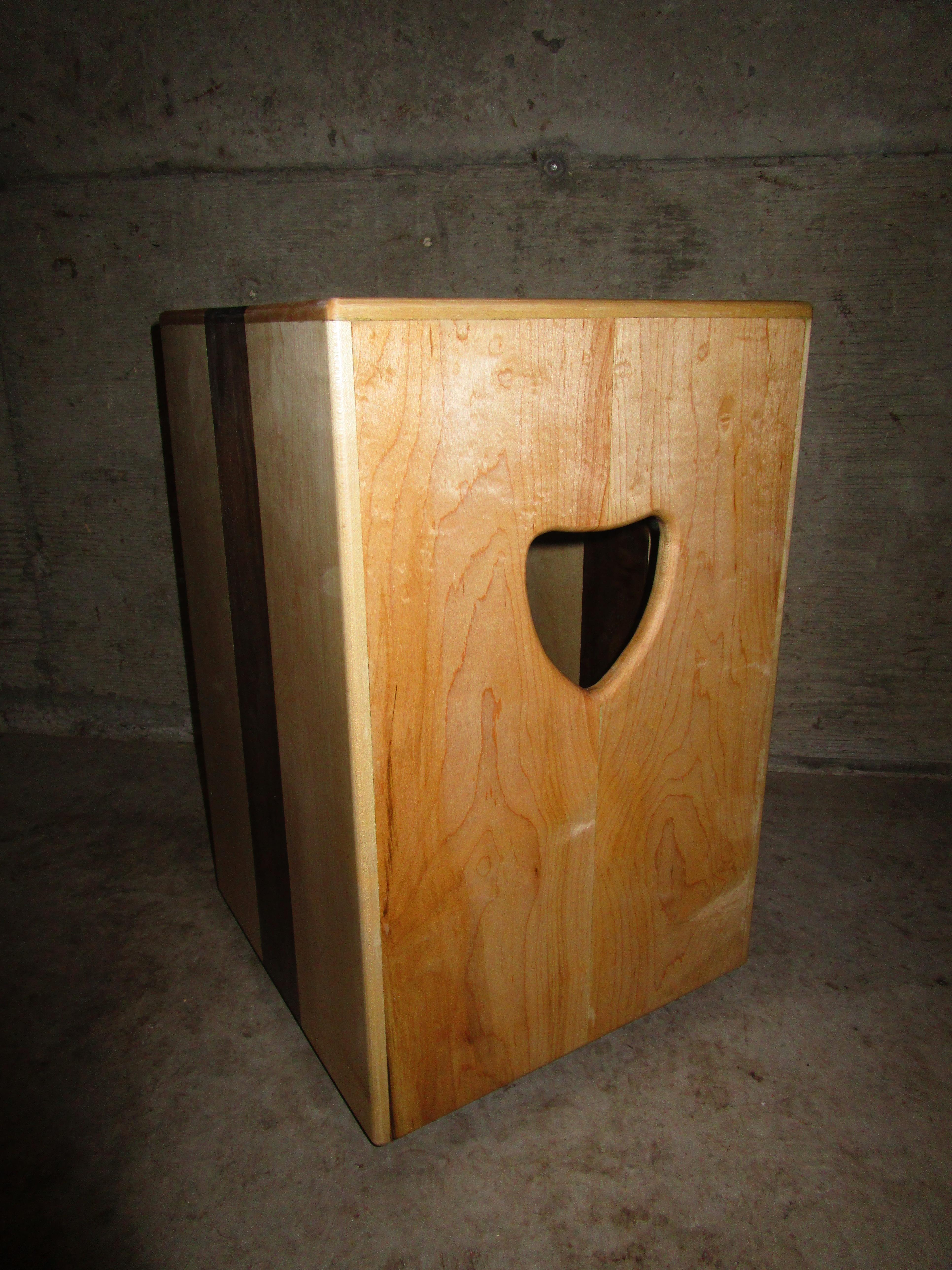

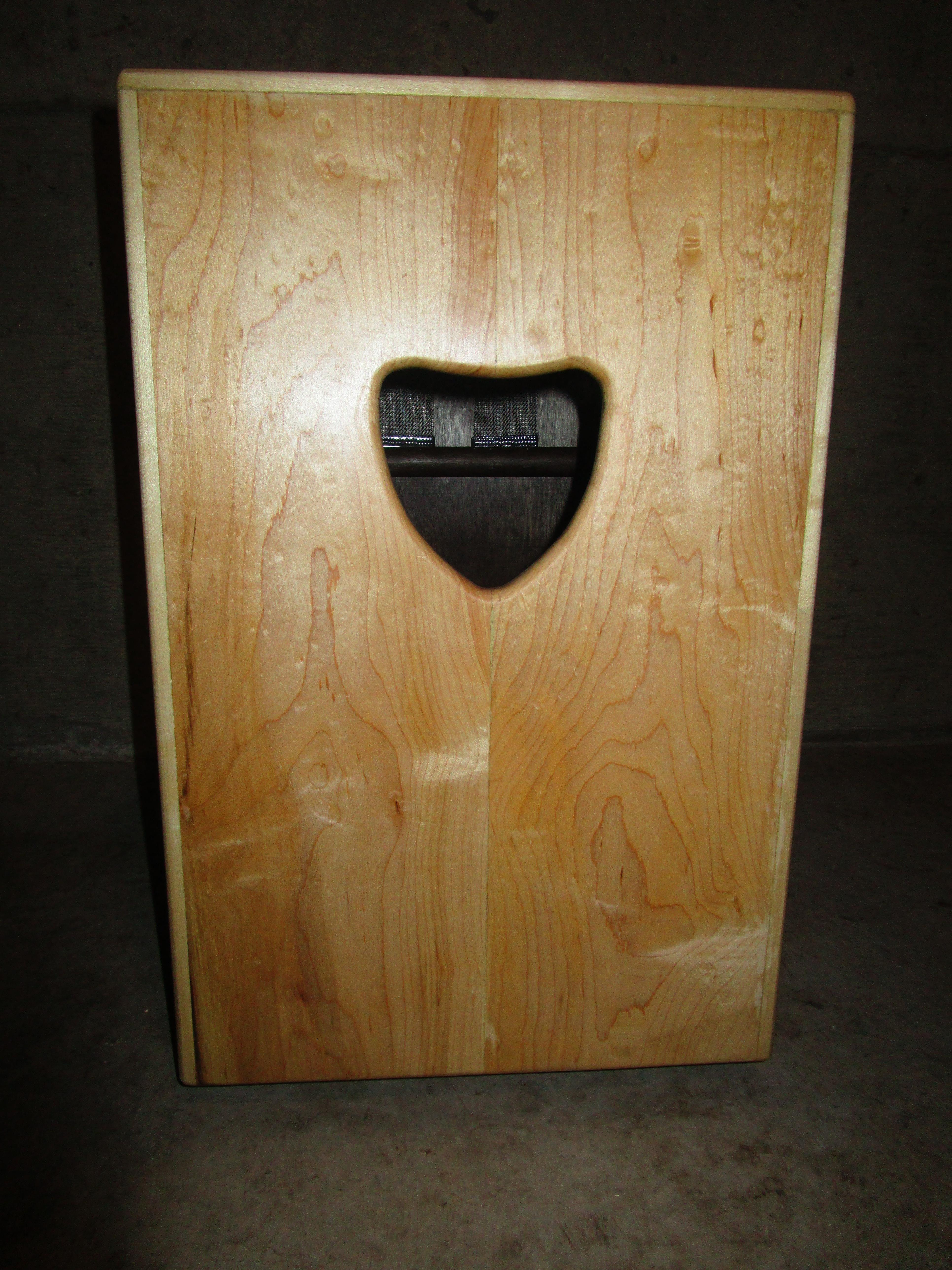

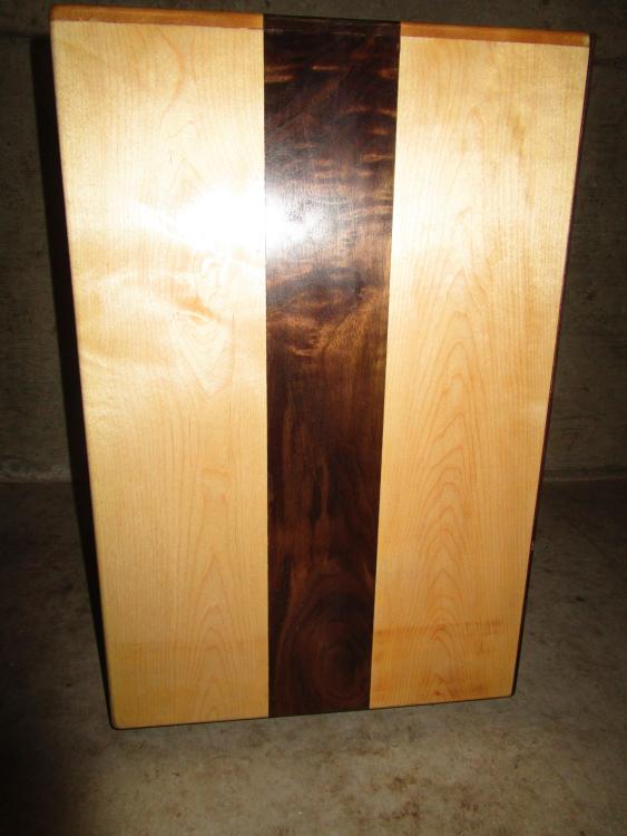

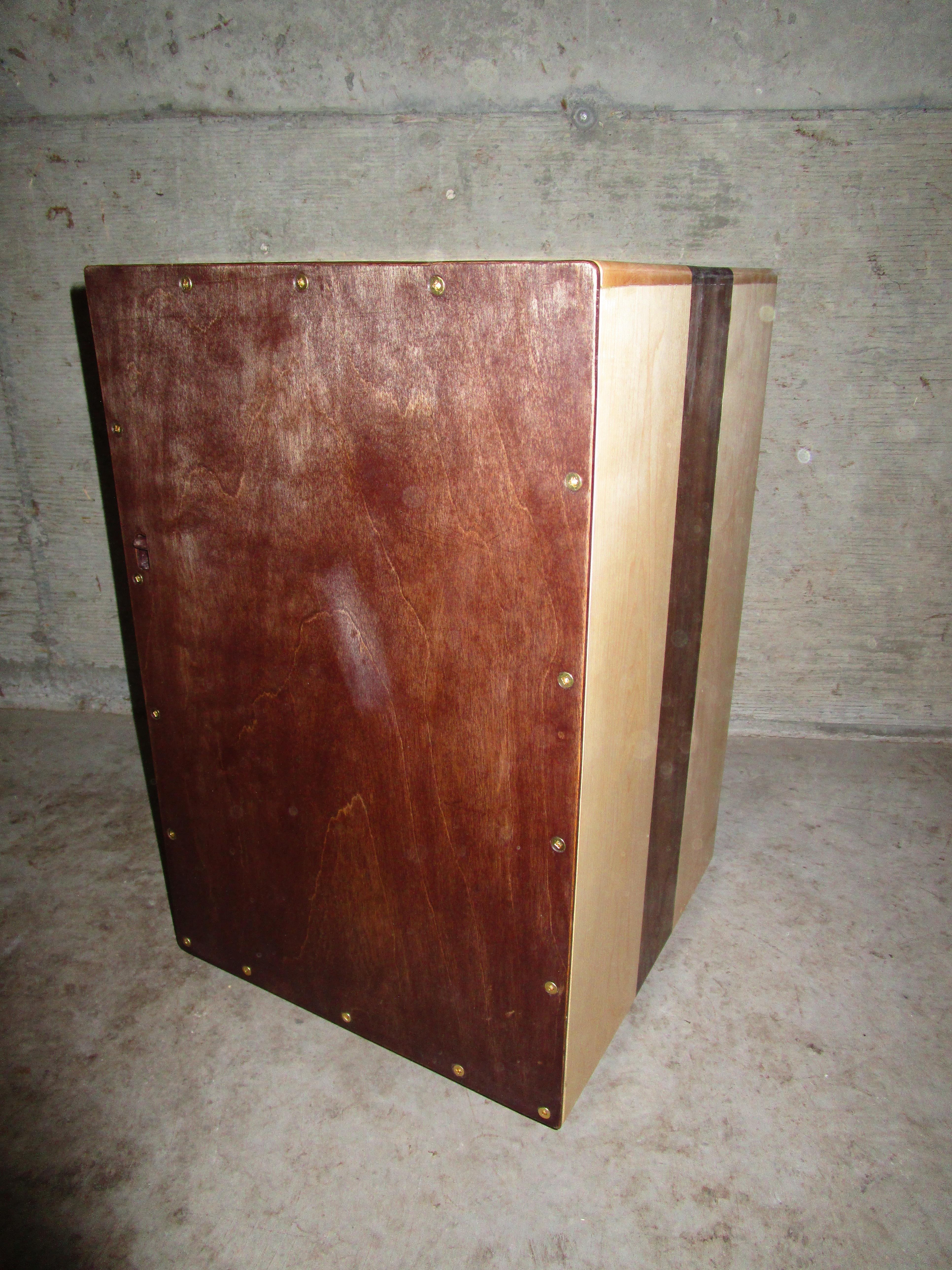

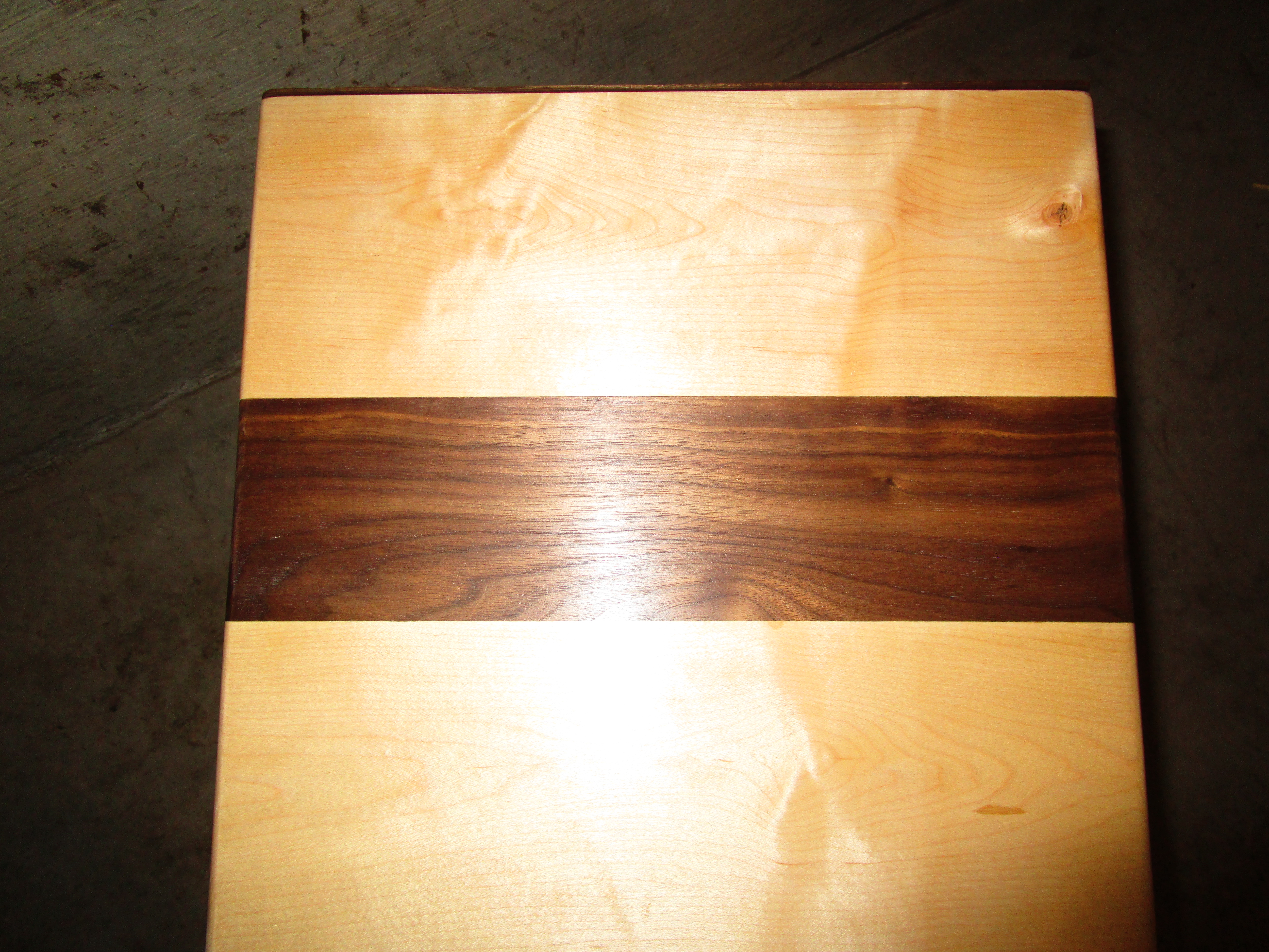

ps also got the front of my Cajon finished one coat of finish to goIMG_0070.thumb.JPG.2b4150baaec882d7922ab68d1917444a.JPG

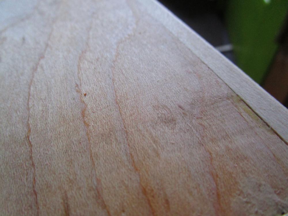

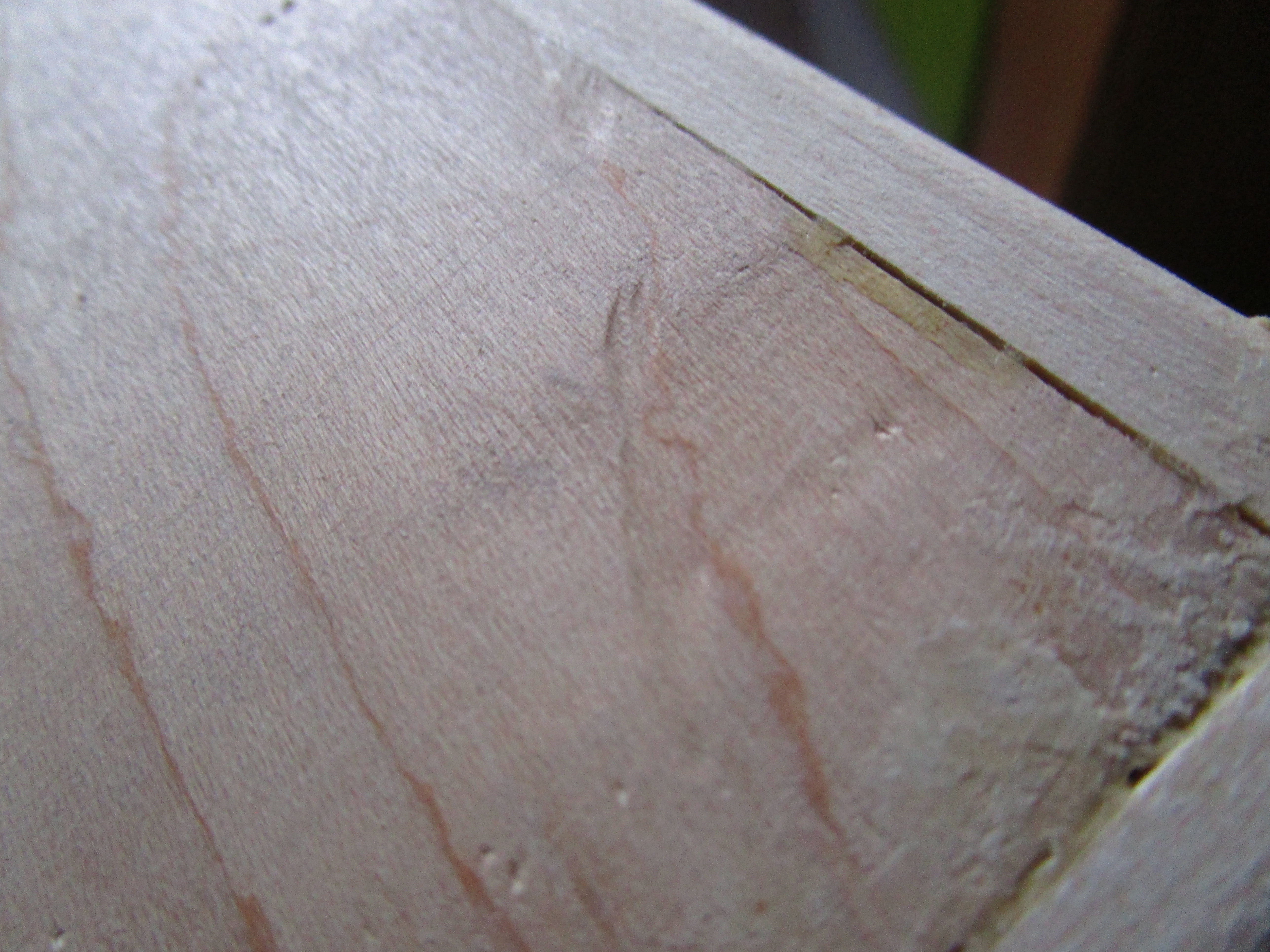

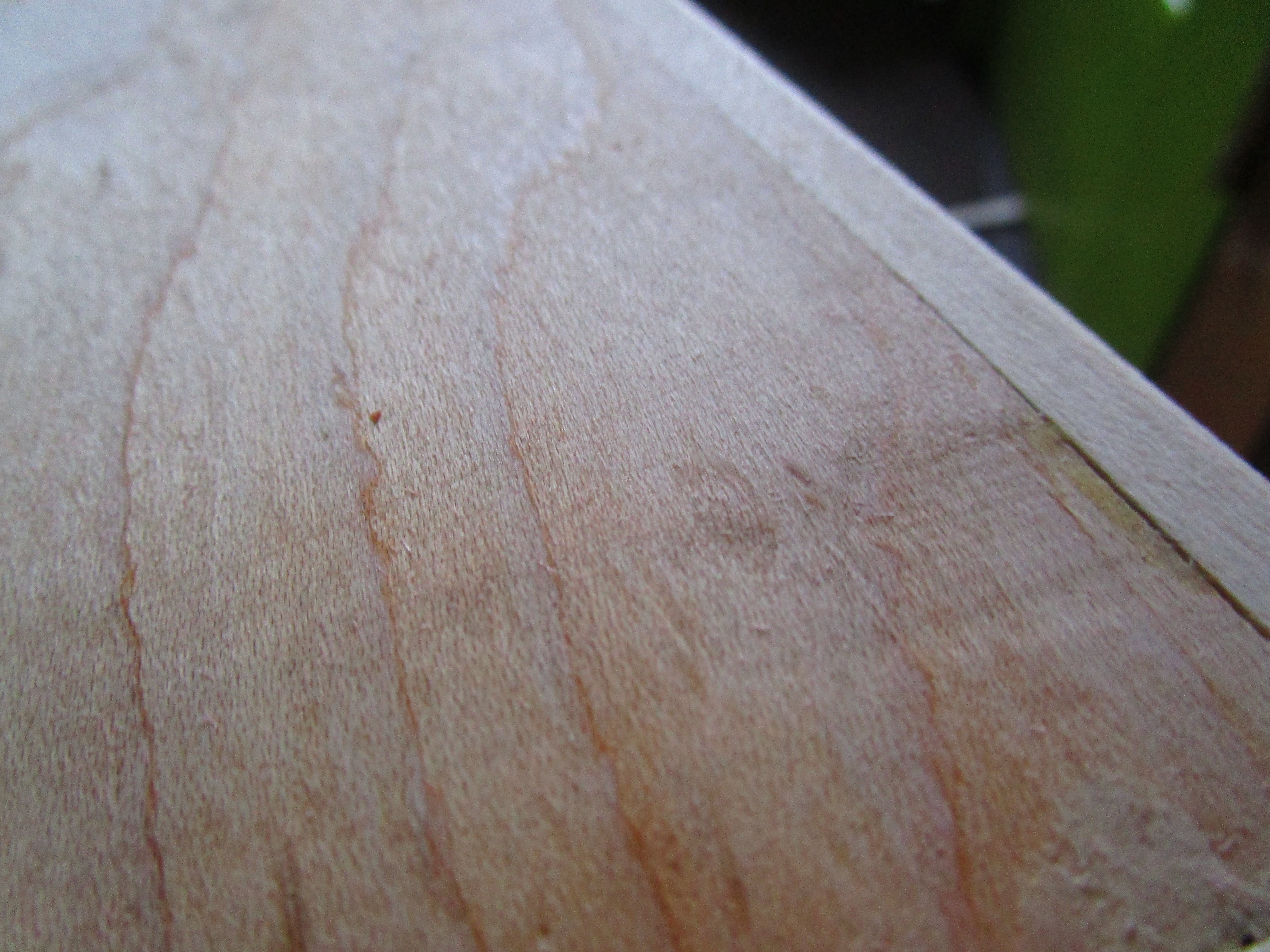

also some more progress on the Cajon, I am thankful that wood can have dents steamed out

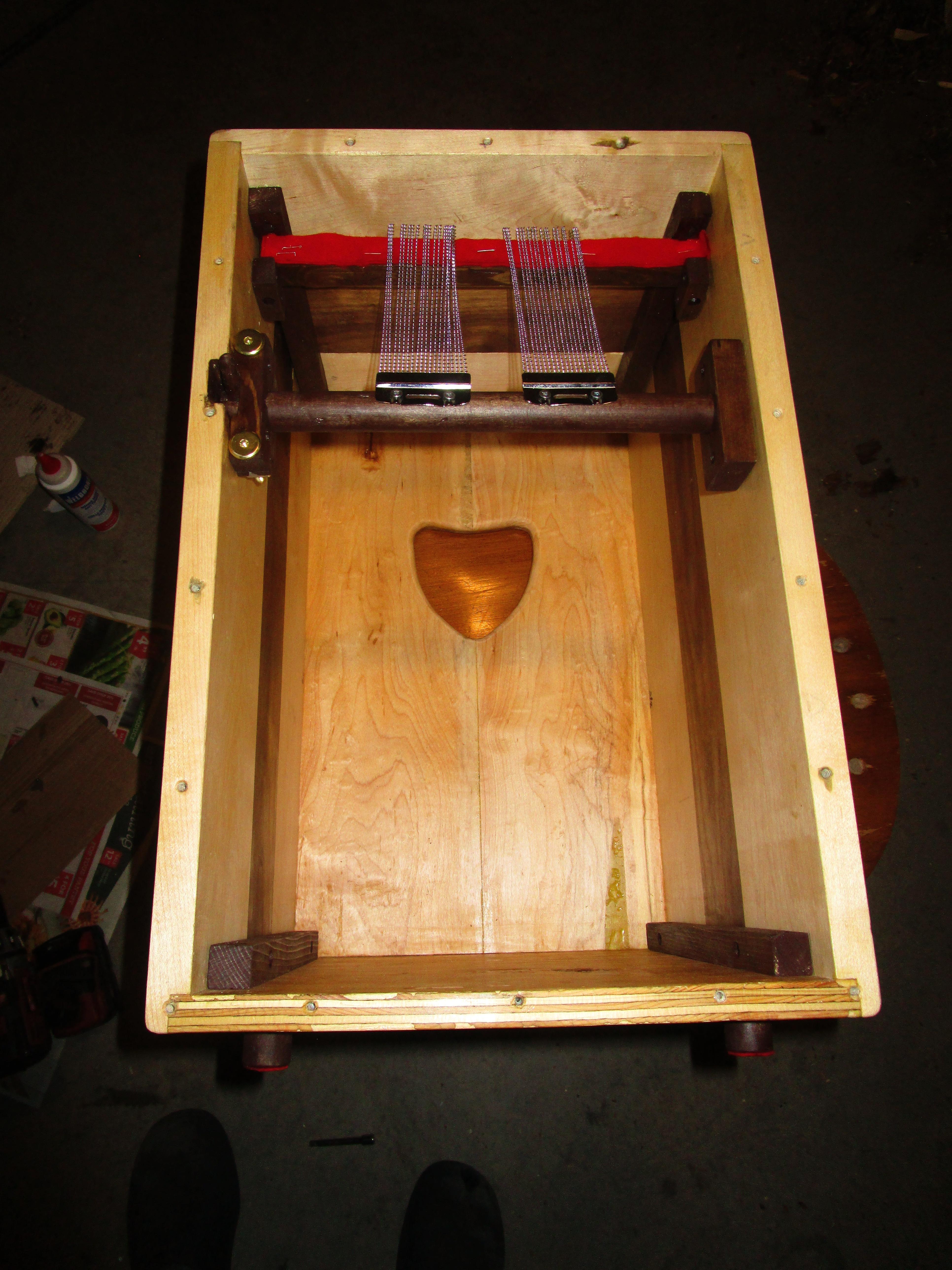

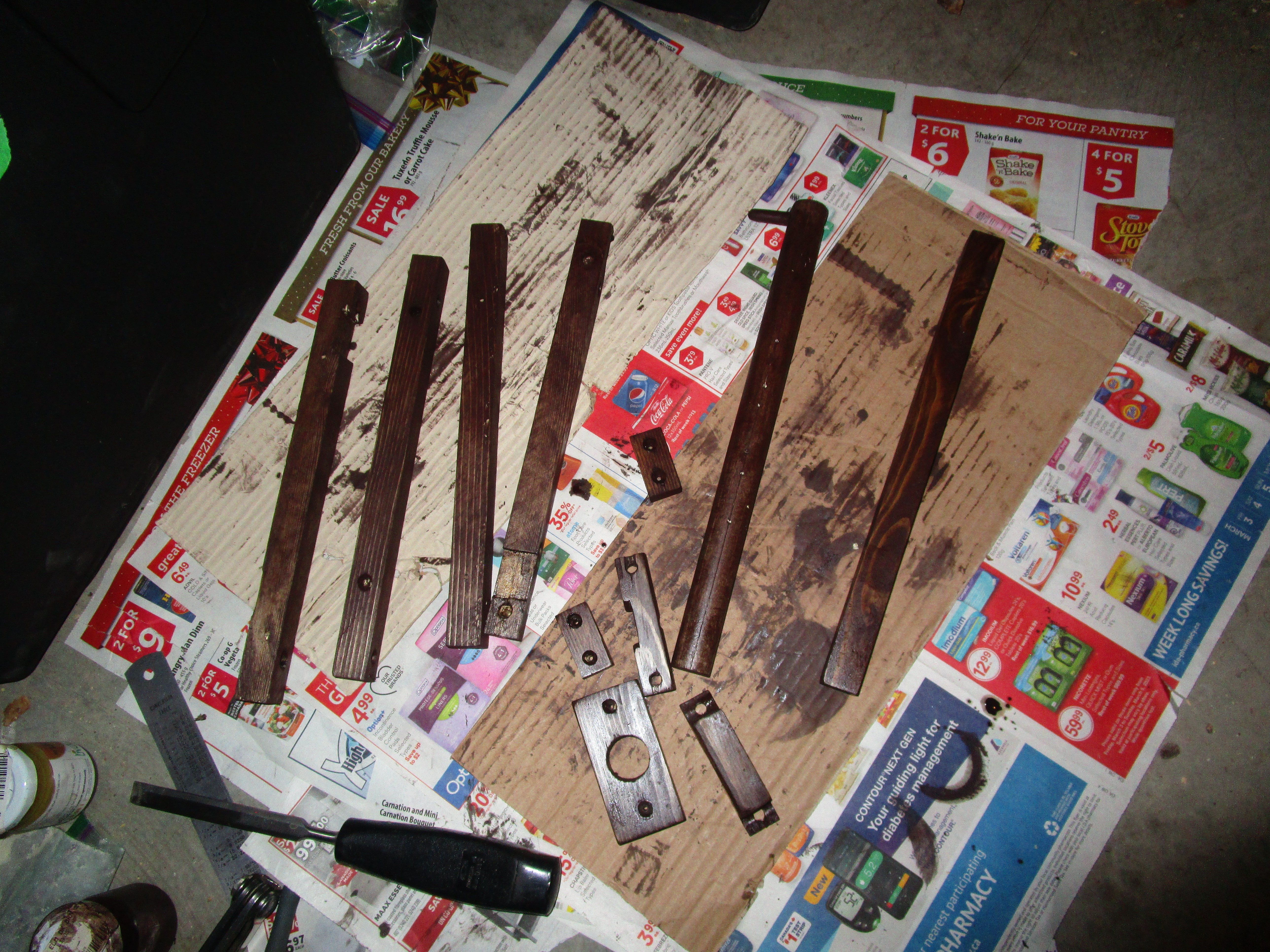

a bunch more parts finished just have the main box to finish now, got 1 coat on the inside and might get the second tonight
M. J., a tip for you when working with brass screws...even though you have predrilled the holes...I always use only a properly fitted screwdriver and scrape a tiny bit of wax (candle, beeswax, floor wax, etc.) on the screw threads.  Brass screws are notorious for breaking and the use of a screwdriver lets you feel the torque on the screw so that you can stop before breaking it.
Beautiful Cajon!  Nice work.  Looking forward to the video (with sound, of course!)
