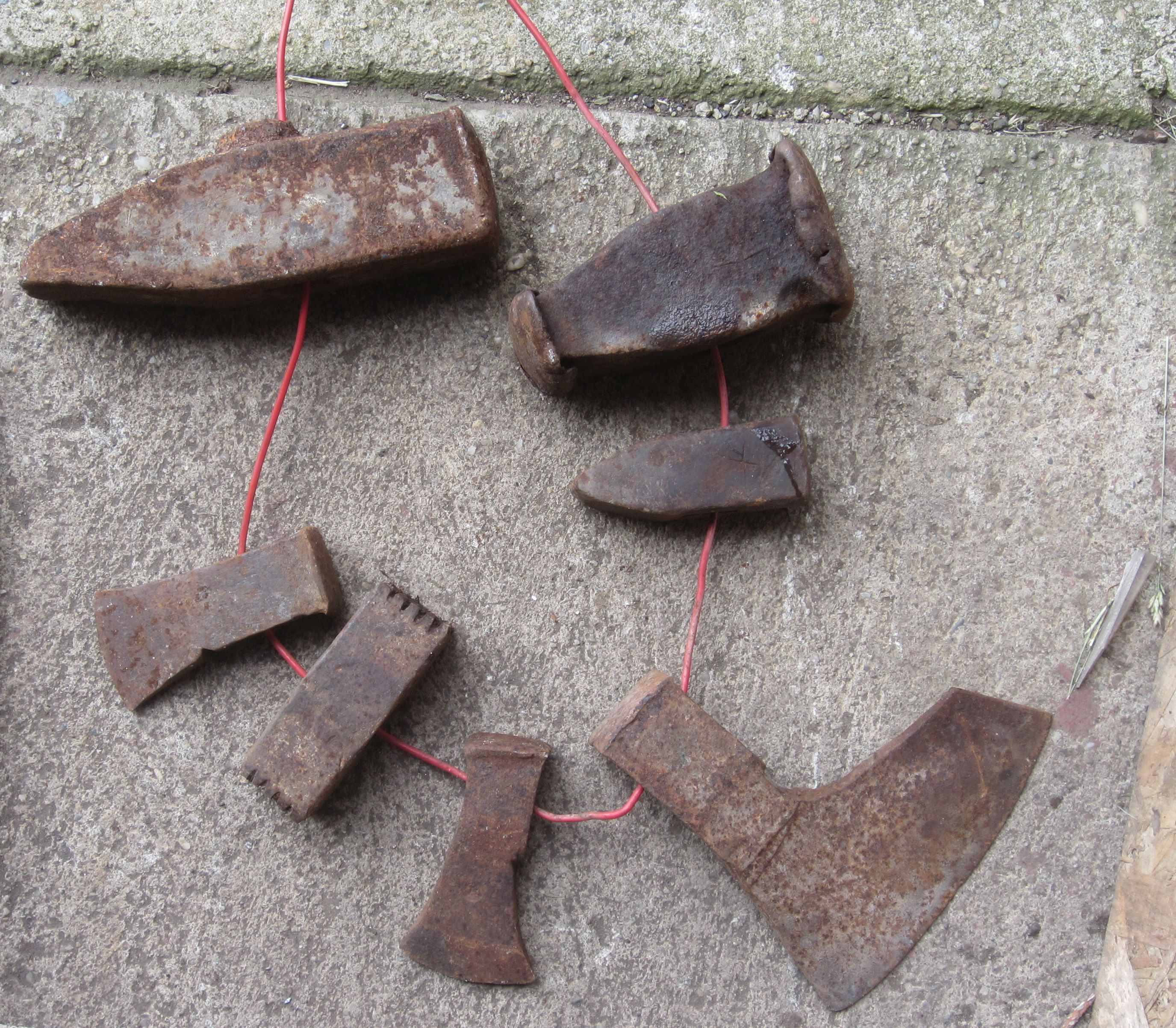

Gergely Posted June 13, 2016 Share Posted June 13, 2016 (edited) And 202! I tried to switch to the next page but not yet. Well I actually have something to say here Hit two scrapyards today searching for some SS. Didn't find what I wanted but took some SS flat stock, some wrought or maybe wrought, a bunch of beaten up hammerheads (incl. a 11 pounder), 3 old axes, and some old milling cutter tools. Not bad, but SS costs, so better to do something nice from it and sell away... Best: Gergely Edited June 13, 2016 by Gergely mishap Quote Link to comment Share on other sites More sharing options...
Gergely Posted June 13, 2016 Share Posted June 13, 2016 I took some pictures because it's not fair without it. The wide headed axe is in mint condition, only some cleaning and re-handling needed. It might pay for the whole lot... The two small axes need to be draw out, they have enough material left in them though. Todays quiz: How can one beat up a 3 kg/6,5 lb hammer so nicely? The cutters. I just noticed there's a drill stuck in a Morse what's-its-name. Bottom left. WI and maybe WI. And a good rasp. Mostly 1 1/4 x 3/8 (30x10 mm) flat SS stock, the longest being about a yard. Quote Link to comment Share on other sites More sharing options...

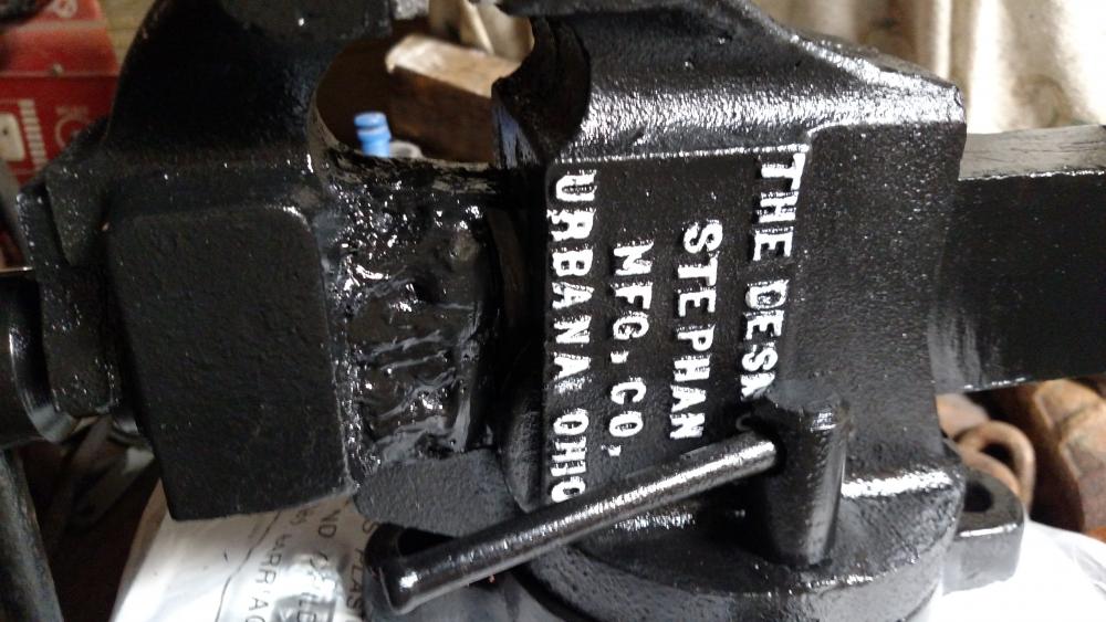

boisdarc Posted June 26, 2016 Share Posted June 26, 2016 My grandfather recently sent me home with an old simplex vise. It was kind of beat up, rusty, dirty, and had been welded at least once. It wasn't one of his good ones, and he couldn't remember where it came from. He said it just showed up in the yard. I took it home and broke it down. Then packed it off to work to become a government project in the blasting cabinet. It cleaned up well, I painted it with some pretty good quality(meaning more expensive than I usually spend on) spray paint. After that paint set up, I put the lettering on. Forgot to take a before pic, but here it is. Believe it or not it does actually close even with all of the weld on it. Quote Link to comment Share on other sites More sharing options...
jimmy seale Posted June 26, 2016 Share Posted June 26, 2016 Gergely, Thay Morse taper with the bit in it. can be taken out with a wedge driven in the slot at the end of it. Quote Link to comment Share on other sites More sharing options...
Gergely Posted June 26, 2016 Share Posted June 26, 2016 17 minutes ago, jimmy seale said: Gergely, Thay Morse taper with the bit in it. can be taken out with a wedge driven in the slot at the end of it. Unfortunately it wasn't possible to save. The drill bit has no "tail" on it which would have made it easier to knock it out from the taper. After trying to free the bit in a bunch of ways I went for saving the bit and sacrifice the taper. Cut off the end of the taper and that way was able to knock the bit out. After all I have a 31,5 mm drill bit in usable condition. Just have to weld that tail kind of ending on it to easen its loosening next time. I have no more Morse4 tapers to sacrifice Bests: Gergely Quote Link to comment Share on other sites More sharing options...

Smoggy Posted June 29, 2016 Share Posted June 29, 2016 On 26/06/2016 at 6:14 AM, Gergely said: Unfortunately it wasn't possible to save. The drill bit has no "tail" on it which would have made it easier to knock it out from the taper. After trying to free the bit in a bunch of ways I went for saving the bit and sacrifice the taper. Cut off the end of the taper and that way was able to knock the bit out. For future reference: You need only find a bolt, nut or similar of a suitable size to drop into the drift slot and sit against the sank of the drill, then use your drift (first tool I made as an aprentice fitter/turner) to remove as nornal, if it's still stubourn then a light heat to the tail of the taper should see it expand, cool the bit too if needed. If it still won't come out then it's been friction welded in use and both parts are fubared! But at least you got a usable drill, and morse tapers are far easier to make than twist bits...! Quote Link to comment Share on other sites More sharing options...
Gergely Posted June 29, 2016 Share Posted June 29, 2016 6 hours ago, Smoggy said: For future reference: You need only find a bolt, nut or similar of a suitable size to drop into the drift slot and sit against the sank of the drill, then use your drift (first tool I made as an aprentice fitter/turner) to remove as nornal, Wow didn' think of that, and believe me I was thinking a lots of things when I tried to remove it. Thank you for the tip - it may come handy sometimes. But at least you got a usable drill, and morse tapers are far easier to make than twist bits...! Yes, that was the idea - and the taper was ground all over at the end part so it wasn't that good at all. Hey, and today I found two big cutters in very good condition and a Morse3 drill bit which is also usable. (Plus 8 meters of 30mm dia round stock.) Quote Link to comment Share on other sites More sharing options...
