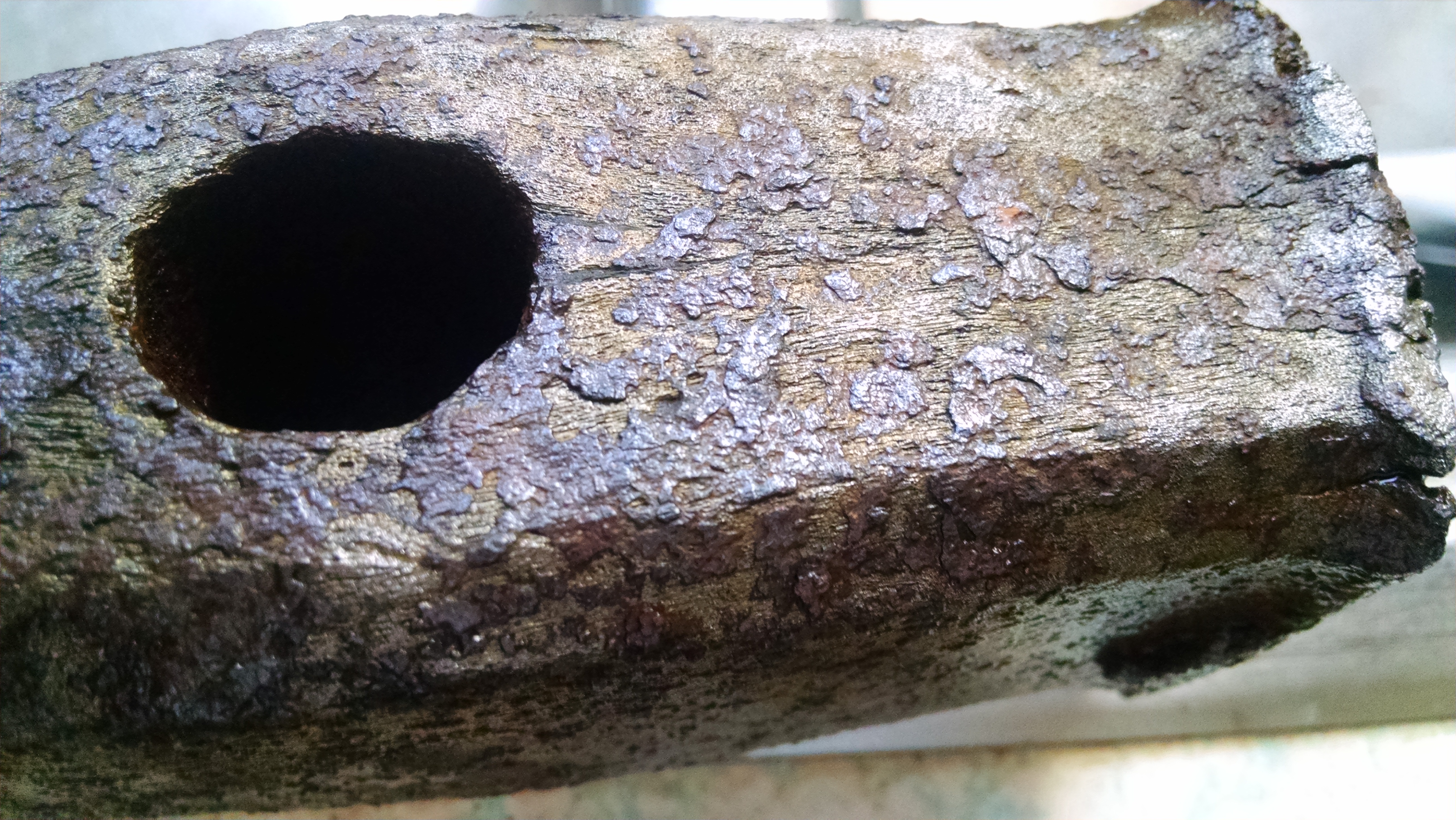

The big stuff will probably end up as small anvils / swages or similar. The caulking chisels I will clean and dress then put them back into use while the spanners I will keep and put by for a rainy day.
An over night soak in diluted to 30% +/- phosphoric acid or Naval Jelly diluted about 50% will do wonders converting the rust scale back to iron as it was when it was left to rust. Electrolysis will do the same thing without the chemicals, a little baking soda and battery charger.
When you're finished with one of the phosphoric acid treatments rinse in clear water, neutralize with baking soda, rinse, dry and oil or it'll rust again almost instantly..
This is how they treat silver and other metals recovered from ship wrecks that have corroded into lumps of oxides holding sand together. The results are amazingly perfect restoration.
Thanks for that, Frosty; definitely will next time. For now, I'm just going to clean this up a bit more with the vinegar and hang onto it. Might split it for other uses (san mai, maybe?), might trade it for something else.
