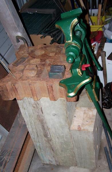

I don't have a picture of IT specifically but there are a couple. The first is about as good as I have of the face. The 312 is stamped in, I rubbed it with soap stone to make it stand out. I think it's about right for the weight but have never weighed it. The round holes are round, they only look oval because of the angle.
The second pic shows it on it's stand, I was taking a pic of the leg vise right after it's paint job so it doesn't show the stand too clearly. I made the stand from wooden guardrail posts, we were in the process of replacing them with steel posts so I brought some nicer ones home. The block rests on edge on the lower shelf. It doesn't show but the lower shelf is slanted back slightly so the block always leans into the stand. I have a keeper that passes through a hole in the block and spikes into the higher part of the stand in case I'm going to be doing heavy work on it.
What I use it for mostly is bending forks and other torquey activities. It's pretty easy to spin my anvils bending or twisting, etc. but you need power tools or serious leverage to make all that end grain wood spin under that block.
