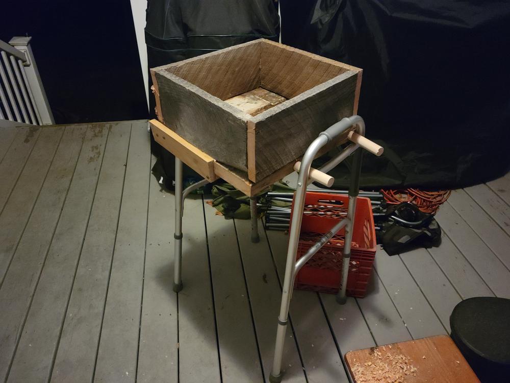

On another note, when I fill my Jbod forge with the actual dirt/sand/ash mix, should I fire it to cure or will it be ready as soon as the hole is in it?
It'll be ready to go as soon as it's filled. It's not a refractory like Kastolite that needs to cure or anything.
My thought process is to fill it a few inches, put the pipe in for the air intake, put a circular object inside to pour dirt around and pack it and remove the object to make the hole, does this sound right or should I just dig the hole after the fact?
Packing the dirt around a removable core is a good idea. A tin can works nicely.
Cool, I have a ton of those
Continuing on the steps, I gave my forge legs today, I used a Walker I had in my shed and secured it with poplar dowel rods (in case I need the walker later I didn't want to make it permanent, never know)
Now there's a neat stand. As long as it holds up to the weight, and it probably will, it'll be fine.
It's weight rated for 350 pounds, so I'm hoping lol, it's the 1 inch dowels that I'm concerned about. But their stuck in about an inch and I put gorilla glue in the holes so let's see when I fill the box
If you have trouble breaking the dowels make the next JABOD so it JUST fits in the walker. That way you can hang it from a simple ledger or angle iron.
Yes, compact the soil around a core to make the trench, pot, bowel, pit, whatever. Once you establish what works for what you have in mind doing, you can remake it every time if you wish or need.
