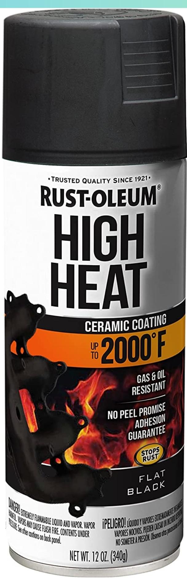

July 15, 20233 yr On 7/13/2023 at 10:08 AM, Demne said: There might be a smell coming out of the paint of the furnace - they can only withstand 650 C (1200 F) (they are the highest temperature-ranked paint we could find), Just an fyi for anyone actually interested, you can buy a ceramic paint good to 2000f..cost about $10 online and $15 in the big box store sold by Rust-oleum. Just used some on my muffler rebuild for my lawn tractor. Just needs a few heat cycles to process properly, which would add cost. I cycle mine in a convection oven I keep outside 30 min at 200, 30 min rest. 400, 600. Then a cycling process in installed heat, but for a forge body, I would just let it run normally to finalize the cure.
